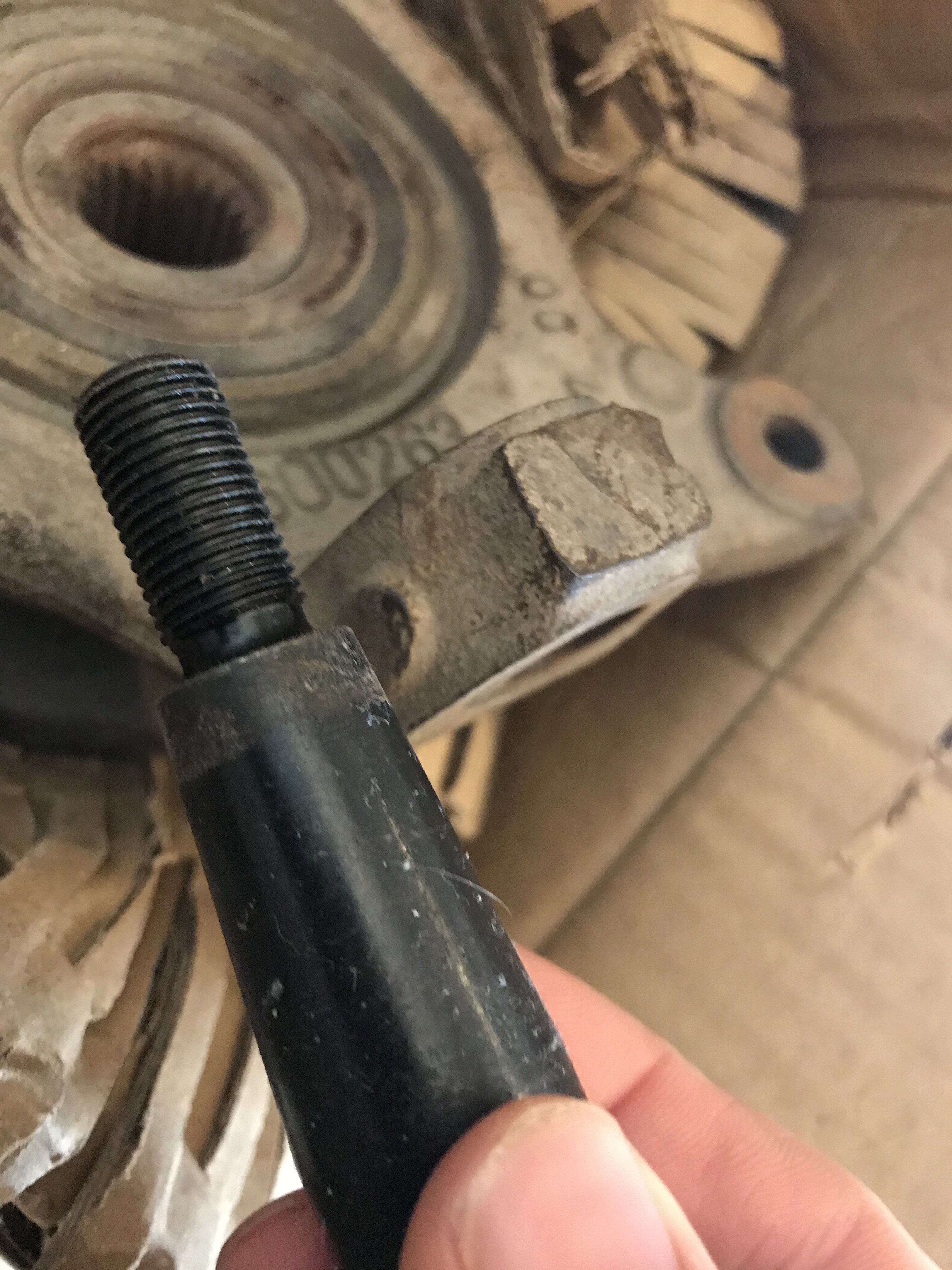

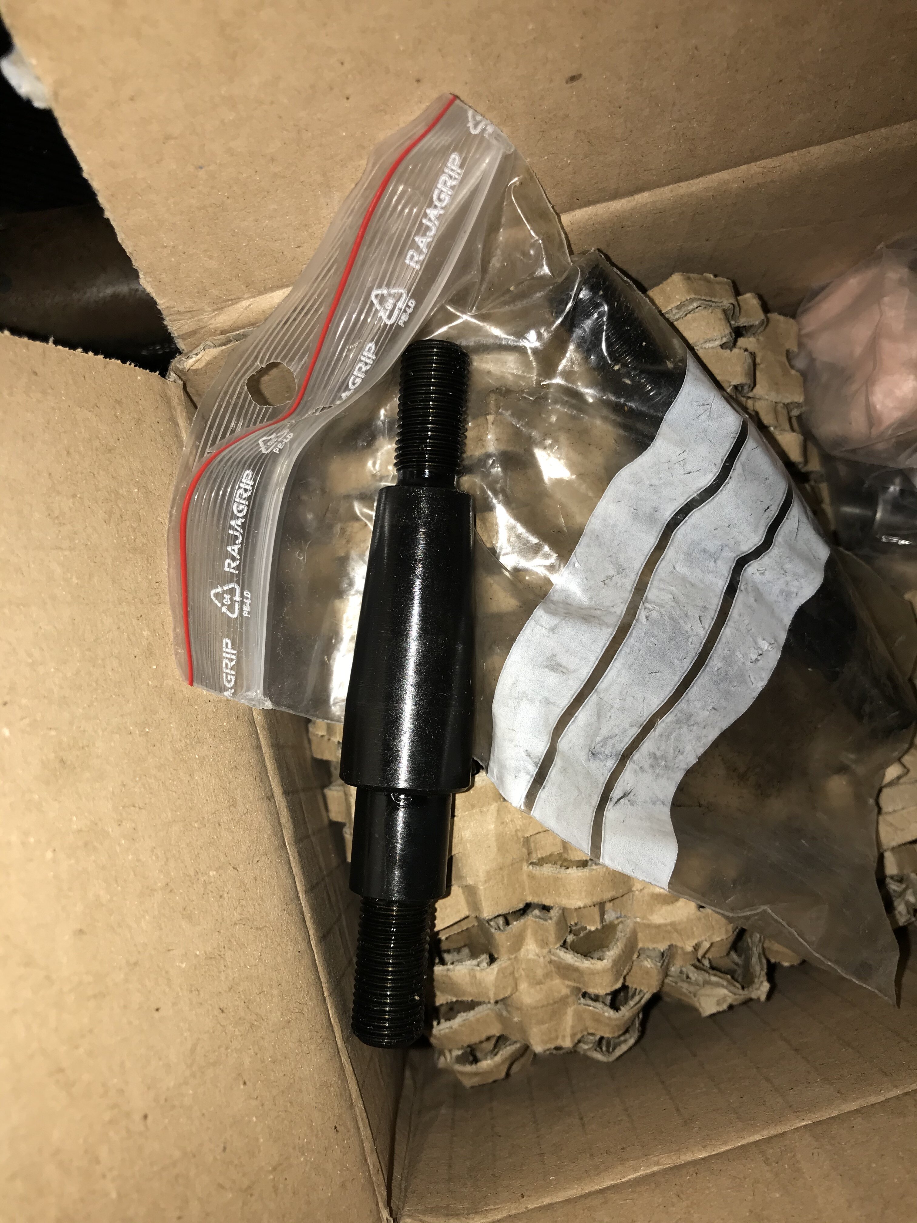

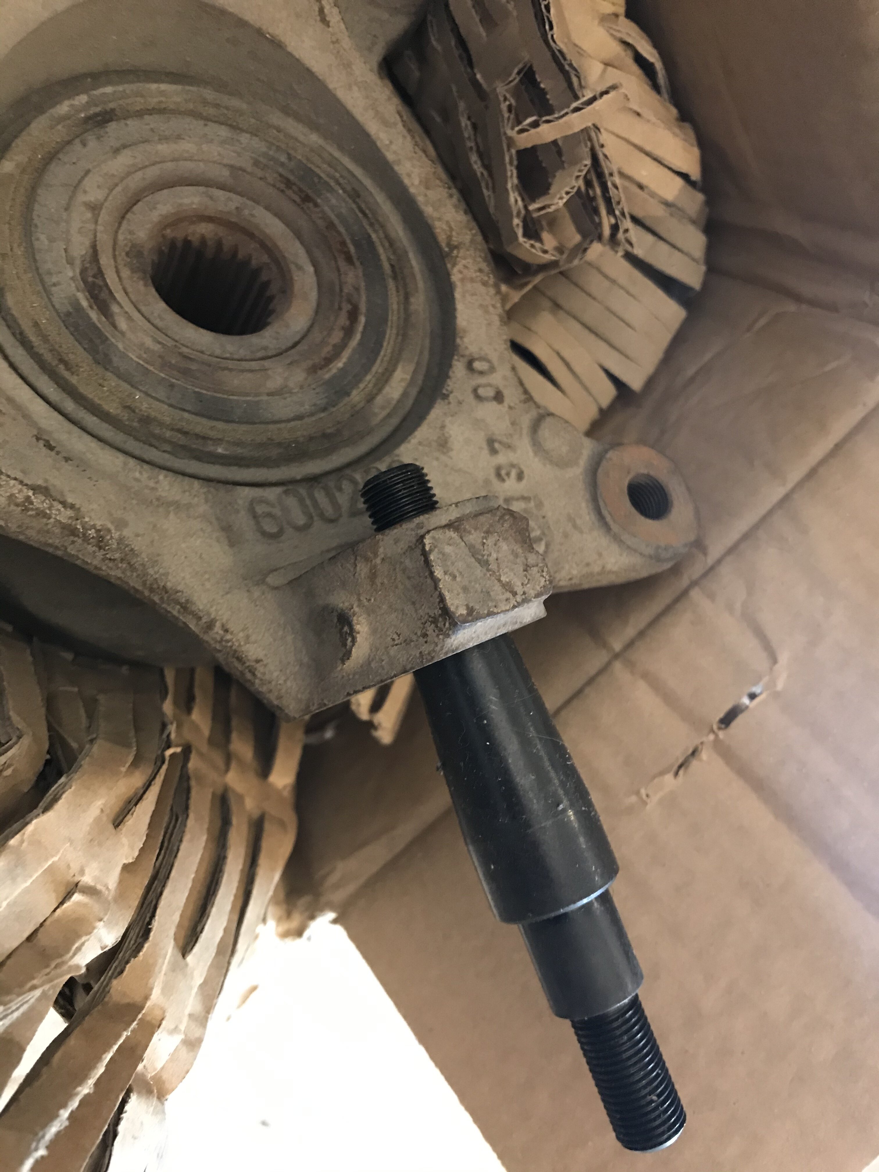

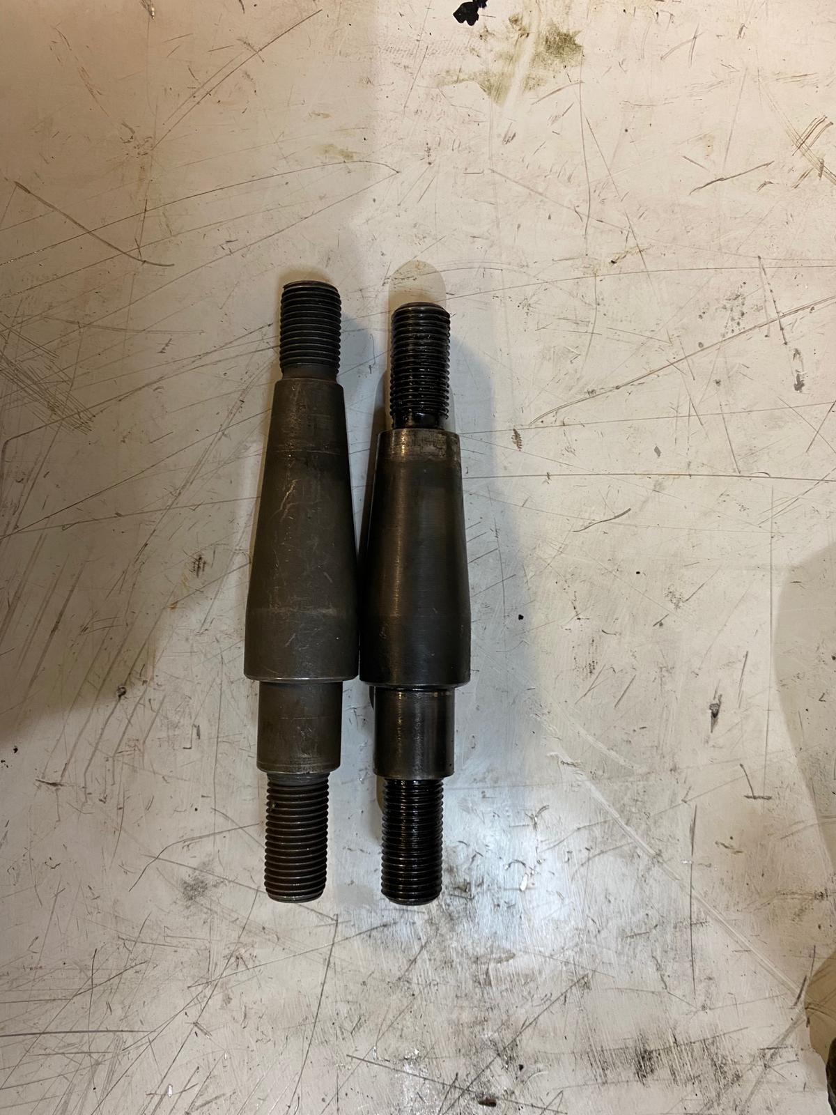

Do not order the hub pins from Optimiz
They are wrong!! They are remade but they’ve copied the pin incorrectly
Optimiz pin is on the right. It doesn’t fit the hub properly. I’ll find the video now

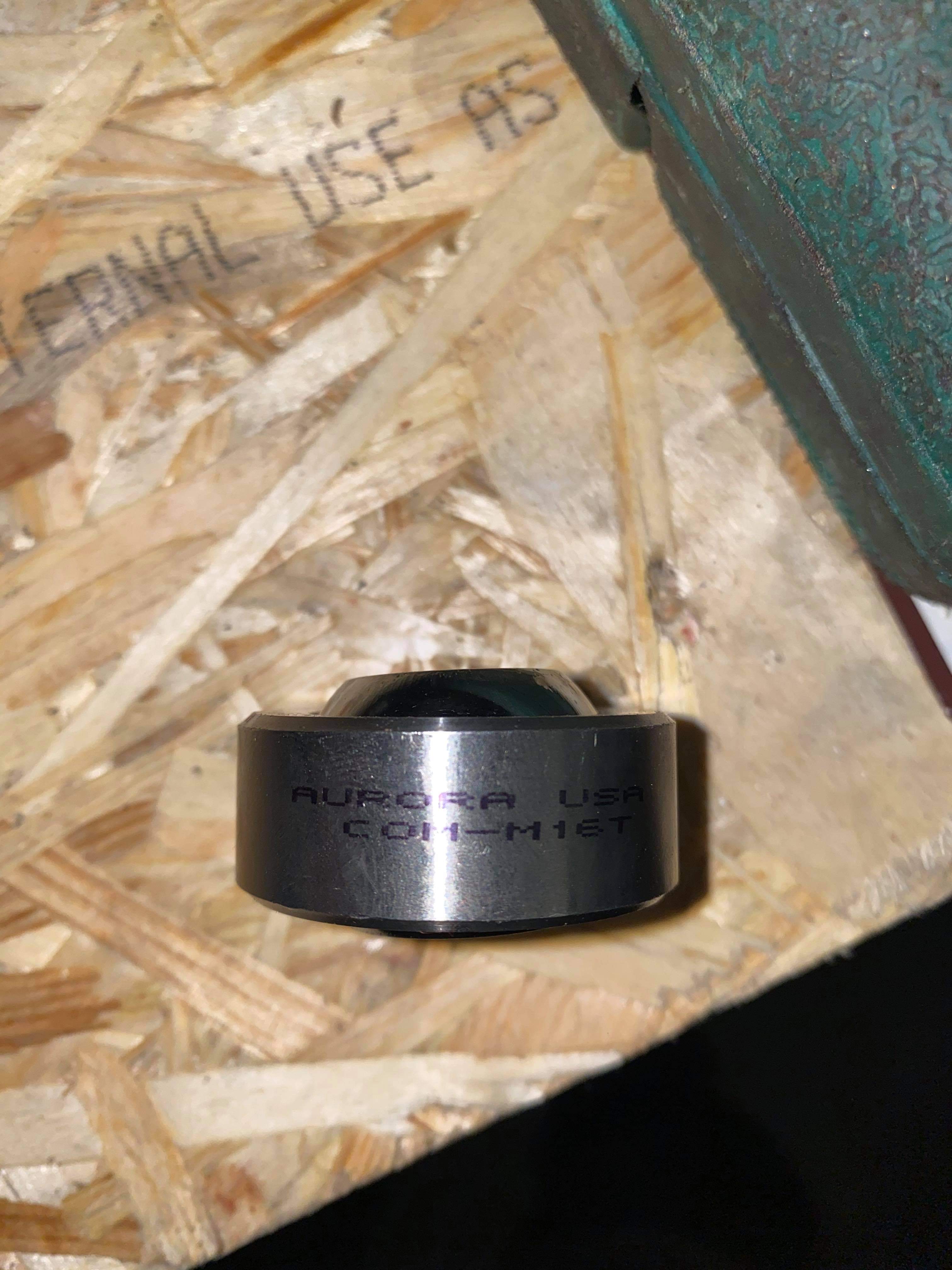

With bearings it’s either the optimaz uniball
Or from abc bearings
GXOW16.38MS
Or the AURORA bearing posted below
all around £40 each
Uh oh.. thanks for letting me know mate, my hubs haven’t arrived yet (across the channel jobbie) but mine look exactly the same as the wrong ones anyway.
Would they offer a refund? Annoying as I paid import tax and fedex wanted an extra fee too!
Where did you get the correct ones?
They didn’t want to know mate. I even sent them that video and they blamed the hub but I have 6 of these cup racer hubs and it was the same in each one

No good.. Perhaps If I get my bank to sort it out, Ill save these for someone to machine down and have 2 different lengths if I want to play around with the geometry
