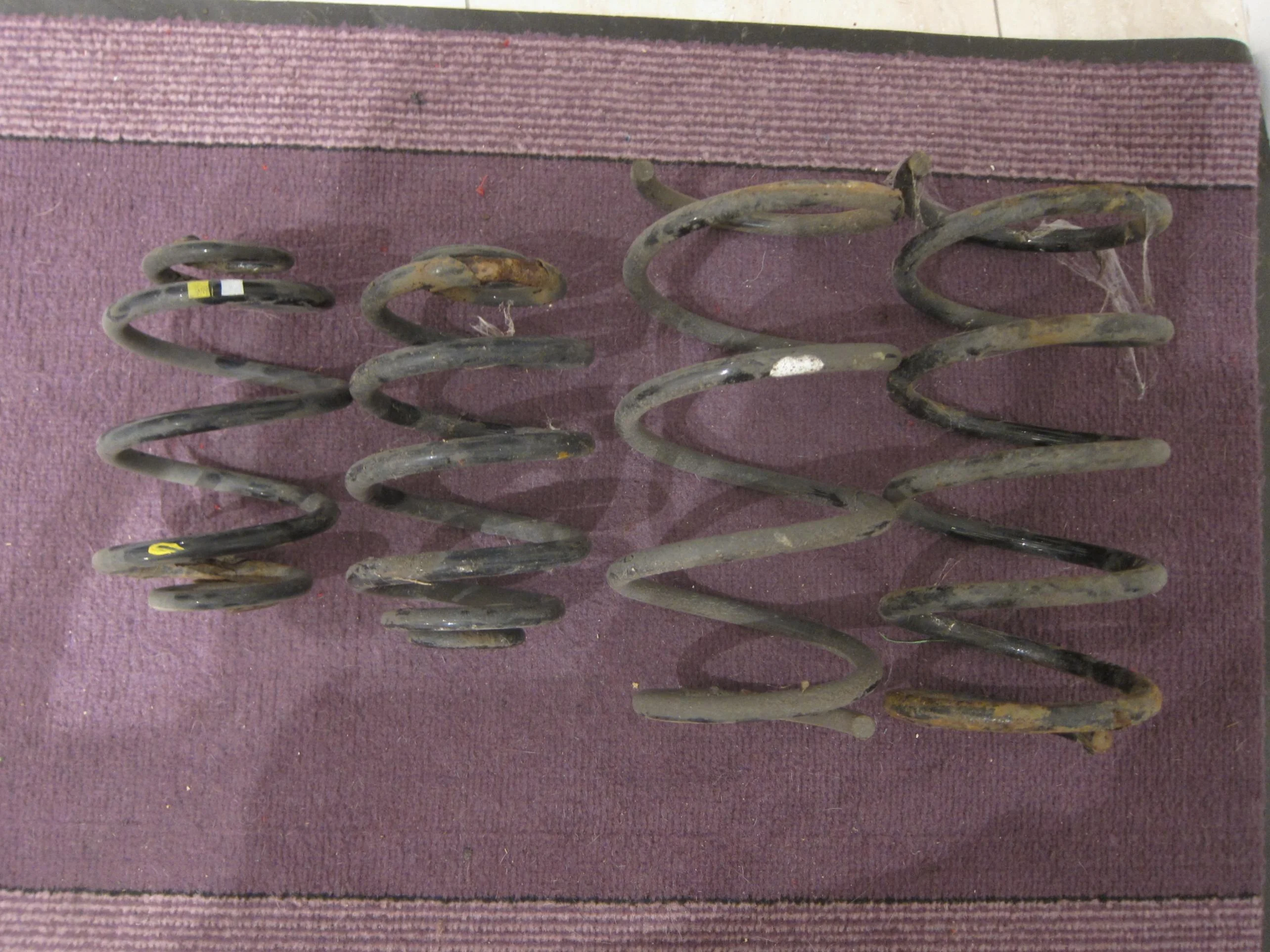

Here are std cup springs next to non cup springs. The rear is a lot shorter, but the front looks almost the same.
I have replaced my cup springs with eibach sportlines and the rear is the same height, but the front is now lower.

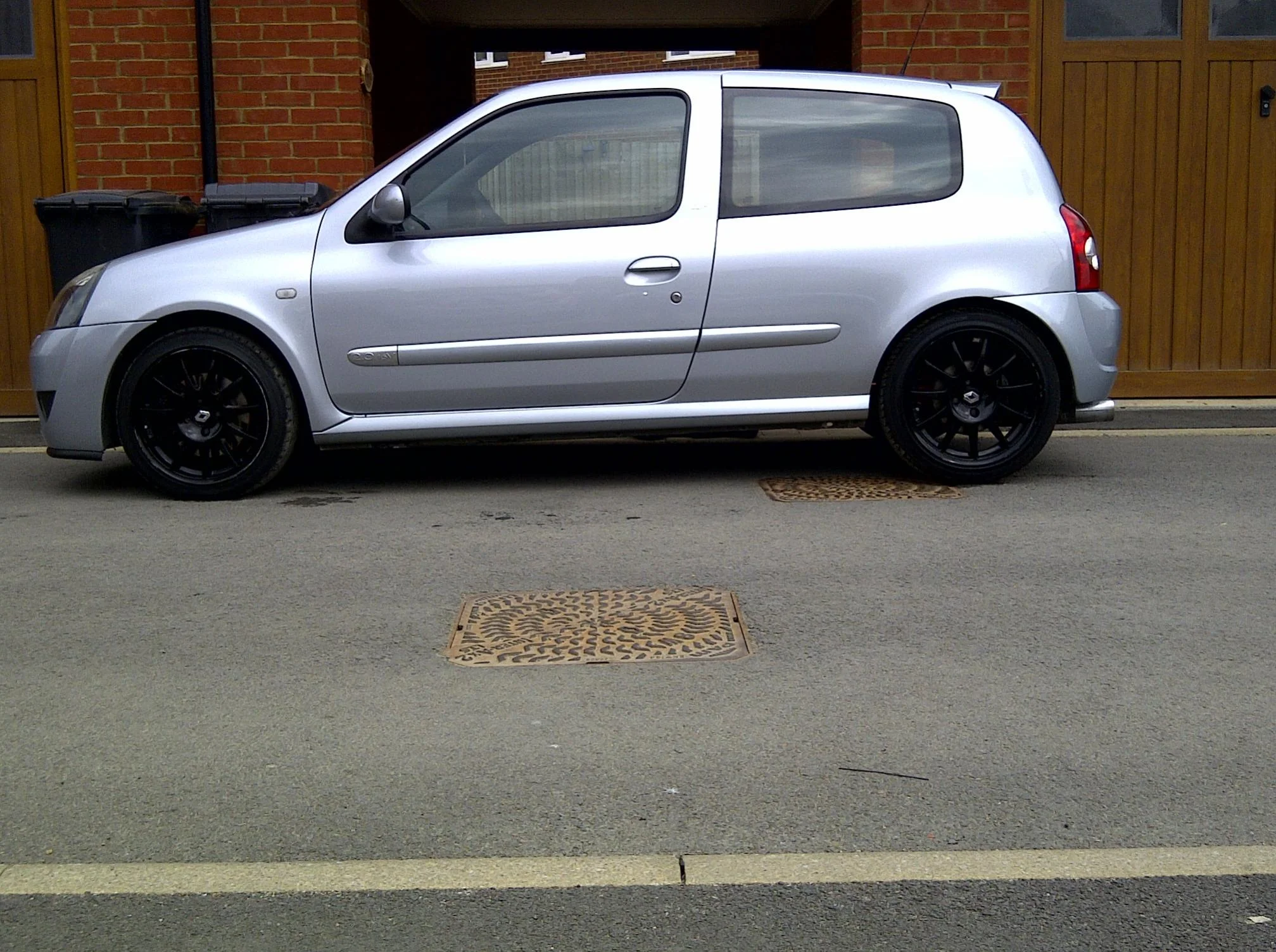

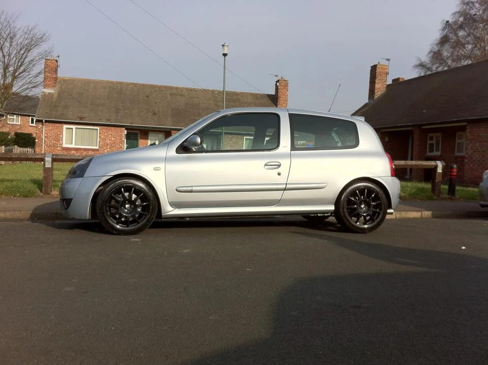

no real weight in the back so it doesn't really lower it here's a pic of my cup on sportlines
