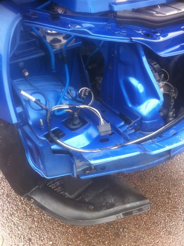

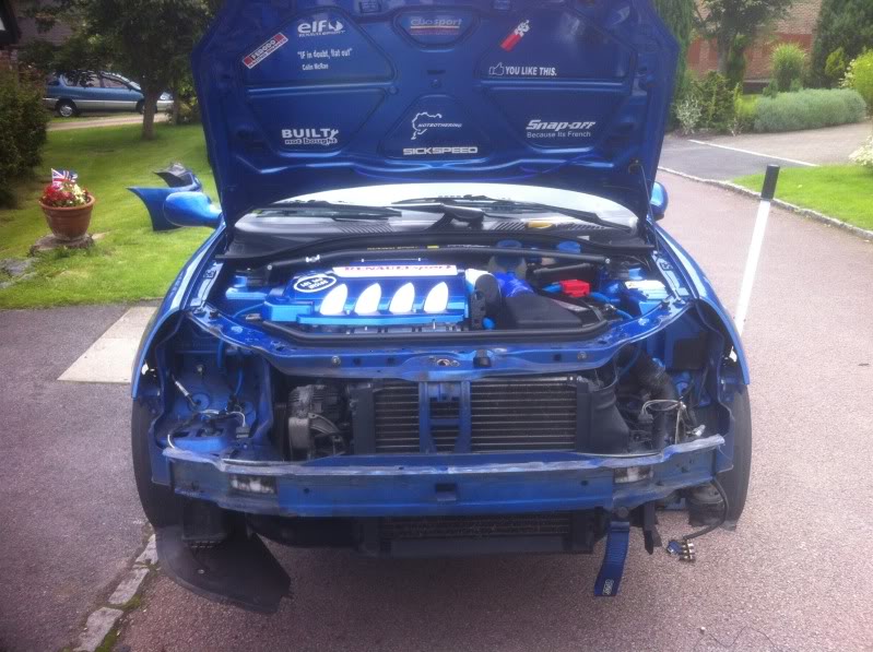

Not too much hassle. Bumper off, 3 bolts for each light.
As long as the lights have ballasts and igniters its plug and play.

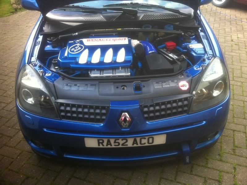

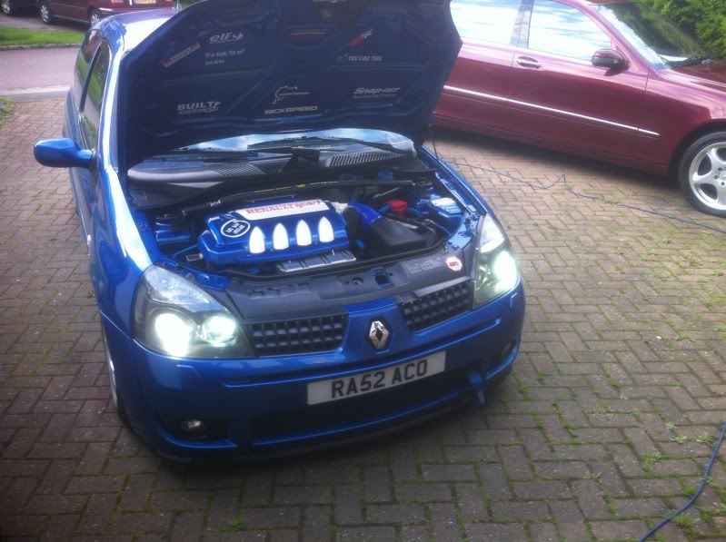

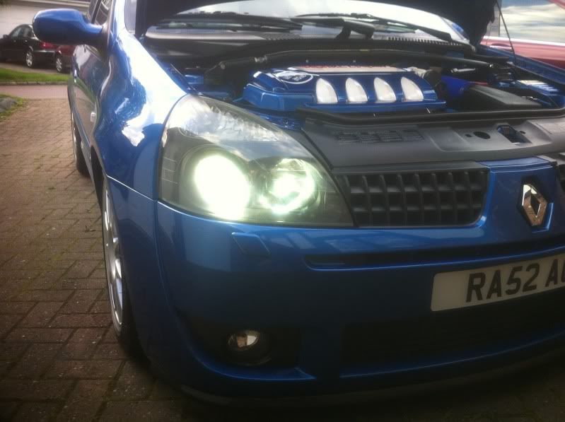

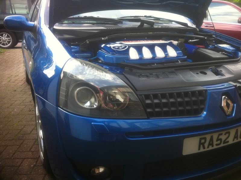

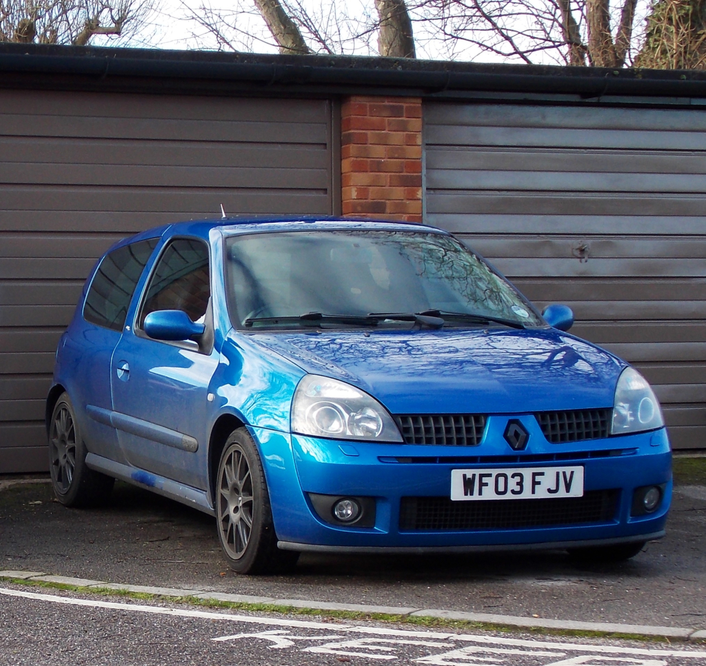

Only one of mine I have with the xenons in

Swap the adjusters over and plug in.
Also manually adjust the headlamps so you're not blinding peeps. ;)

Cheers Emma, that looks pretty good actually!

Piece of piss to swap the headlights Danny. I fitted them to my trophy in about half an hour. Fitted Marc R ones not that long ago too. Hardest part is getting the bumper off and even that's a doddle.
Gally
Cup's with xenon's please.
Indeed. Easier bumper to whip off.
