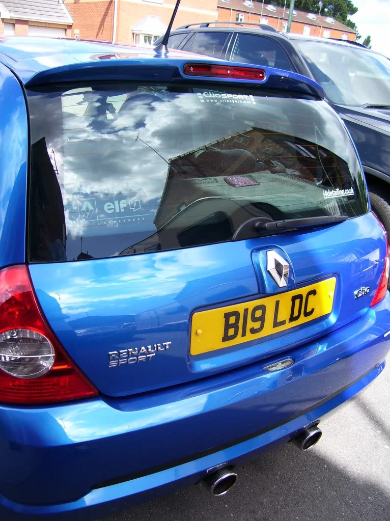

Mine with Poorboys black hole topped with Swissvax Onyx: (out of the sunlight :()
