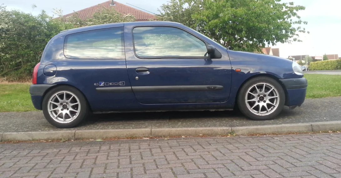

I recently installed aftermarket FK 60/40 lowering springs with upgraded shocks but the front isn't as low as i would like it to be. I was wondering if i should cut the front springs a little to get it slightly lower at the front? I'm thinking an inch off the coil or something? I would want it maybe 10-15mm lower at the front. Any suggestions/opinion/experience over this? I have upgraded shocks so shouldn't be too much of a problem to cut a little off imo, but anyone that knows better's advice would be appreciated.
How the car sits when i put the springs and shocks in, they haven't bedded in yet but don't think they will drop much

OP, give it a few weeks of driving like that. You're a lot lower now so will feel the road/speed bumps etc a lot more. You may not want it any lower.

By lopping a coil out, the spring rate doesn't change, it just gets shorter, so you end up with the same resistance rate but a shorter distance so the car will be bouncy and crashy. Your car looks fine as it is...although it needs a full on paint correction and some tyre shine on those balloons! haha. :rasp:
