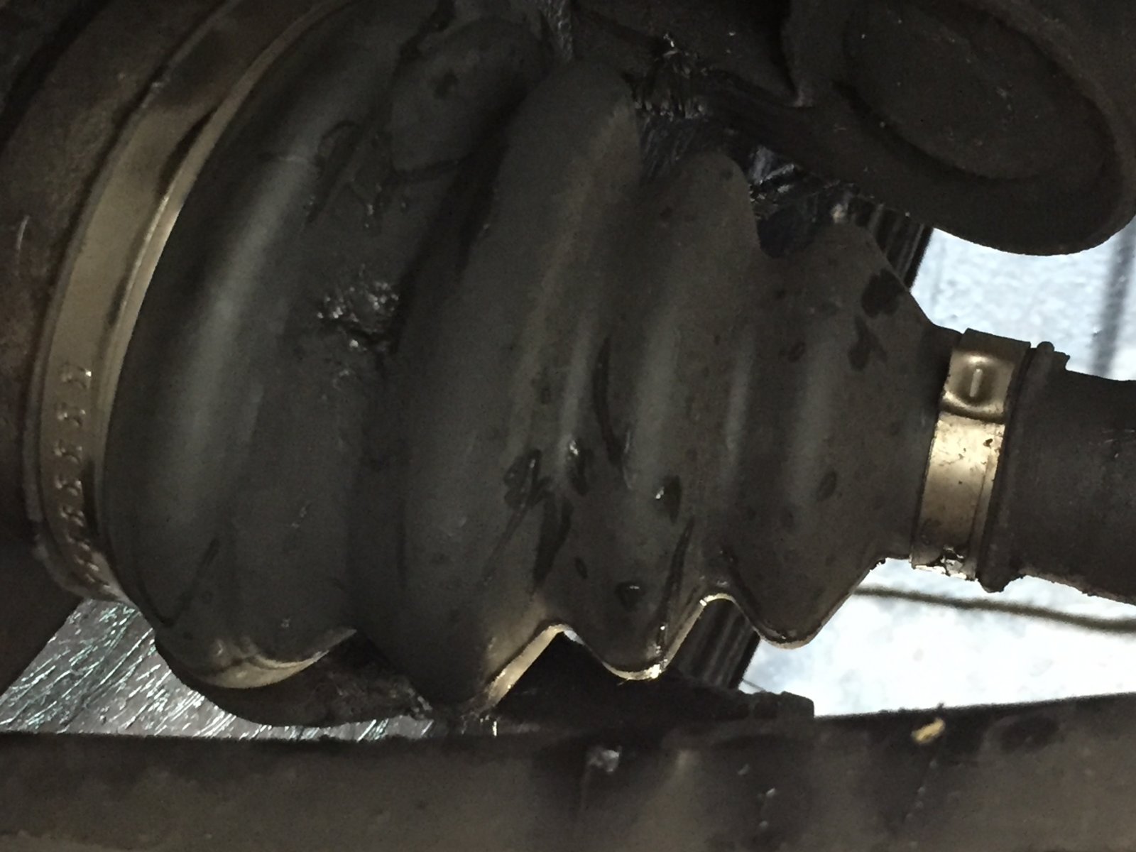

I replaced my drivers side cv boot back few months ago and last week notched that it had a small hole in the rubber and grease had escaped so I had that replaced on Saturday, the rubber looked to be worn and perished I thought I'd may of been down to the rolling road for remapping last week, got home tonight and same thing cv boot is knocked with a hole in the rubber! It doesn't looked to be catching on anything?

odd one. trying to think what would cause it other than the quality of the boot.
Not sure if that`s an entry or exit wound,or which side shaft it is.
Start again with a Shaftec or J&R shaft with 24 month warranty.
imprezaworks will keep us up to date on the J&R,and I`m 11 month`s,10k into a Shaftec item with no problems.
Picture is on the drivers shaft, where did you purchase your shafts from?
Picture is on the drivers shaft, where did you purchase your shaft from?

My advice was buy a shaft with a 2 year warranty.If you just replace the boot & it goes again,tough.
Are they cleaning it out before fitting a new boot? Might be something inside trying to work its way out ie bit of sharp metal or whatever.

PS:check your bottom ball joint & engine mount for movement.Play could cause the shaft to bind when cornering.
