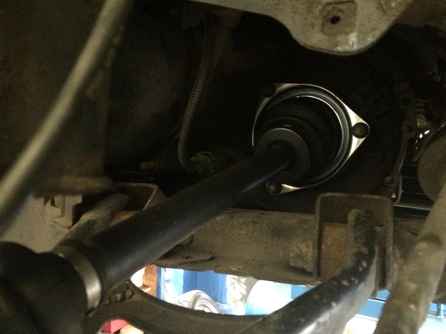

cv boot won't marry up up to gearbox flange?
  PB 172 phase 2
Replaced both driveshafts today, problem is- N/S driveshaft cv boot doesn't marry up to the flange? I done everything correctly- torqued etc- poured the 1st Ltr of gearbox oil in and it immediately started dripping, 20 minutes later and the gearbox is empty.
I know I have to take it apart again to put it back together but do I need a sealant of some kind where the gearbox meets the flange????
Its on the street now on a single yellow line-monday tmrw!!! for feck sake. Will I harm the gearbox if I push it up the street into a designated parking space with no gearbox oil in it?

They can be a bit fiddly to get the boot in dead on. Did you have the outer cv in the hub at the time?
  PB 172 phase 2
Yes I put it in the hub first because I didn't want it resting on the wishbone bolt- Good chance it could split it while I was trying to get it sitting right. Gonna take it apart tomorrow and see if I can get it seated correctly, no other choice now the gearbox won't hold any oil.
I really really really do hate the design, but as above, fitting the shaft in first and making sure everything is clean and not stressed is the key.
I nearly stripped the threads on the gearbox the first time trying to tighten the plate without noticing it wasn't sat correctly! Idiot!

Sorted it
  PB 172 phase 2
Thanks to all that replied, it was a morale boost after the trouble with it of late.(Ive stupidly grown attached to an old car)
Had the car on axle stands at dawn- took it all apart and re-assembled it, sorting diff end first. then replaced the hub carrier with one from renparts complete with ball joint and an ABS sensor on it. I ended up using the original flange plate from original shaft and it seems to have done the job, I used the original because I thought it might be the new J&R plate that came with the shaft that was the prob but it wasn't (I just didn't have it sitting correctly, rushed it first time towards the end due to nightfall coming and only an Iphone torch to hand...)
Wish I used the new plate now due to it being visibly a mm or two wider all round. Put 3 Ltrs in and it seems to be holding. will check for any leaks in the morn before work.
I bit the bullet and gave it test drive tonight up to the local petrol station and it feels noticeably smoother...less play in the steering wheel? also seems a little louder but then that might be because I had it off the road long enough that I forgot how it sounds...

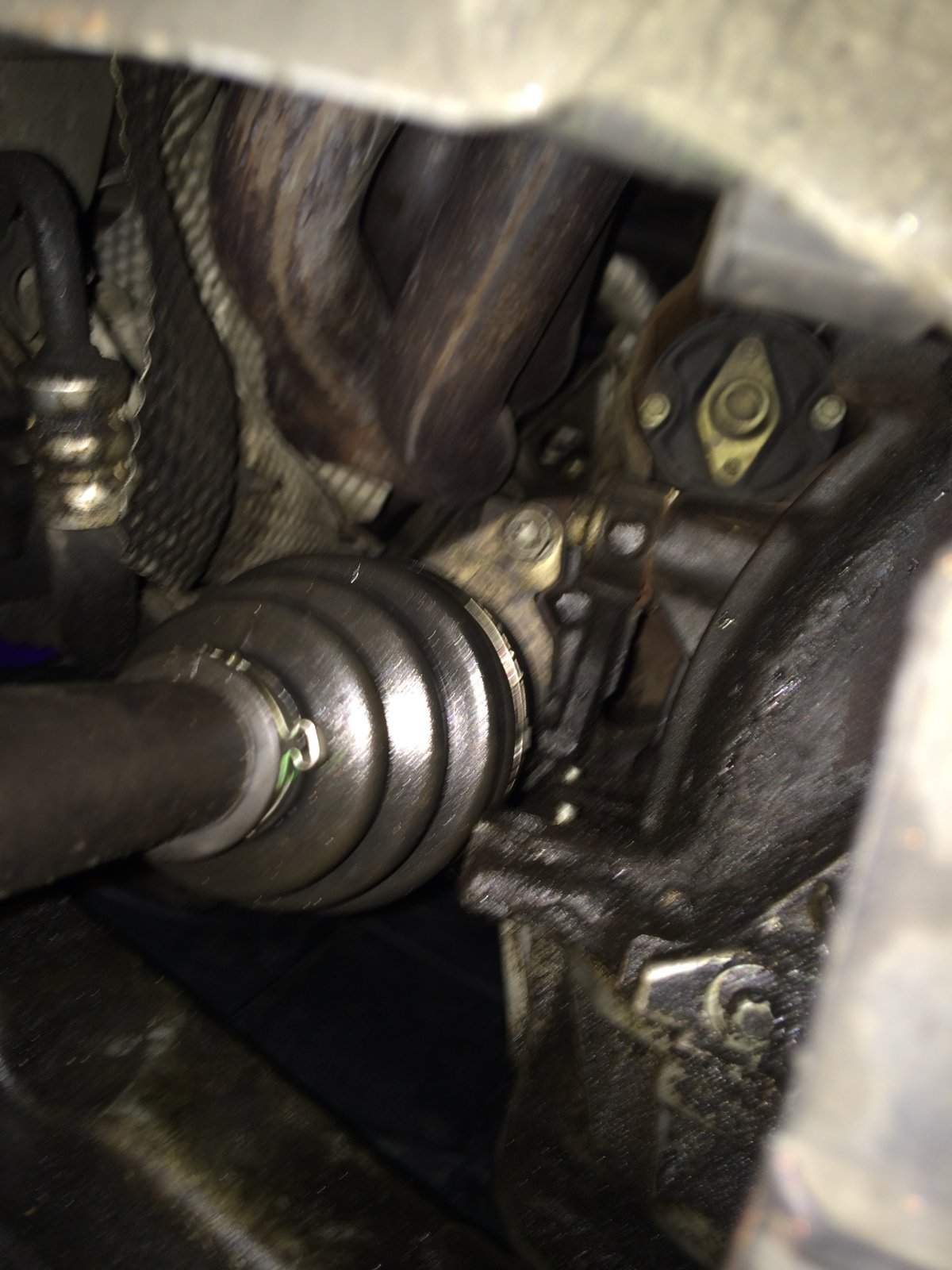

inner boot on o/s just touches the block and I reckon thats how come the last one burst eventually.
decided I'm gonna refurb the original driveshafts and either keep em' just in case or sell em' on ere'
:confounded: That's not a good thing to hear about the O/S shaft, that was the original complaint about them hitting the block. Is it the boot or the clip? Regardless thats put me right off now.

The boots they use are the wrong size ,they just universal ones ,they flop around couple of weeks it wil split .
  PB 172 phase 2
I believe it - don't suppose you have a part number for proper boot? I will put that on the one I have sitting around to replace with when it does bust its contents. Never fecking ending. I should kept the campus 1.2 it never gave me a problem in year i had it.
i thought previously that if i power flex the dogbone mount then maybe that will keep the boot just shy of the block due to the power flex helping to hold the block in position better than the original bushes but no, the fault lies in the CV boot design
You can have a dogbone mount made of solid metal, it makes no difference because the driveshaft is fitted to the engine so will move at the same amount it does.

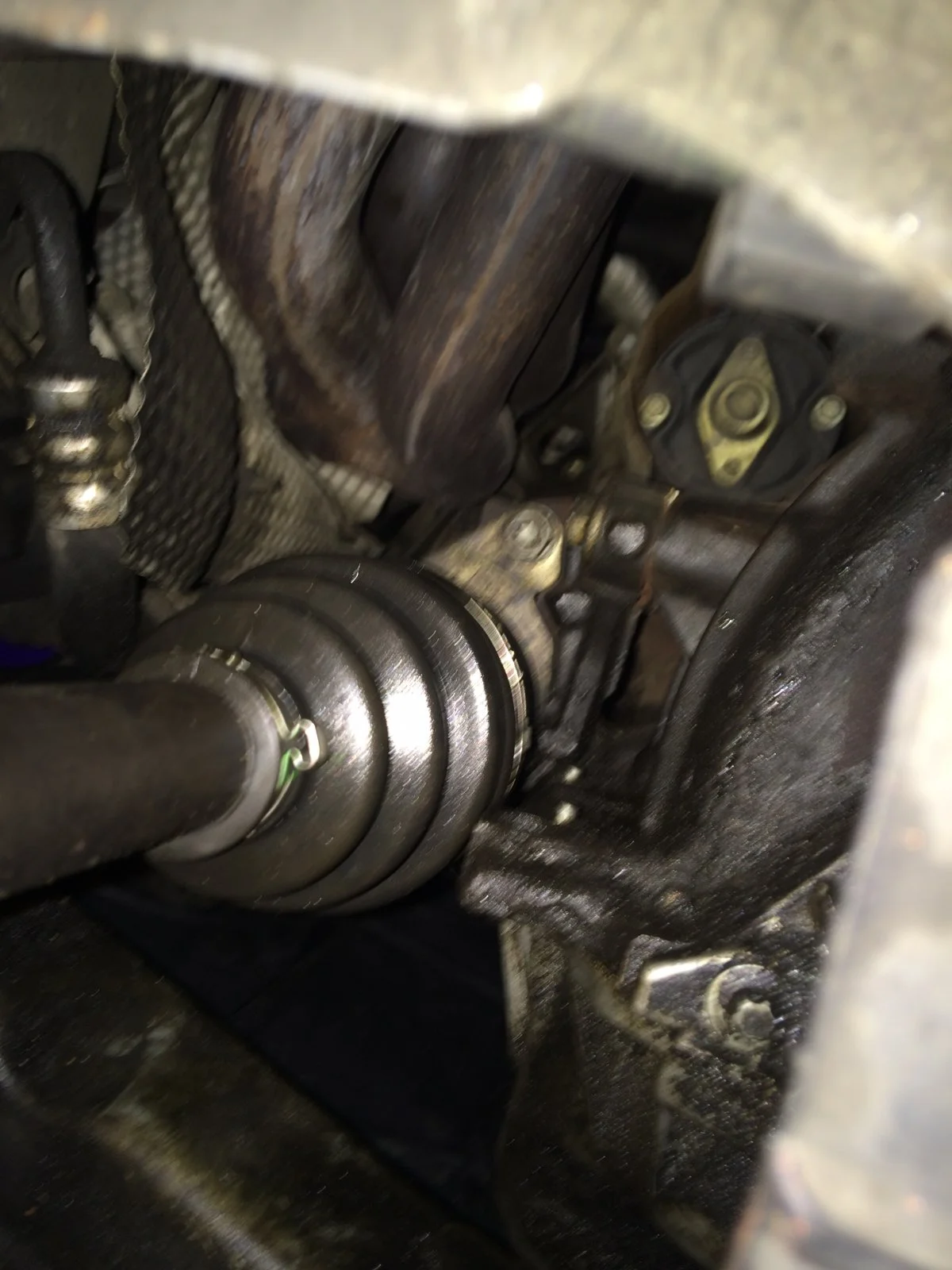

From whats going on here and other threads, the N/S seems to be sorted :up:
But the O/S seems to be still causing issues with the inner boot. The boot on my OE shaft is immaculate, shame I cant swap it!
