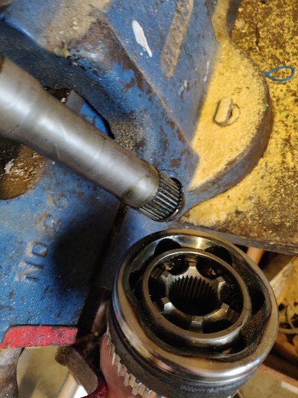

Faffed about with the stretchy boot today, lubing it and the cone all up, then the bleddy thing split when stretching it over. [emoji849]
Thinking screw it, I'll probably just get a new shaft anyway, I decided to give knocking the CV off a go. Easiest thing ever, took about 30 seconds with a medium hammer. Gave it some taps straight on the metal of the inner race and it started moving straight away.
For those trying to figure it out like I was - the 182 cv's don't have a clip you pry apart, just tap it off. Looks like on installation the clip will go off the end of the splines in the CV and expand, locking the lot in to place.
For those trying to figure it out like I was - the 182 cv's don't have a clip you pry apart, just tap it off. Looks like on installation the clip will go off the end of the splines in the CV and expand, locking the lot in to place.View attachment 1488357

Exact same setup as most of CV joints then.
God knows where the rhumors that they aren't rebuildable came from. Unless its just the fact the a new joint is hard to come by.
I replaced the outer CV on my civic with a shaftec CV joint, same method as above with the circlip and it's still going strong a year later.
Might be worth seeing if they can supply the part for the clio
Yep no trouble at all. Did see one poster found a source for CV's a few years ago but the supplier doesn't seem to exist anymore.
Would be interesting to strip down a shaftec or j&r shaft and see how similar their parts are to the OE ones.
