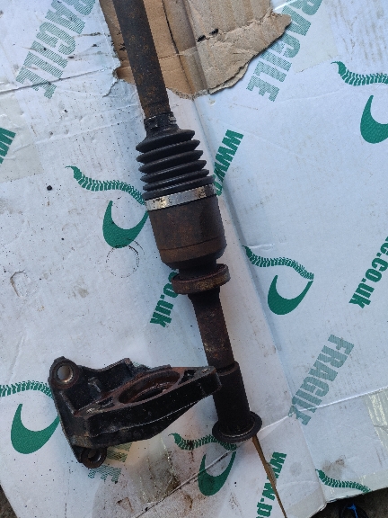

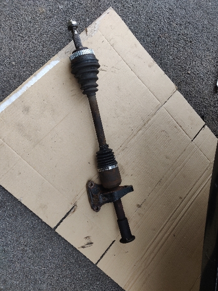

Decided to give it a go anyway. It was tight and required a couple light taps with the hammer, but it came off, an no oil in my face. Result.
I'd ideally like to sort it out so I could reinstall properly, but as I don't really know how it's supposed to disassemble I'm not sure where it's seized.
Is the long portion of shaft supposed to pull off and the short section remains in the bearing? Is the bearing supposed to come out of the block and the whole shaft removes as one with bearing on the shaft?
If anyone has a useful pic or diagram that'd be much appreciated. [emoji106]
Sent from my ONEPLUS A6003 using Tapatalk
Sorted.
Incase anyone with the same problem stumbles across this - remove the whole bearing carrier from the block as I did above, then with the shaft out, stand it on the gearbox end and give the bearing carrier some taps with a hammer on two opposite sides.
