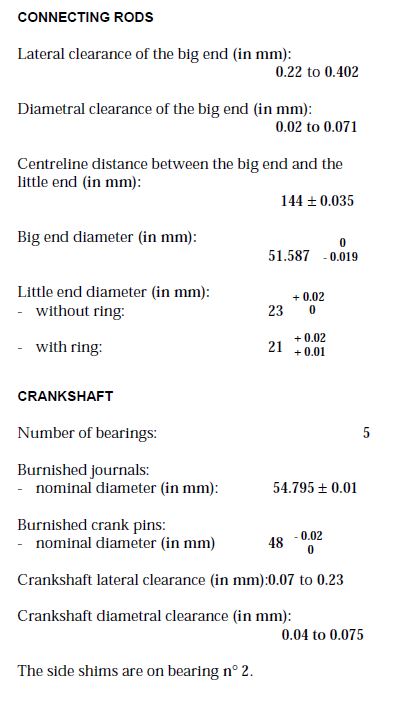

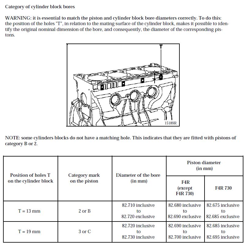

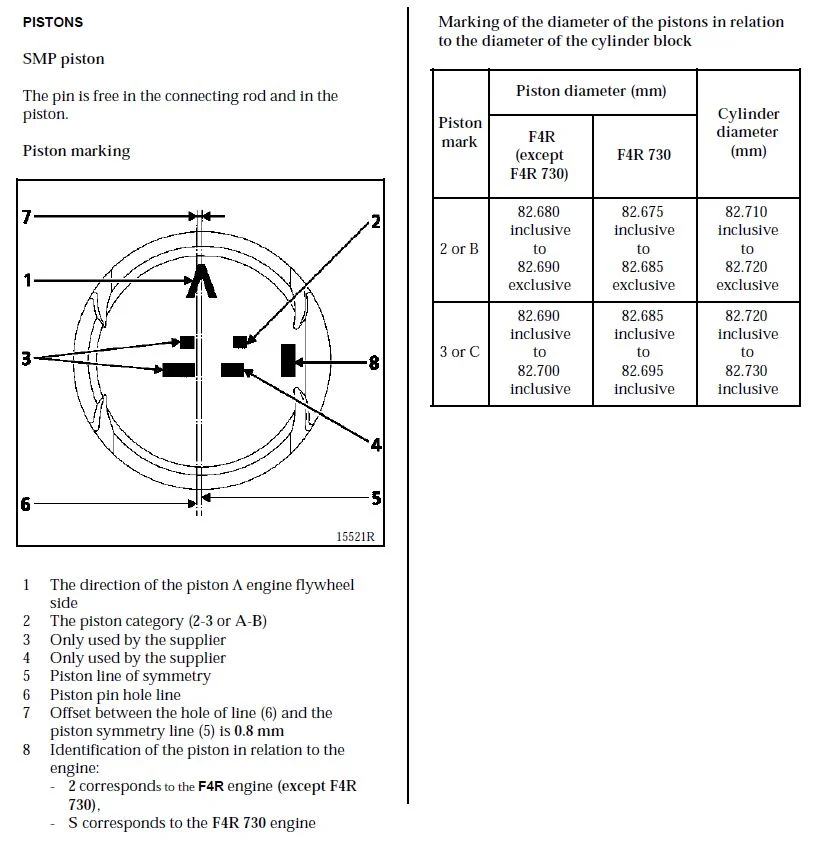

Hi can anyone tell me the piston to cylinder clearence and exactly where to measure on the piston please I cant find any info anywhere tia

Loss of compression causing a poor idle and black smoke but runs ok when driving, leak down test showed leak to be coming from the breather which connects to the air pipe to the throttle body. So the leak is pistons, rings or block ordered new rings and honed the block just need to check pistons are not worn to go be causing this
