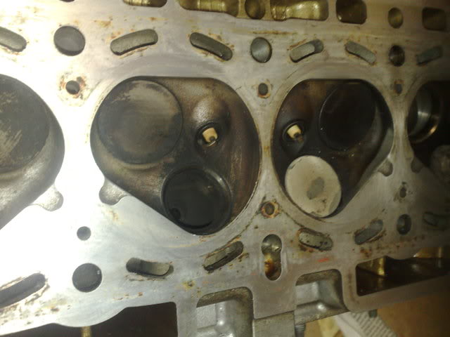

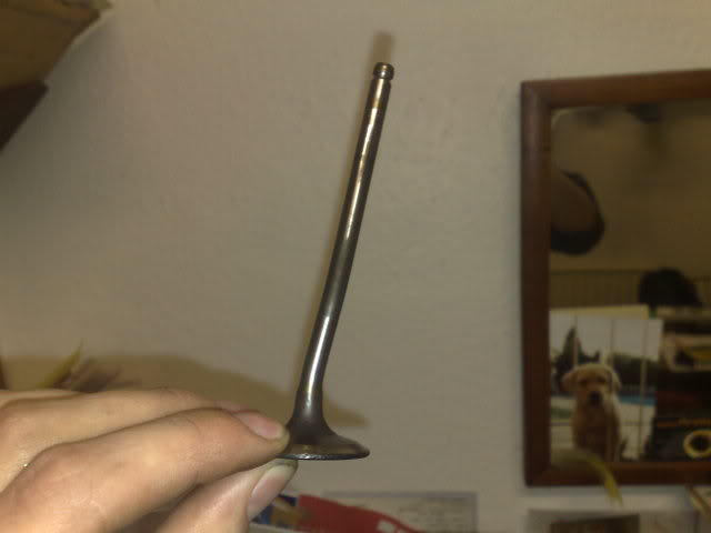

i have finally got my cylinder head off and i want to ask a few questions before i carry on working.
now there obviously is oil. do i clean all the oil out?
basically i need to see if any off the valvles are bent can someone give me a step by step in detail of what to do..

works for me. to check the valves youd be best removing them, to do this, remove the rocker shaft, and then compress the valve springs, remove the retainers (2 halfs) and then let pressure of spring, valve comes out the other side.

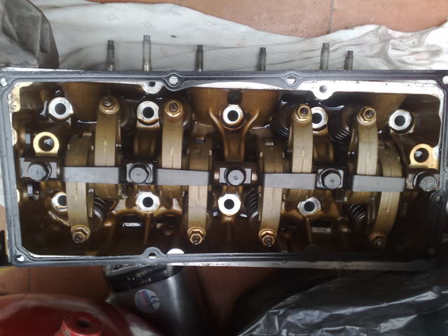

ok more progress... taking ages because i finally got a job :P... lol
i think this might be wrong?? lol
how do i remove all this stuff on head without damaging it...??
and how do i clean away the carbon?
