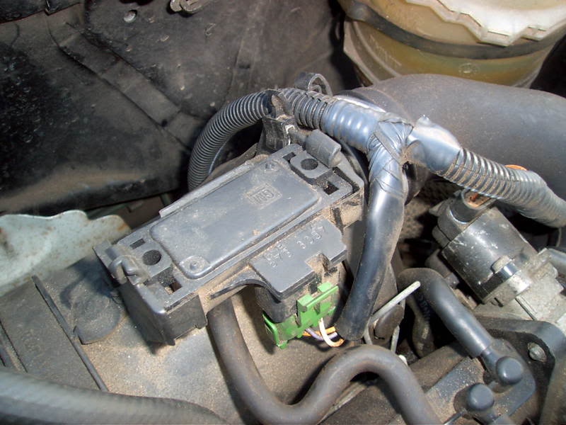

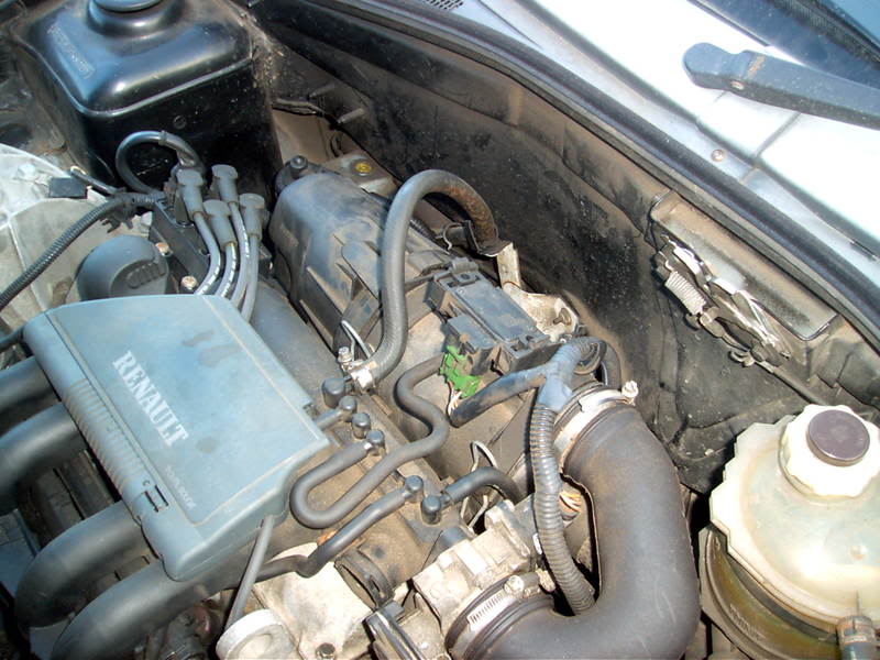

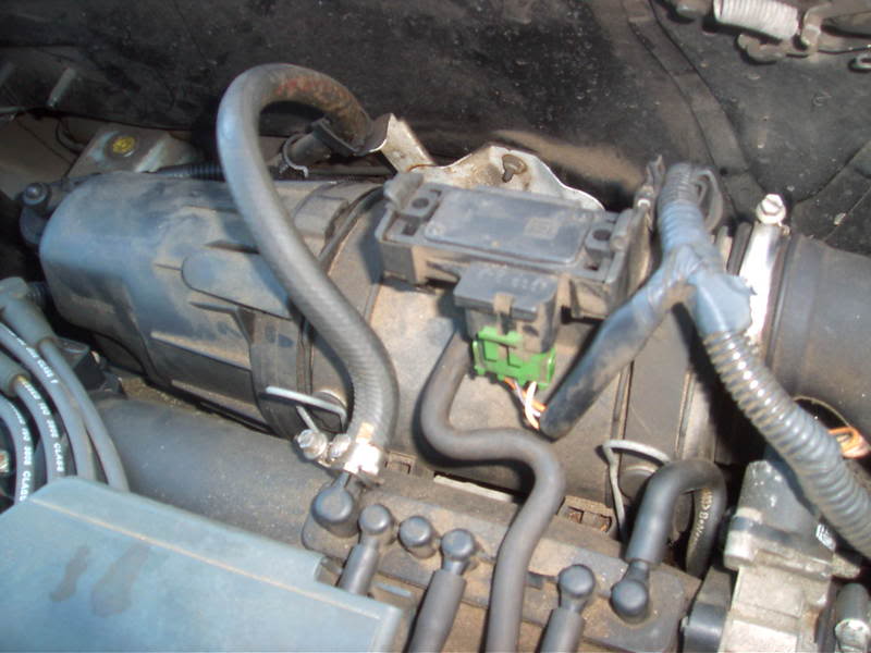

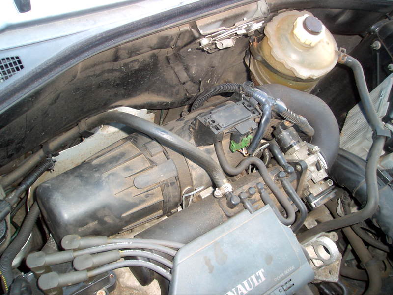

work out how to do it without cutting wires. Post some clear picks if you really want help
Here's some picture's I've took earler :P
Hope This Helps.....Thanks Very Much
That looks identical to my mk2 phase1. the wires are needed. the block doesnt need to stay on the inlet box thing which the air filter is inside of.
I've been trying to drive about without the wires connected.....Could anyone tell me what the wires are auctal for and are they a must on the car?
Is it possible to leave the wires connected to that little black thingy, and just put it somewhere else out of sight lol :P
Thanks
Be for air metering, there either the MAP or MAF sensors (not sure which the D7F uses off the top of my head). You want it connected or it'll do silly mpg due to not know the air quantity going into the engine.
