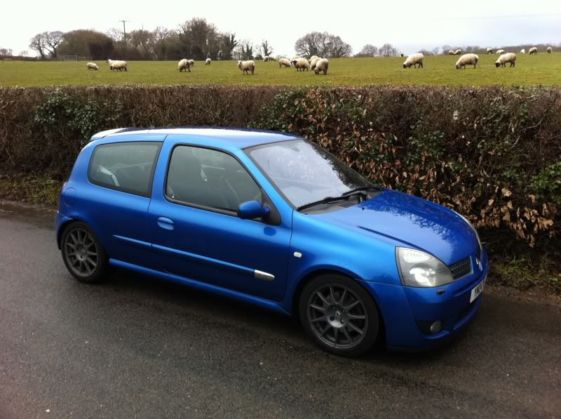

My tyres are 205/45/16, and I have no idea how low in mm it is. Here is a picture though:
It's not that low in my opinion!
no its not that low, i wouldt have thought it would scrub at that, is it defo the brackets? heating isnt needed mate it bends quite easily with grips? also the wing is plastic so not a good idea lol!
