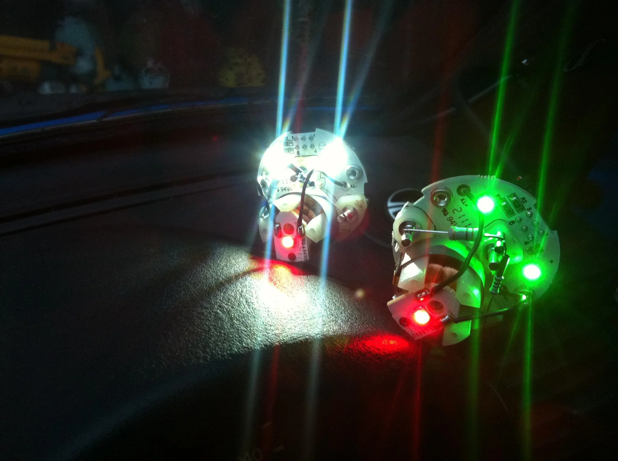

Your speedo lights are all smd (plcc-2) albeit the centre clock which is a t5w capless bulb in a holder aka dashboard lights if you search on eBay you'll see what I mean.
Lights behind clock are called twist lock but have yet to find right ones I have had 3 different sets

The bulbs in the speedo are a very small LED called an SMD they'll require soldering onto your existing speedo they're 2mm x 3mm.
The type of SMD is a PLCC 2 3528.

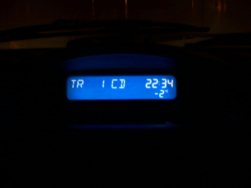

4 PLCC-4 White for center clock
4 PLCC-4 White for mileage

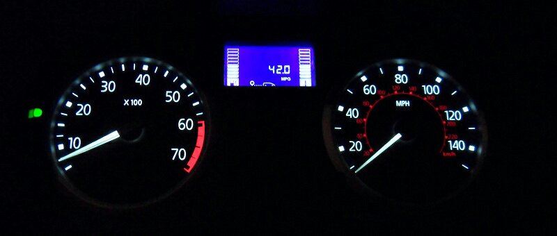

4 PLCC-2 Blue for rev and speed
Close enough :o

The pictures are a bit blured, look mint in rl.

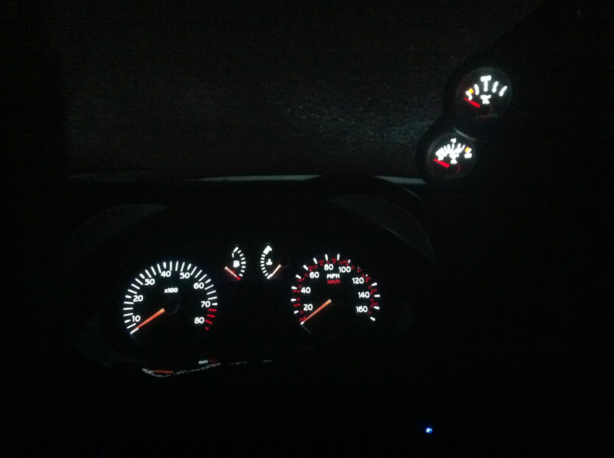

I changed my Racetech oil temp/pres gauges from the standard green to white to match all my other gauges etc.
I can do this for people if they send me there units.

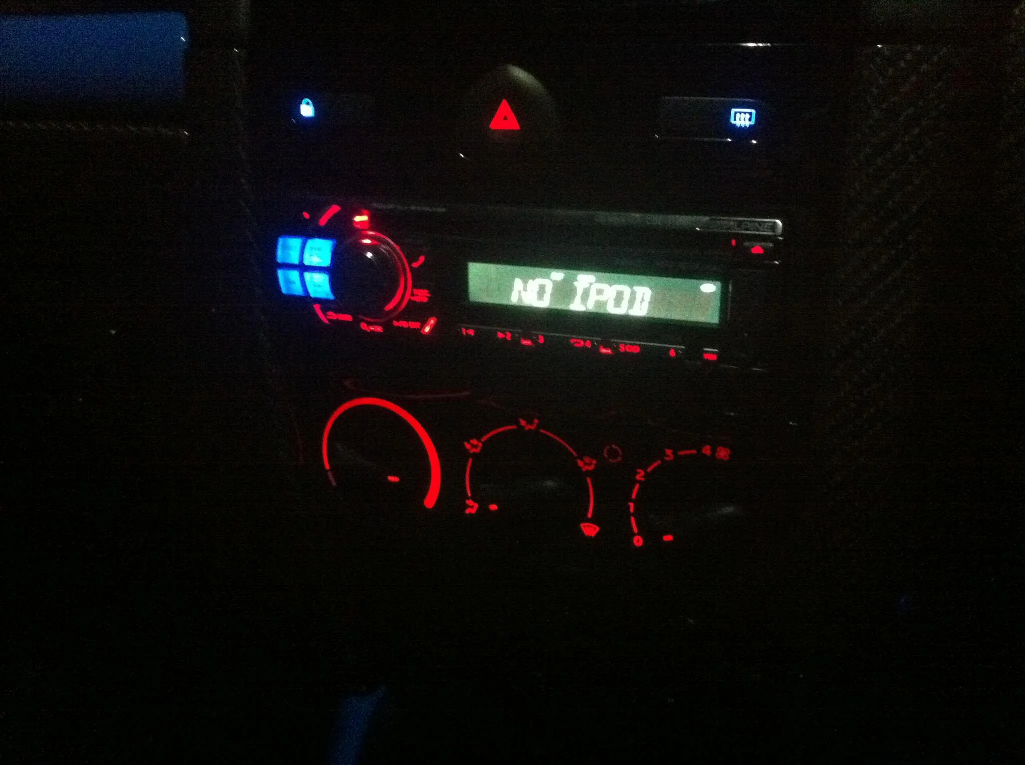

i like the red heater controls you have there, did you buy those wedge bulbs but in red? i had to replace them not so long ago, annoying things they are!
Yes you need for the twist nob heater controle 2x 509T twist lock holder. with 2x 286 T5 3xPLCC-2 Capless LED
You can only use red its the only colour that shines through the orange lenses in the heater controle. I did try blue but you can't see it at all it looks more like brown and then white makes them look orange again.
right gotcha, im guessing those stock wedge 1.2watt bulbs arnt bright enough fot it then? il probably end up doing the heater controls after anyway.
Does the 1k ohm 1/8watt resistor just get rigged inline for any switch light you want to change, didnt think about doing the buttons really.
lol, makes sense. why didnt they just stock build it as white lenses with orange bulbs lol. probably budget cuts again
Yes 1k ohm 1/8watt resister inline with 3mm dome top led in the switches. ;)

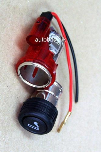

Then for the standard cig lighter I used parts from one of these with the existing standard cig lighter. I only used the red surround with the bulb holder with a white 286 T5 3xPLCC-2 Capless LED the rest of the componets were from the original cig lighter so that it retains the standard plug socket.

You can get other colourd ones blue green etc.
nice! are those lighter surrounds readily available? i had trouble finding out about the bulb in cig socket when i had to replace it before.
although yours looks a little bit different to mine, don't know if that's cos my car is a privilege variant.
No filter in the dash, just the one in the centre clock. Use white led to get the effect of blue background and white segments
i got one of these now, but it doesnt fit into the plastic panel socket.....
