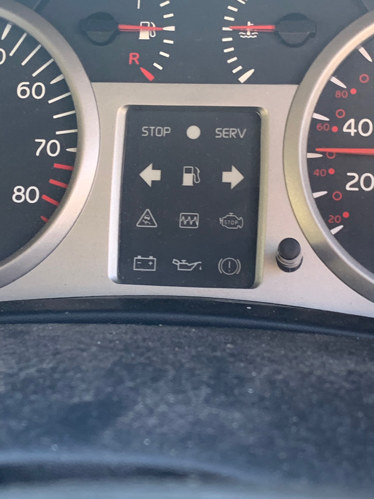

So I’m over in Germany and my Clio 182 keeps having a light come up on dash and power cuts to limp mode. If I turn car off and on again straight away it works fine?? Any suggestions only seems to happen when it gets hot and had some abuse but not sure if that’s coincidence or not as temp gauge is still reading okay.
It’s the one under the fuel light. Box with a funny line through it.
I had the same problem. I cleaned the throttle pedal box which helped. I later took off the throttle body and cleaned that, also cleaning the connections.
