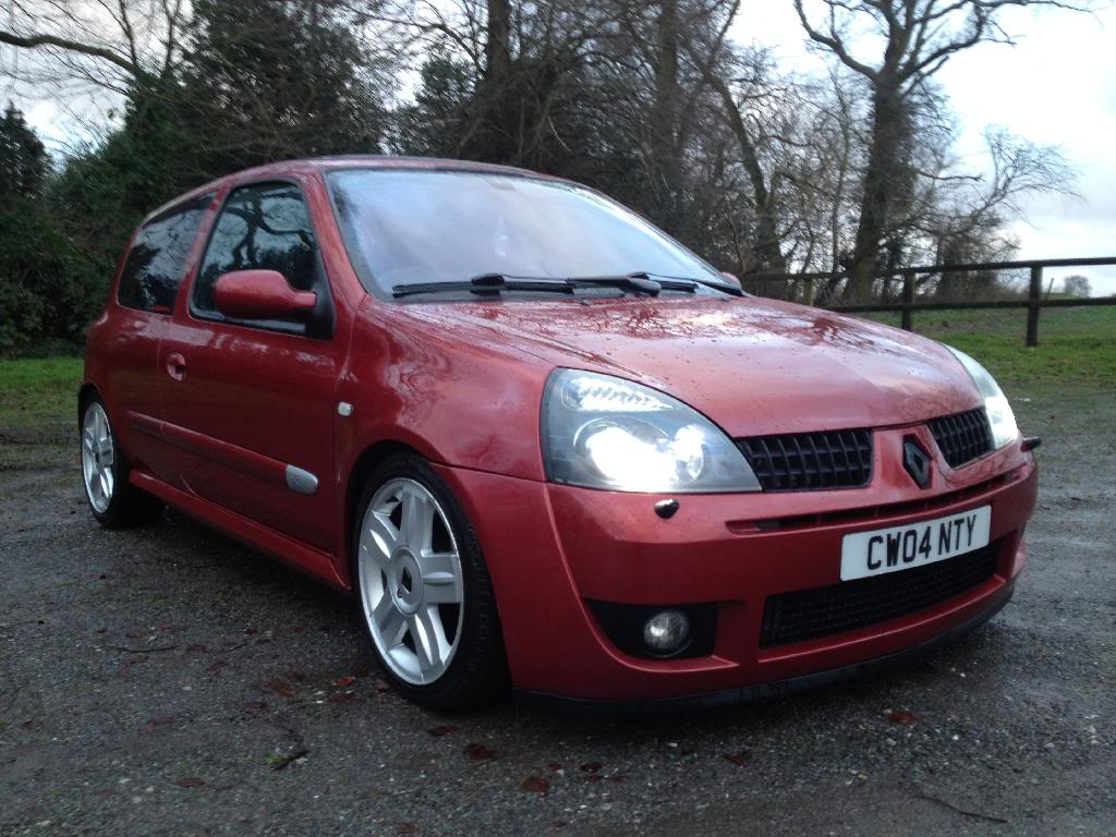

alex your car looks absolutely mint! has it been resprayed or standard color?

Mine is factory Flame Red.

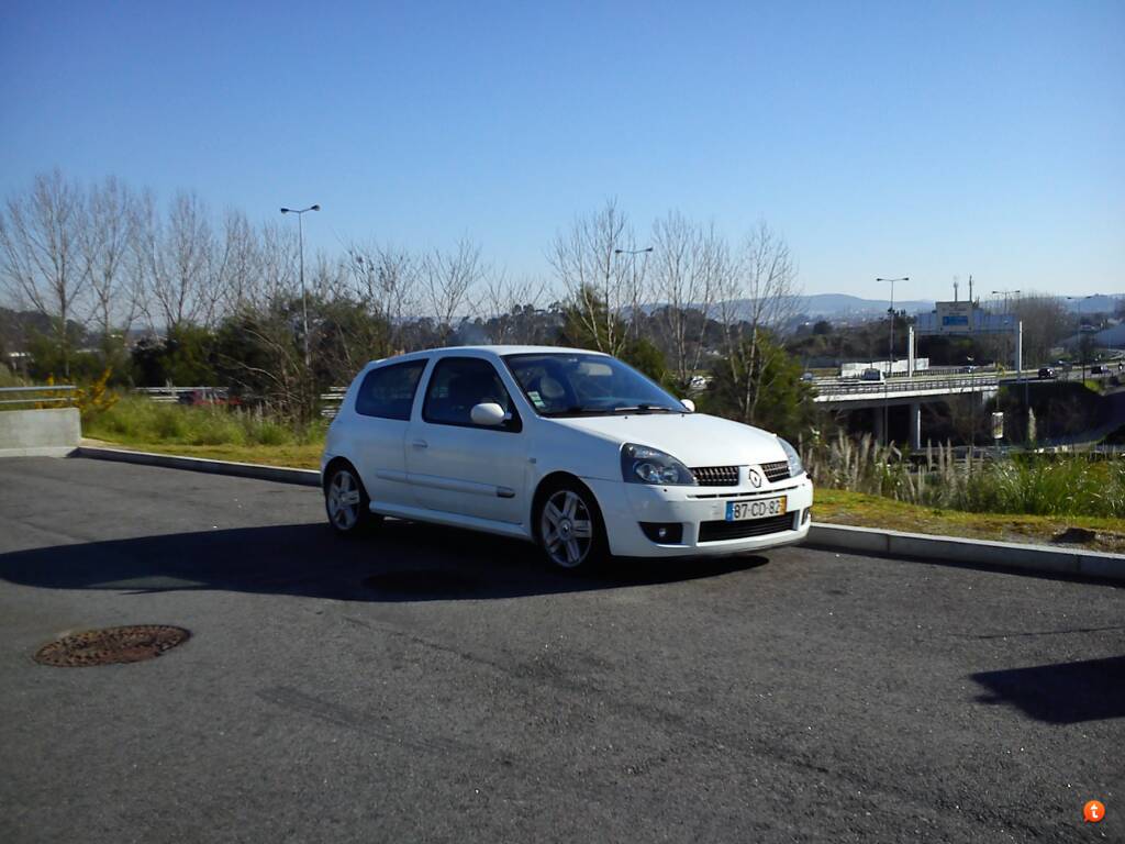

  Clio Storia 1.5dCi
I have a dci70 remap with 275k km and is a very good engine. Now have around 100ch. Is a good car and very funny for drive. Sorry about my english...
One picture of my car
