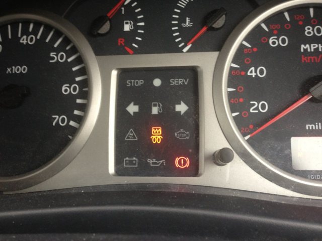

Hey, I've an 02 DCi Clio and this morning I got this light on in the dash....
The car takes a good few cranks to get it started but when it starts it runs and drives 100%.
Any ideas?

Common rail diesels don't need glow plugs to start. So you can rule them out straight away. I'd be looking at a diagnostics check paying special attention to fuel pressure.
May possibly be an injector leaking back too much fuel.
I had the glow plugs changed on Monday and the issue disappeared. The glow plugs were bad and at least 2 of them were completely dead. Was still on the genuine plugs with 105k miles on them lol.
Although... On my way to work this morning the same light came on in the dash. Same again, the car is running 100%.
Think there must be an issue with the relay as well. Any ideas?
