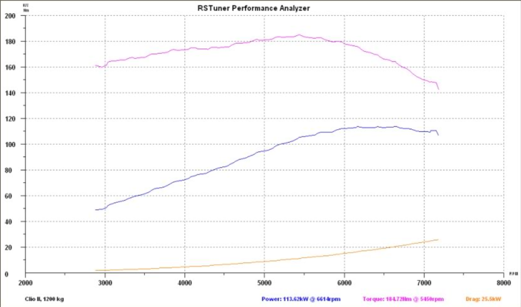

Here's mine without a de-cat so if someone has got a dyno of a car with de-cat then we could compare them!! Win.

Thing is you cant compare RR graphs, because each one will be setup slightly different.
So unless you did it on the same rolling road, exact same car, near enough exactly after each other, wouldn't be an accurate comparison.
