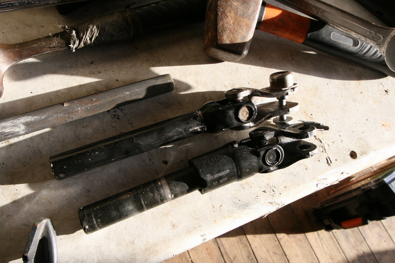

Its the rubber in the lower uj, you need to either weld it solid or use a twingo lower uj, can also use the clio epas column lower uj, I assume its very similar to the twingo one but looks a bit different though. Night and day difference.
Thanks ZachB is this quite involved to swap out? I'm about at my limit of skill/confidence working on car with bolt on bolt off suspension/brake parts so not sure if its beyond me.
Not a quick and easy job but not the hardest, just the usual cramped and buggered elbows getting the column out then you need to wack the ends off, again for me I didnt really have the tools so botched a spanner with a breaker bar and hammered the spanner, you can see where its left marks. Hard to find just the lower uj on ebay, I got lucky. Theres loads of full columns though but not much use apart from maybe the epas motor. Im reluctant to sell my column that has it already on as even though Ive gone epas it took me a while to figure things out and Ive learnt about selling things and needing them shortly after too many times now.
