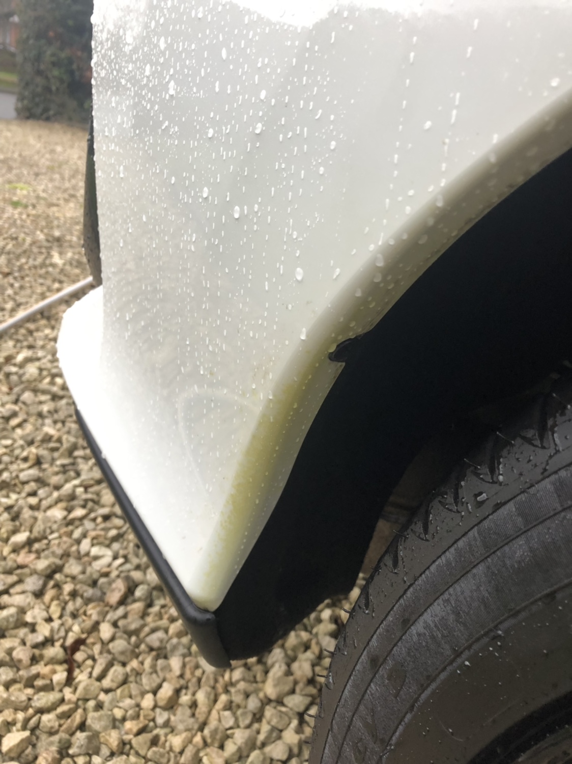

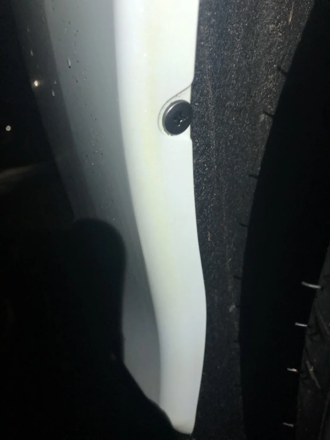

I did post this on Detailing World but thought I’d post on here in case anyone has come across anything like this before.

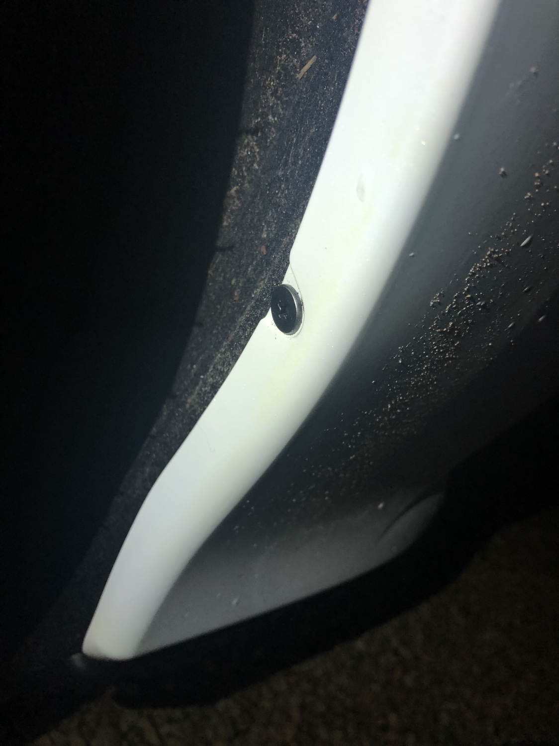

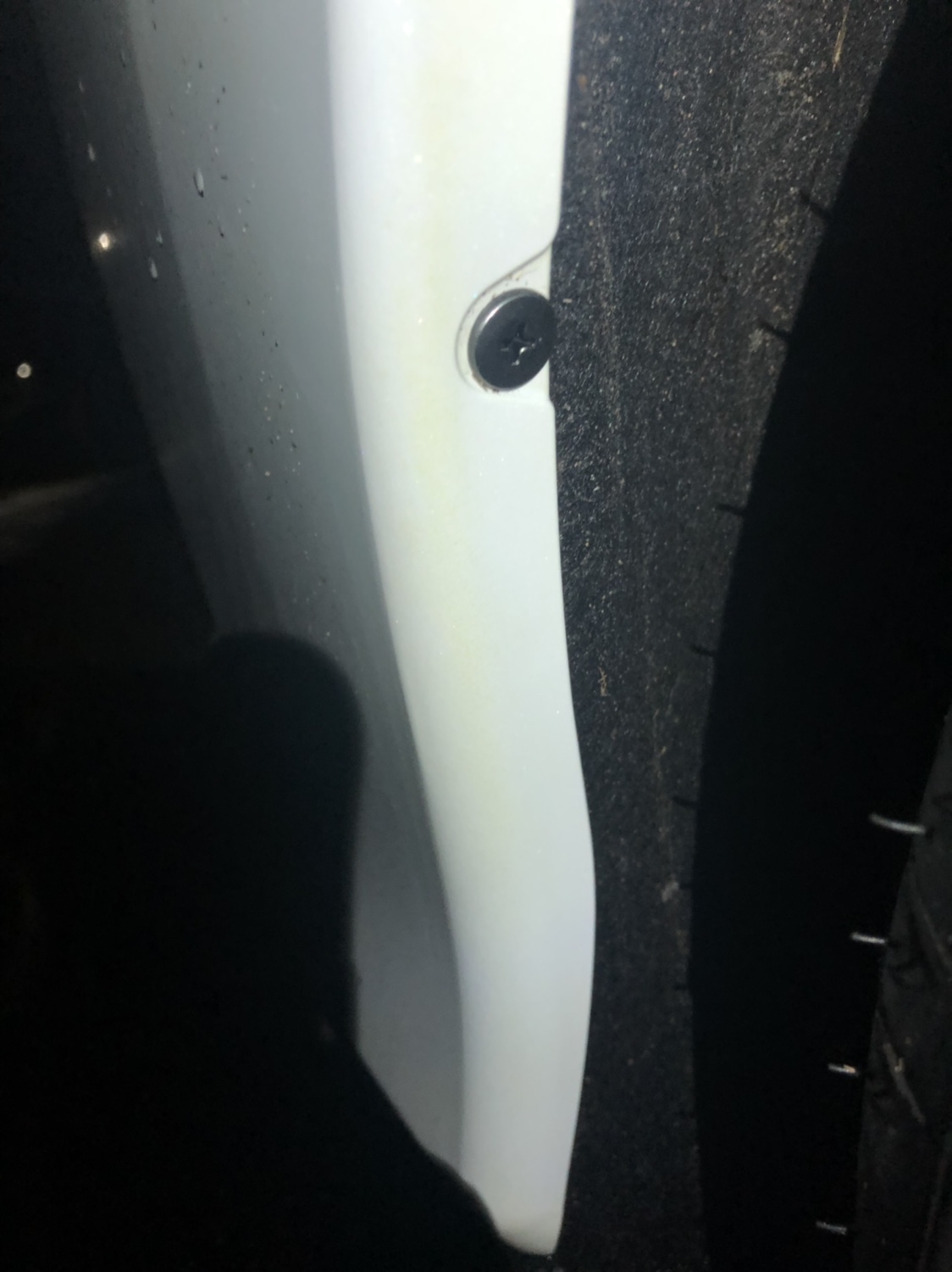

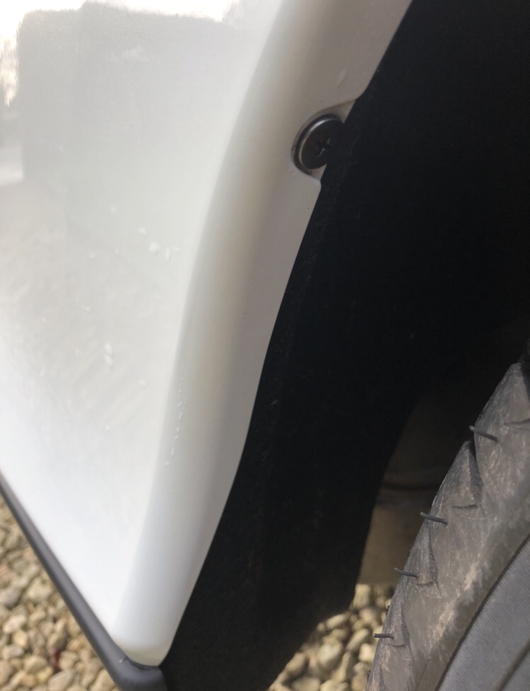

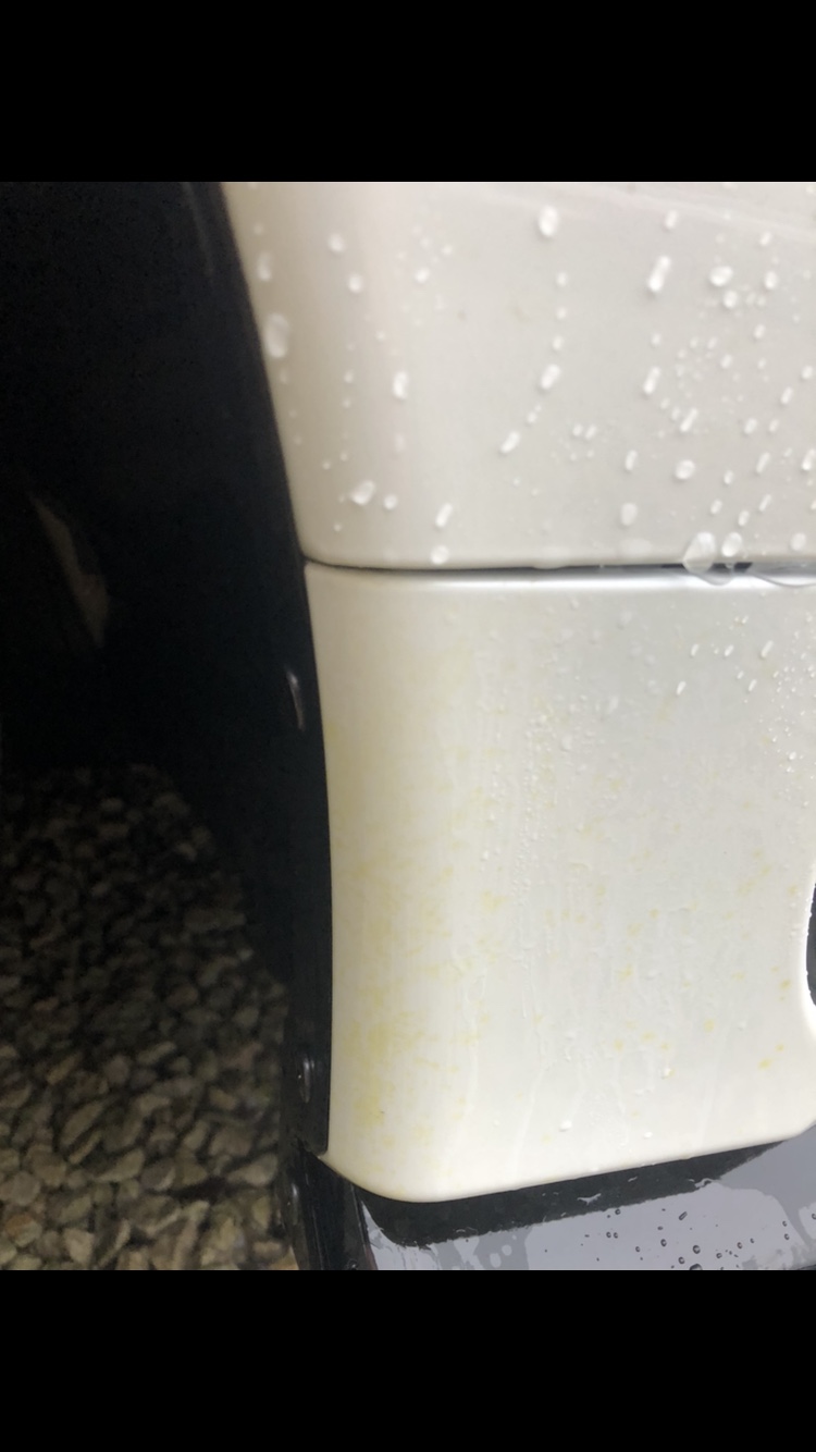

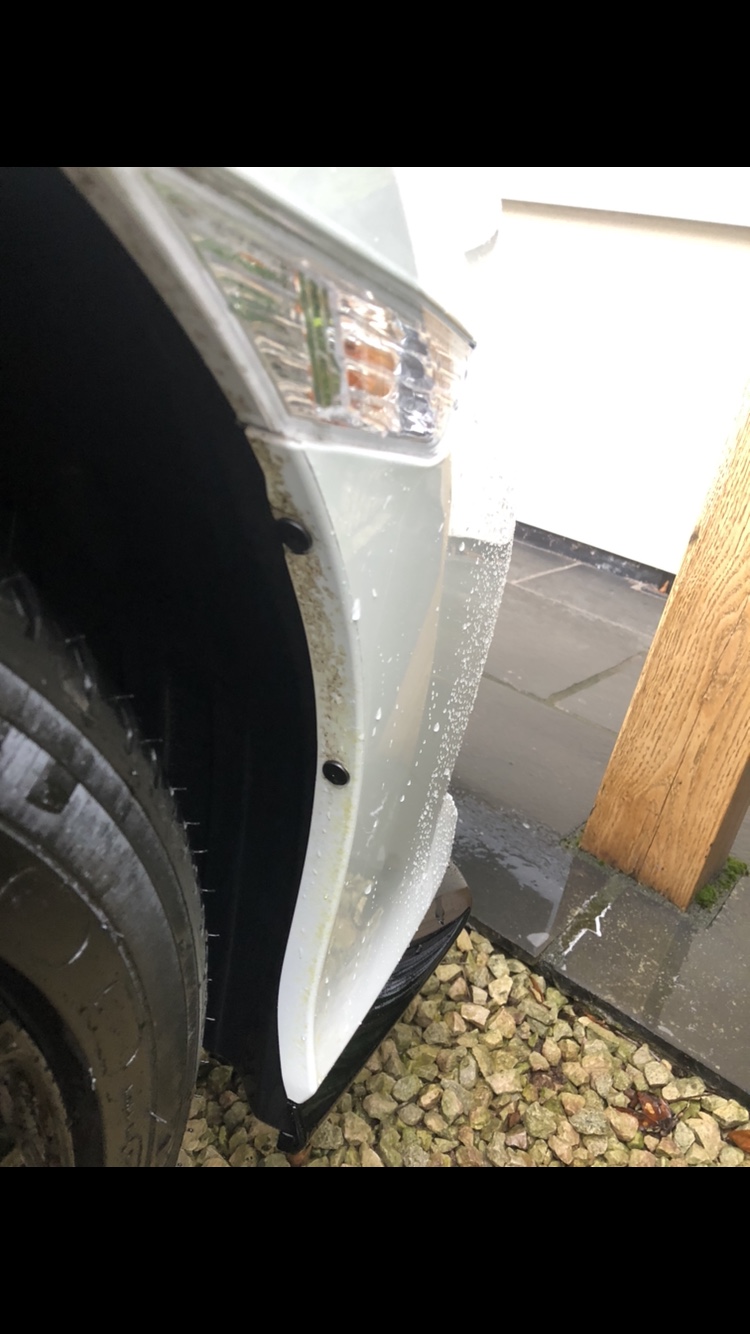

To cut a long story short the wife picked up her new white Civic on the Jan 3rd. I went to wash it last Saturday and whatever the dealer used as tyre dressing has reacted with the plastic painted bumpers and sills. Garage has admitted liability but I’m still amazed that I’m the first to suffer...I have managed to remove 80% of the damage using Tardis but unable to remove the damage completely...
From this...
To this...

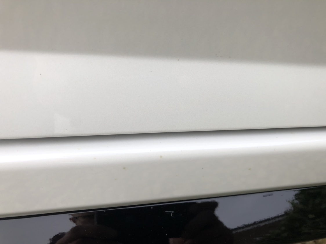

We returned the car to the dealer on Wednesday and they clayed and applied some kind of solvent. They’ve told me to wait 5-7 days before washing but I’m not holding out any hope as I couldn’t shift it completely with anything in my arsenal.
Anyone seen anything like this before?
Next step will be to return the car again. I’m not sure what the dealer will do except may be swap the bumpers over...Annoying seeing as though the car has only done 300miles. Even more shocking when you consider it’s dealer tyre shine which has stained and ruined the paint.

Most usually use Autosmart Highstyle which is silicone based and it wouldn't do that.
They must be using some mad stuff.
Yep! Apparently they’ve thrown whatever it was away.
Interestingly though it was relatively easy to remove of the metal work with basic shampoo. The plastic on the other hand...Touch the tyre with your palm then touch the bumper paintwork and you need something as strong as Tardis to remove it. It’s as though it reacts with the plastic.

It might come off with a machine polish and some fine cutting fluid. It'll take a layer of the clear coat with it mind.

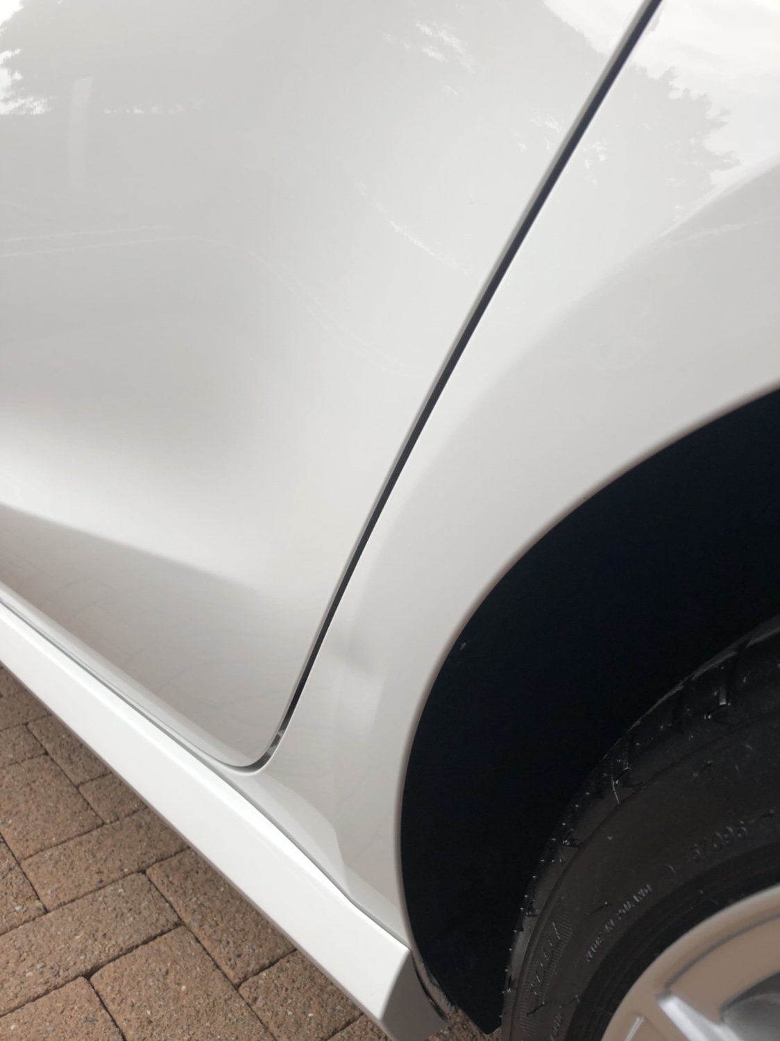

Doesn’t seem to matter which manufacturer you buy from...Audi presented this to my mum when she bought a new car:
Audi (unlike Honda) make this big thing of unveiling a car from under a sheet. Can you imagine the look on my face when they “unveiled” a dented car LOL.
The fortunate thing with the civic was that it was absolutely perfect on pickup. 100% spotless.

They have probably used Autosmart silicone free Tyre dressing. We had the same issue at my last place of work.
We ended up having to paint the bumpers on a brand new 911 as the dressing had effectively sunk underneath the lacquer.
That was just one of a number of issues that that particular Tyre dressing caused us.
We switched to their basic silicone free dressing and the problem vanished.
From your point of view, I’d get them to try their best to polish it out and avoid (if you can!) letting them paint the car.

Ok, update.
Honda have not managed to improve the staining. They have gone away to discuss options. Initially they mentioned paint but as Honda bumpers are pre-painted that will be a last resort.
Another option would be to keep it with some compensation our way but they haven’t mentioned that to date.
They’ve asked for some time and I’ll give them a week but my gut feeling is that they hope I just accept it and go away.
Damage to the the sills and front bumper is minimal so I’m happy to leave it be. Rear bumper isn’t great though so something needs to be done.
My wife (who isn’t particularly fussy) would take some cash but I’m not sure the garage will go for that and I have no idea what to accept if they did...Any ideas? A new bumper plus fitting must be knocking on £750 so may be that’s an acceptable figure?
They mentioned colour match on a pre-painted bumper but as the car is new and the bumpers will have been sprayed separately from the car, probably loads at the same time I can’t see this being a problem.
Any thoughts on how to proceed would be greatly appreciated.
