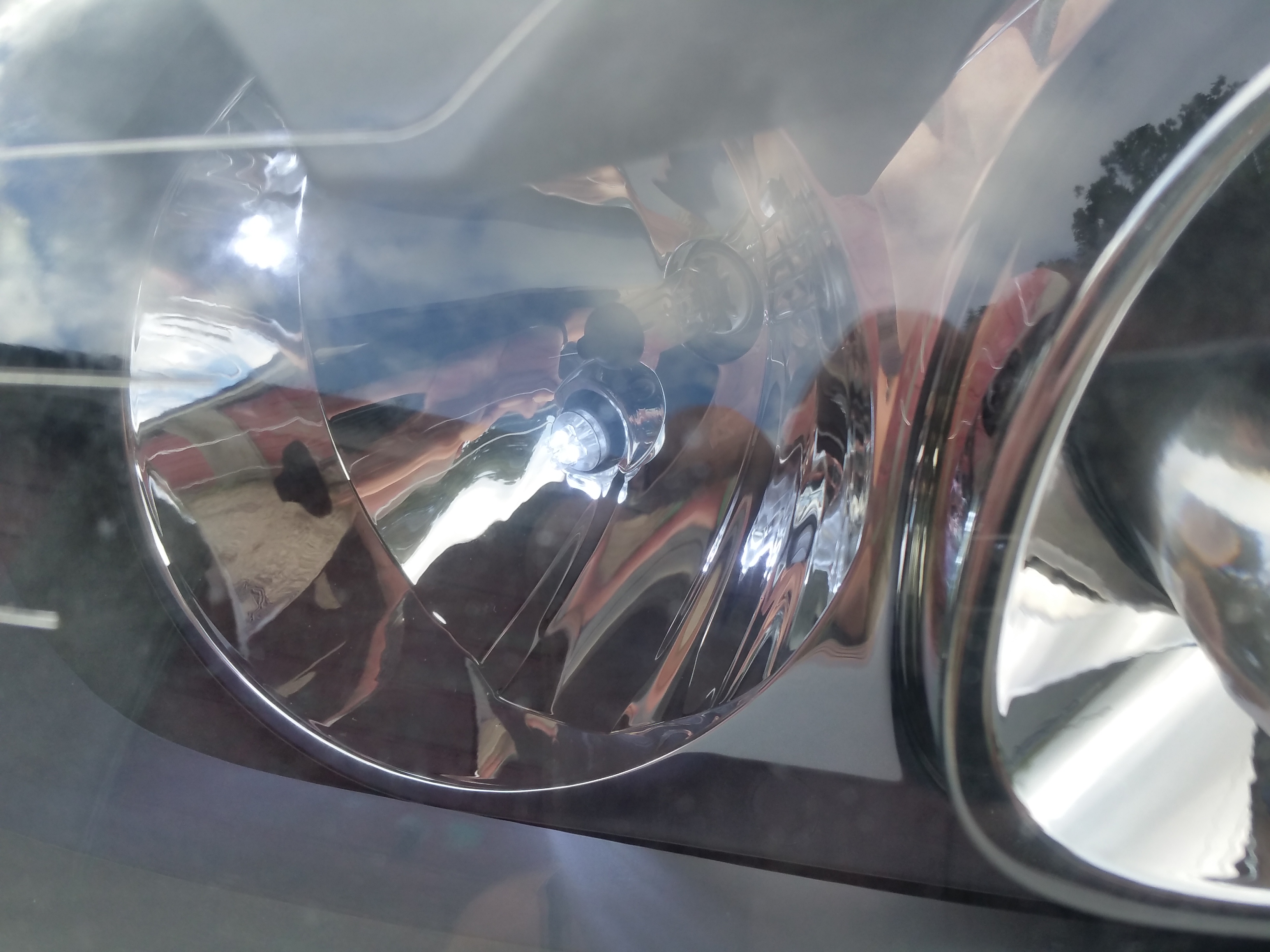

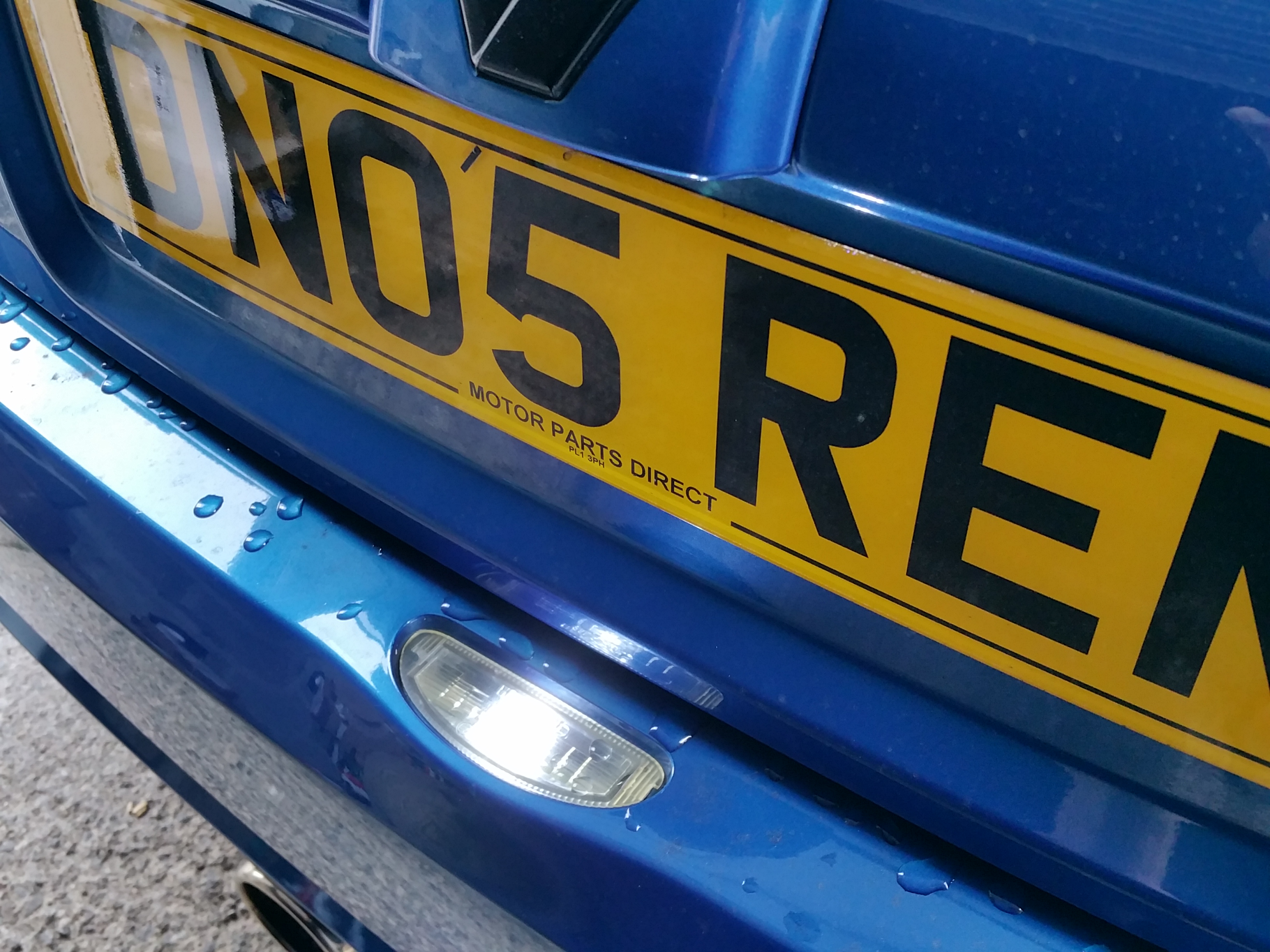

also got hold of some Led bulbs fo the 182. ..rear number plate bulb X2 for £4.99 and X2 side light bulbs for £3.80 which I think is ideal for under a tenner.
couple of pics with them fitted:cool:
happy days:smile:

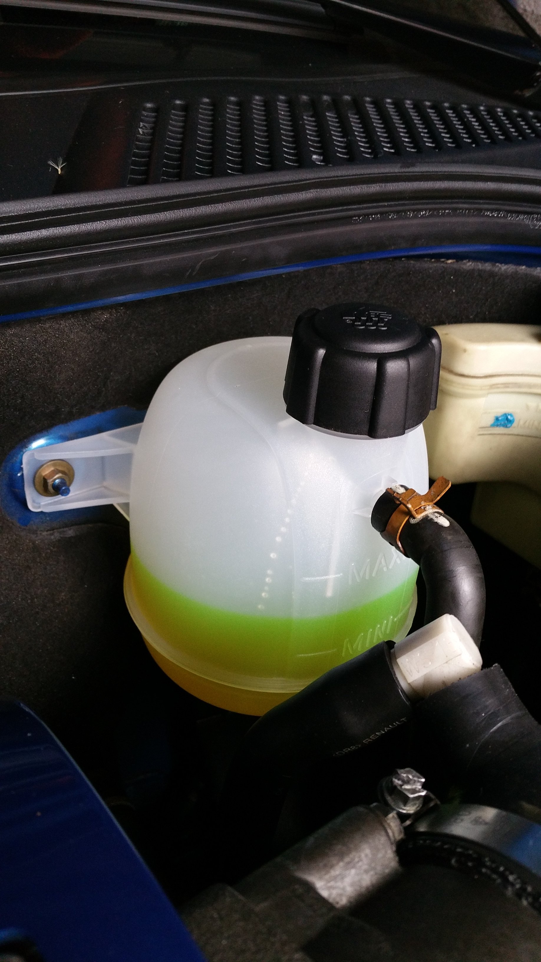

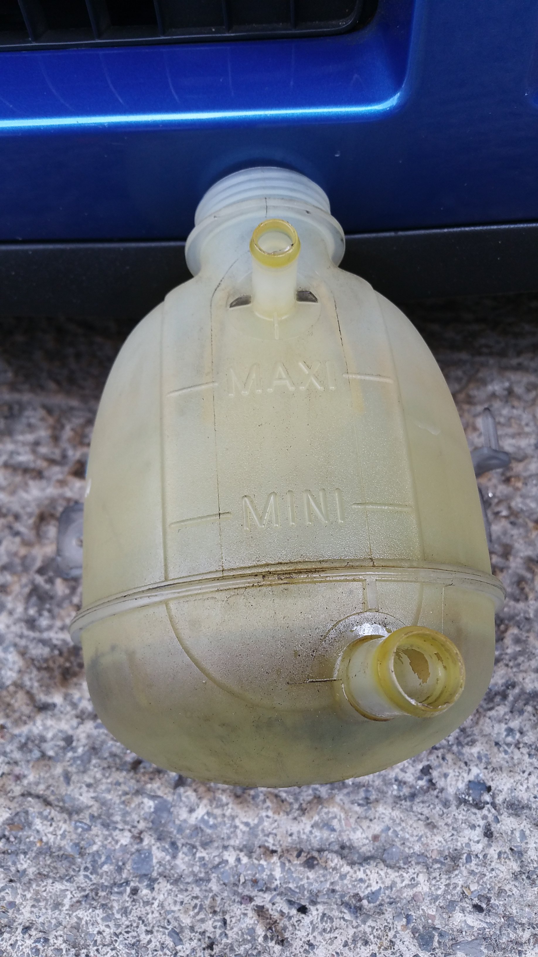

decided to change my expansion tank as it was looking a little tired and letting down engine bay as I want it to look cleaner:tongueout:
so today I picked up a new one from the local stealers and it only took me about 15 minutes to fit ...here are a couple of pics of the old and new...which makes a better difference :cool:
old
and new:wink:

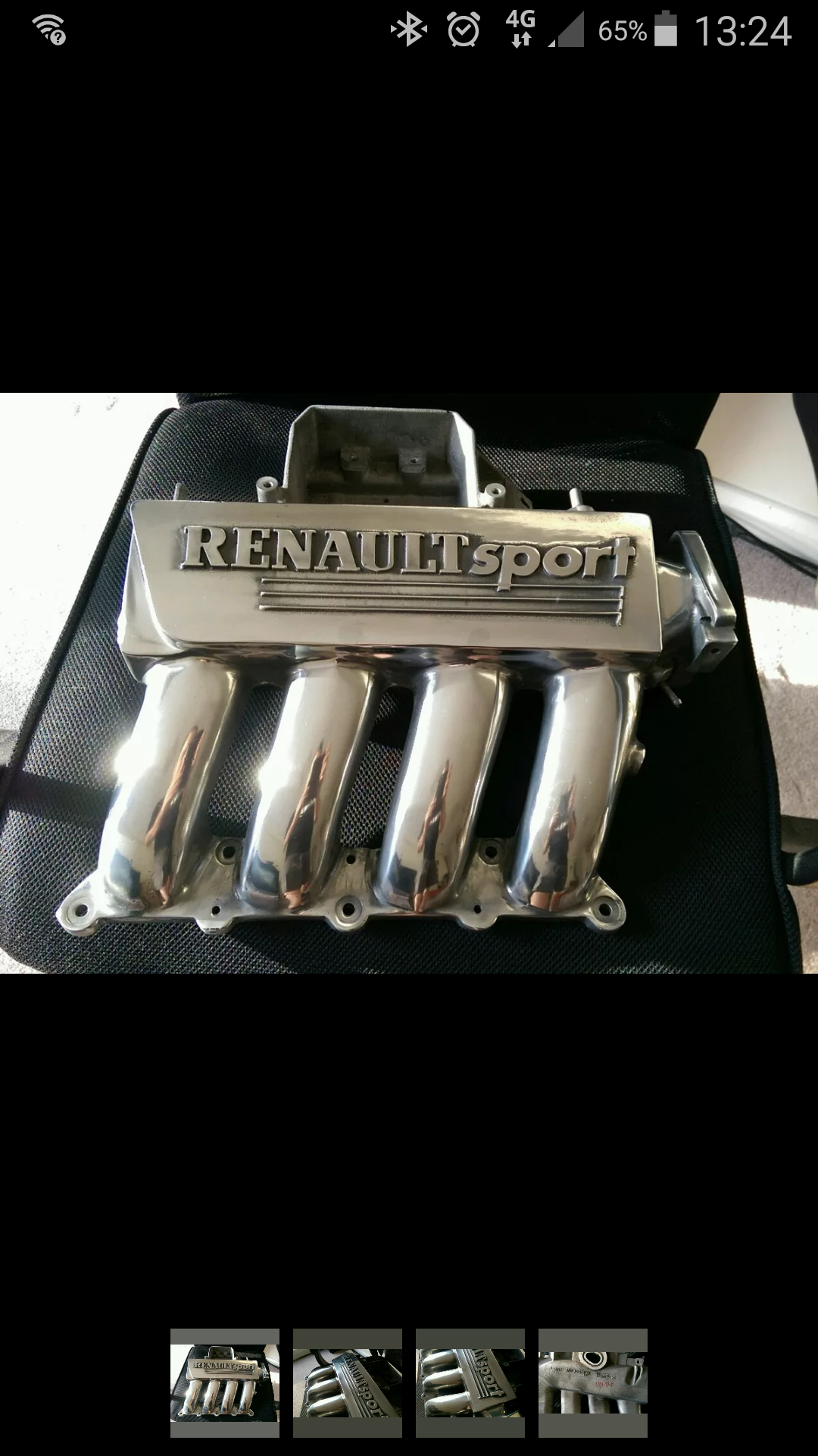

very small update. ..waiting on this to turn up and be fitted:cool:
been trying to find one for a while
finish off some bling :wink:

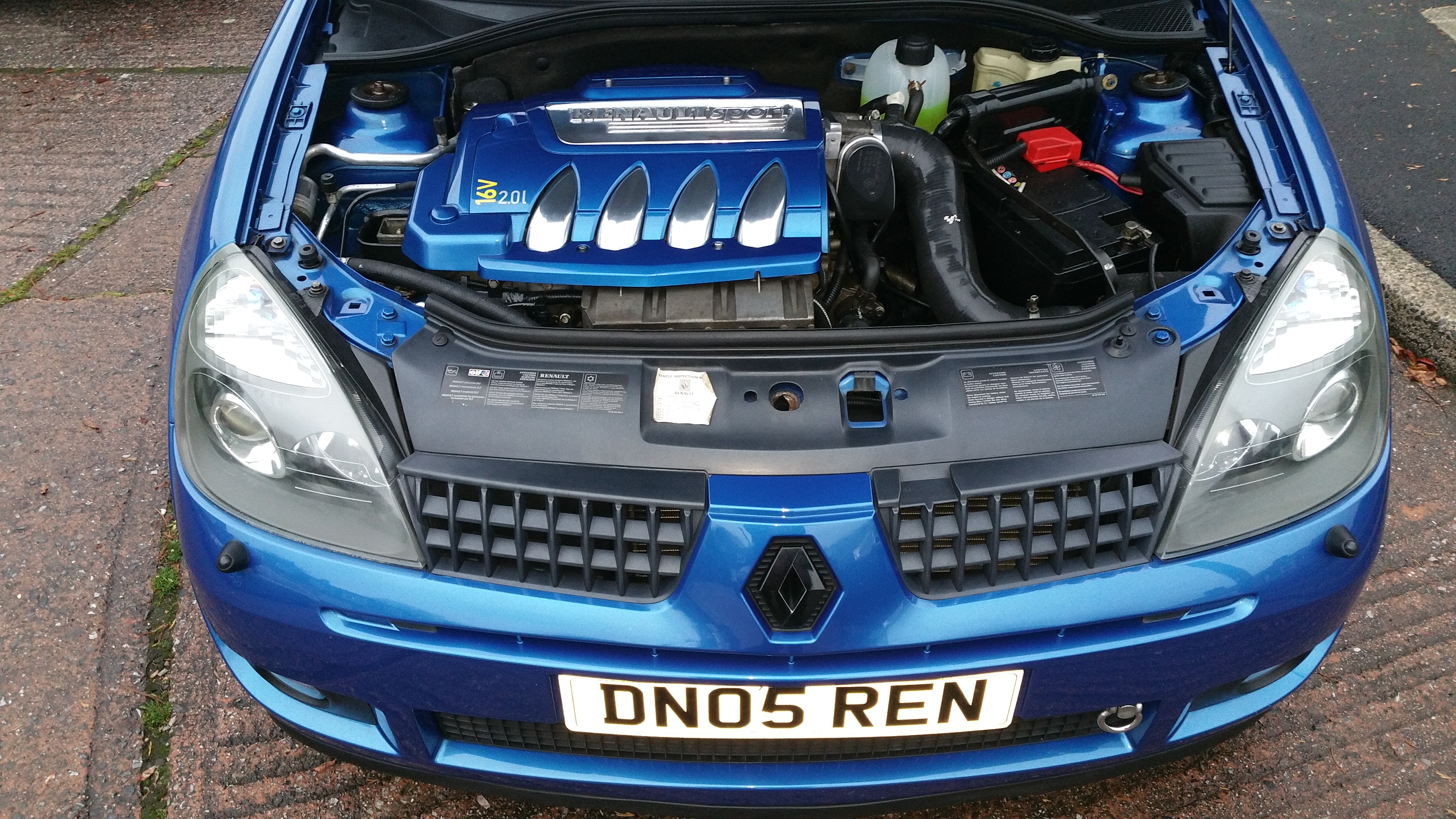

finally got fitted ....after a few days of taxi work all hours I got chance to fit the manifold today and all went really well with not a problem. ...bolt's came loose nice and easy..so put them all back with a bit of the cooper grease..
and gave the throttle body a good clean also:wink:
just need to get a chrome polished fuel guard to finish off the bay for now:smile:
here is a couple of pics
does seem a shame to cover with the painted engine cover...but nevertheless it does finish it off:cool:

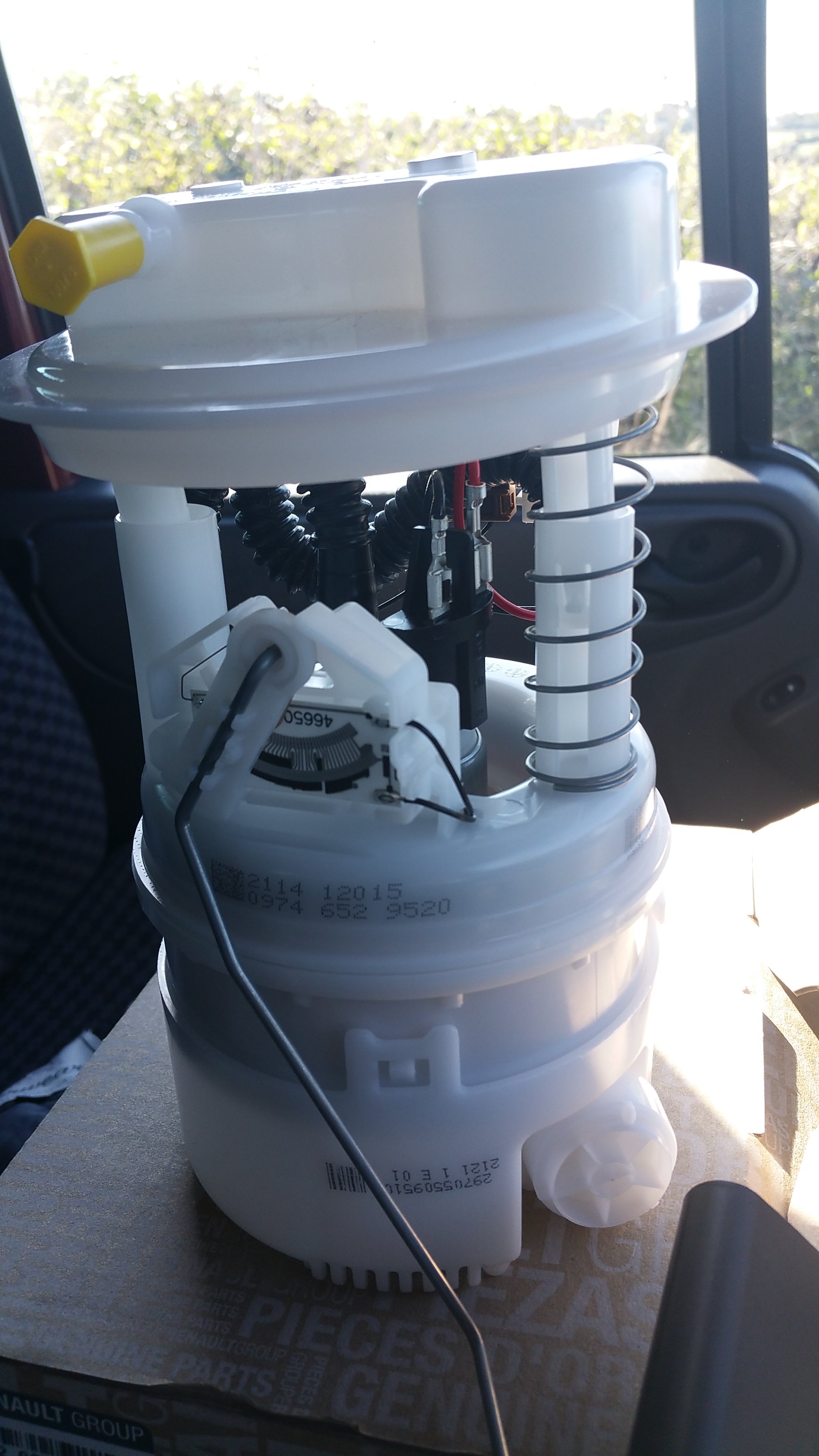

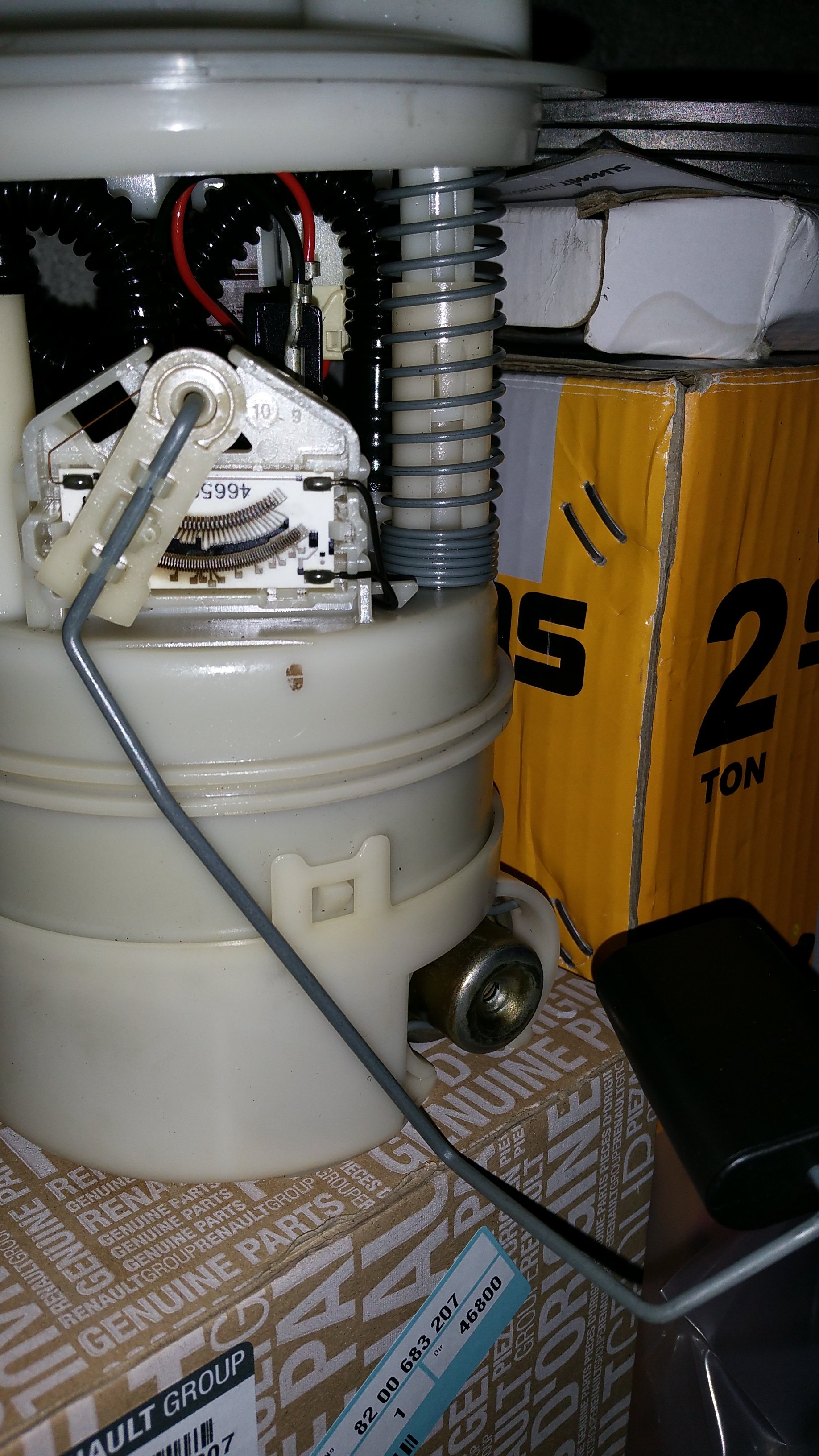

also last week went up to dan@sjm automotive to get a couple of jobs done witch were gear box oil change with genuine tranself nfj 75w-80 which I supplied and timing check and fit new fuel pump and cap as the pump has now been superseded to keep contact fuel pressure for starting...which they have blanked off one side of pressure regulator (couple of pics below) with no more starting issues first time with key.
the timing was fine also as dan told me it was the first one he had seen for a while that didn't need adjusting. .happy days:smile:before.. with pressure regulator not blanked off
and after with it blanked off...starting issues sorted:wink:
