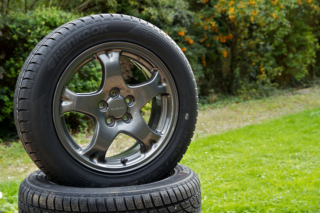

Hankook W310 .. in fat 16". They're OK .. not incredible but very good I'd say.
Braking hard from, ok, lets call it 60, on snow/ice into large dual carriageway roundabouts and full throttle out the other side in 2nd/3rd was no issue at all last time I checked ;) Bit like a wet day in a normal car.
When behaving driving normally to work etc during the cold season, the only way I knew the ground was slippery was when I near enough fell over getting out of the car :eek:
Sealed and ready to roll ! by TheEvilGiraffe, on Flickr

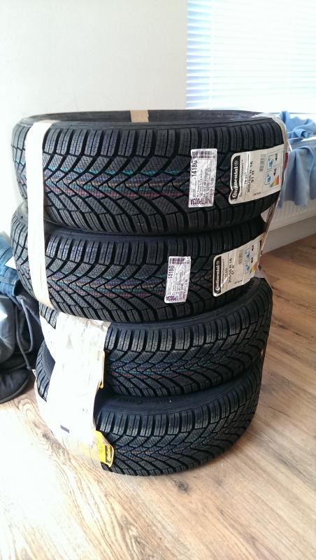

Those contis seem to win every test atm
They are what i'm getting.
That was what I found when looking around at winter tyres for the merc.
4xConti WinterContact TS850s in 205/55/16 from Ears Motorsport came to £329 I think - absolute bargain.
I'm half tempted to find a cheap set for the Clio for some snow rallying :D
They look pretty agressive!
