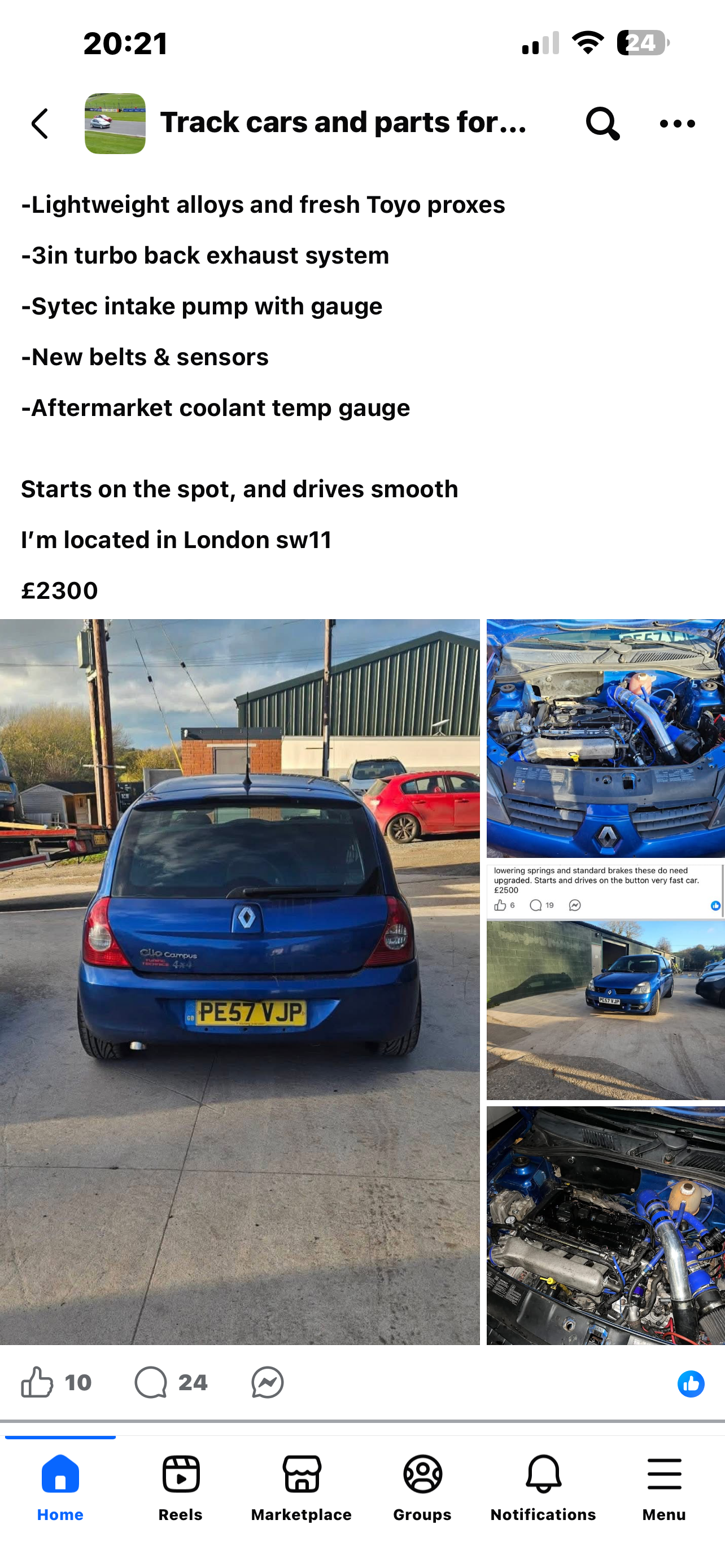

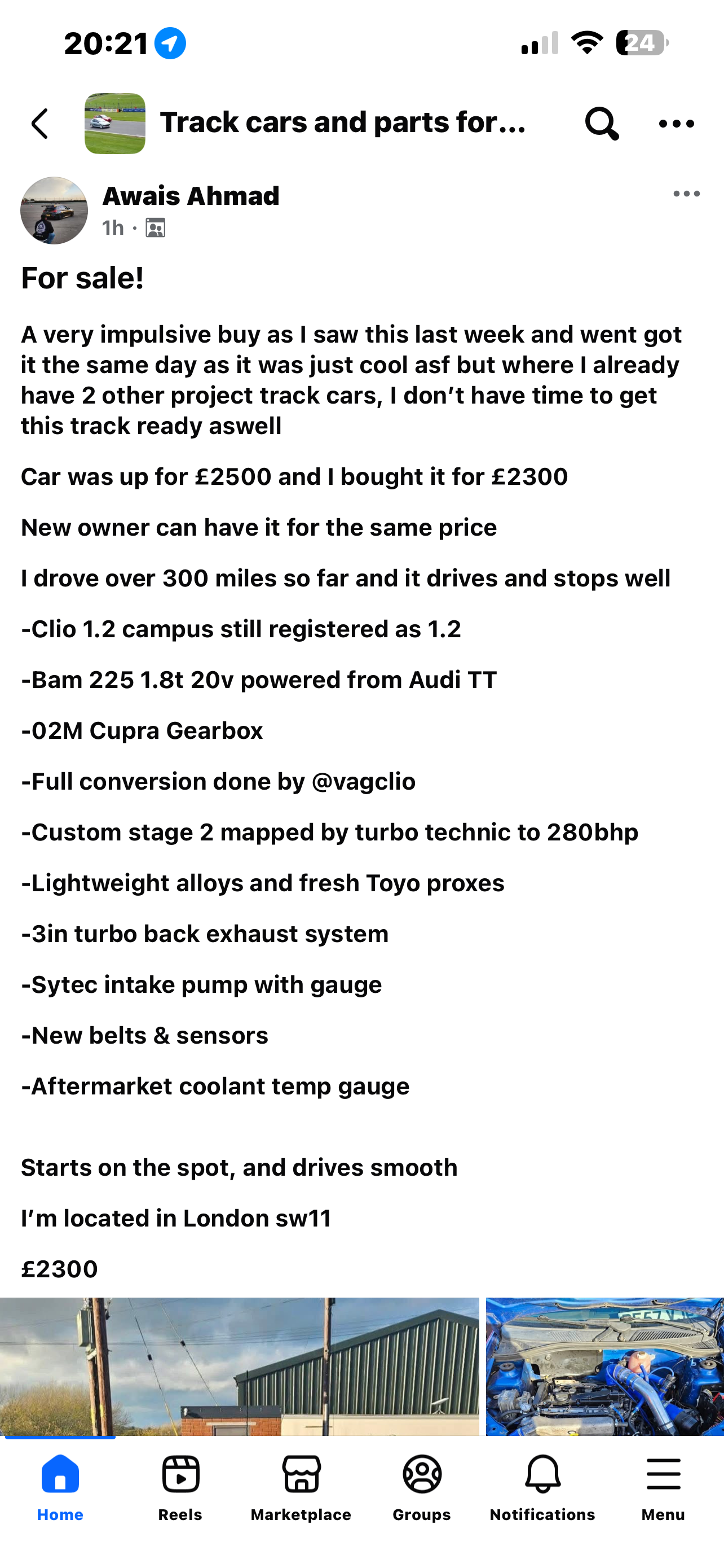

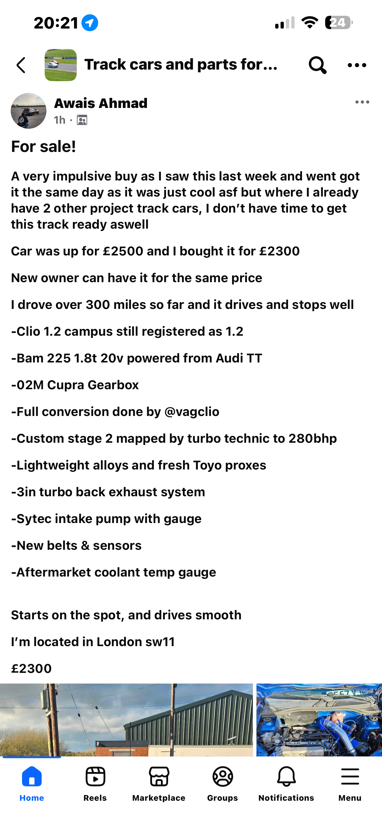

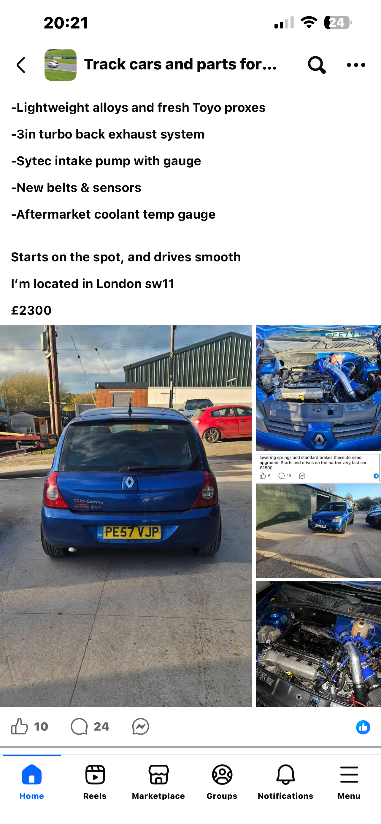

Full car just appeared on FB. Cheaper recitifying a done one than building!
Alternatively
