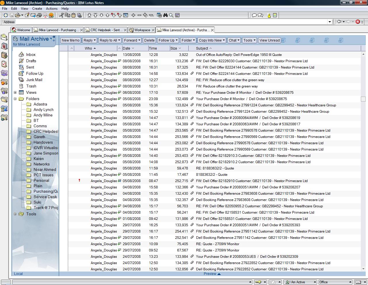

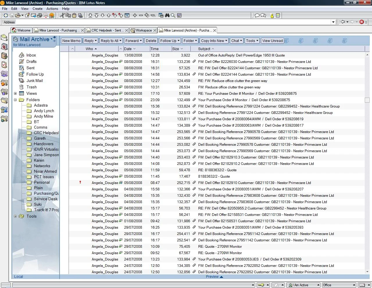

Actually no, I just think you're a bit of a pillock. Got tons of Dell kit, and it rarely goes wrong. We've got a pile of 7 year old Dell servers which were upgraded as part of a refresh, and apart from being 7 years old technology-wise, they're fine. Only one has gone pop, and that was a PSU that went... These things happen!

Without, I'm afraid:
Also, how do you differentiate 'the business world' and 'the home user'? Their support center is in the same place, and the hardware is made by the same people and typically shares a lot of key components.

As for leotroll or whatever, what problems have you had then? As with 6 computers having 6 problems I'm not particularly fussed - you may just be the victim of 'bad luck' or even user stupidity as above. I've had well over 15,000 Dell systems under my nose and they've been pretty much brilliant for what they were purchased for. I've got a Dell Optiplex GX50 sat in my cold, damp garage acting as my firewall... It's older than this forum!
