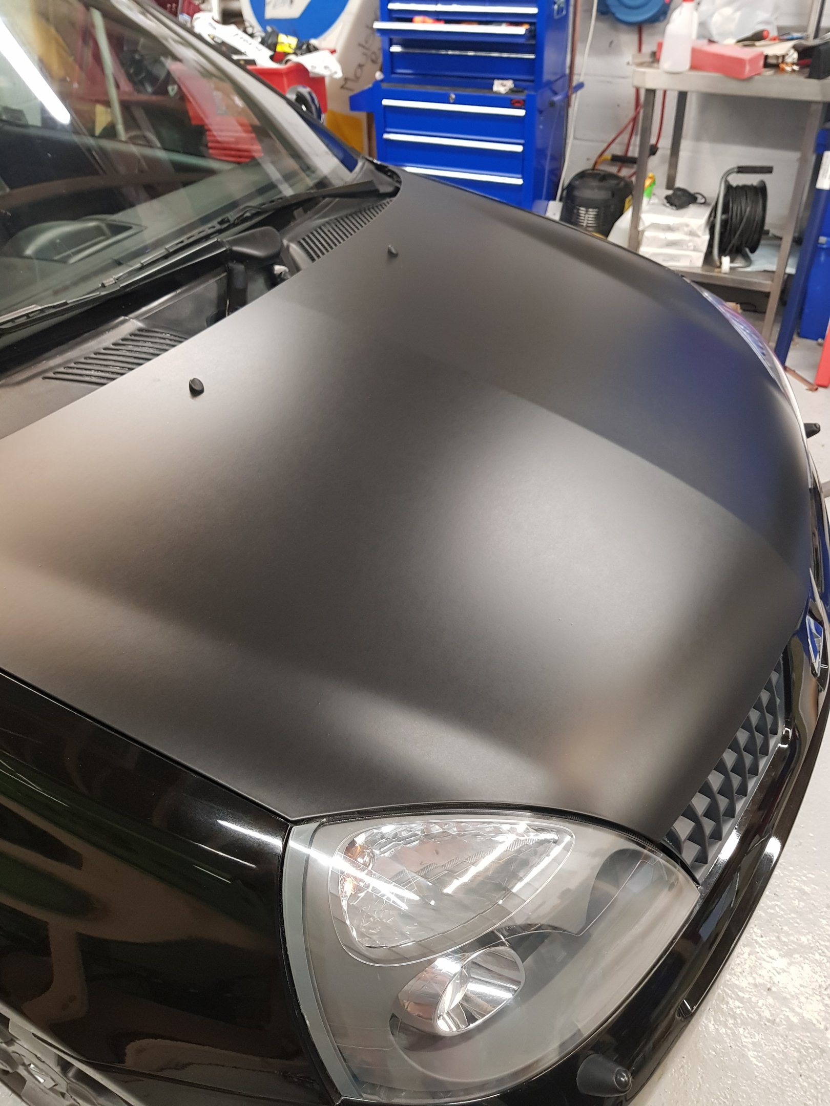

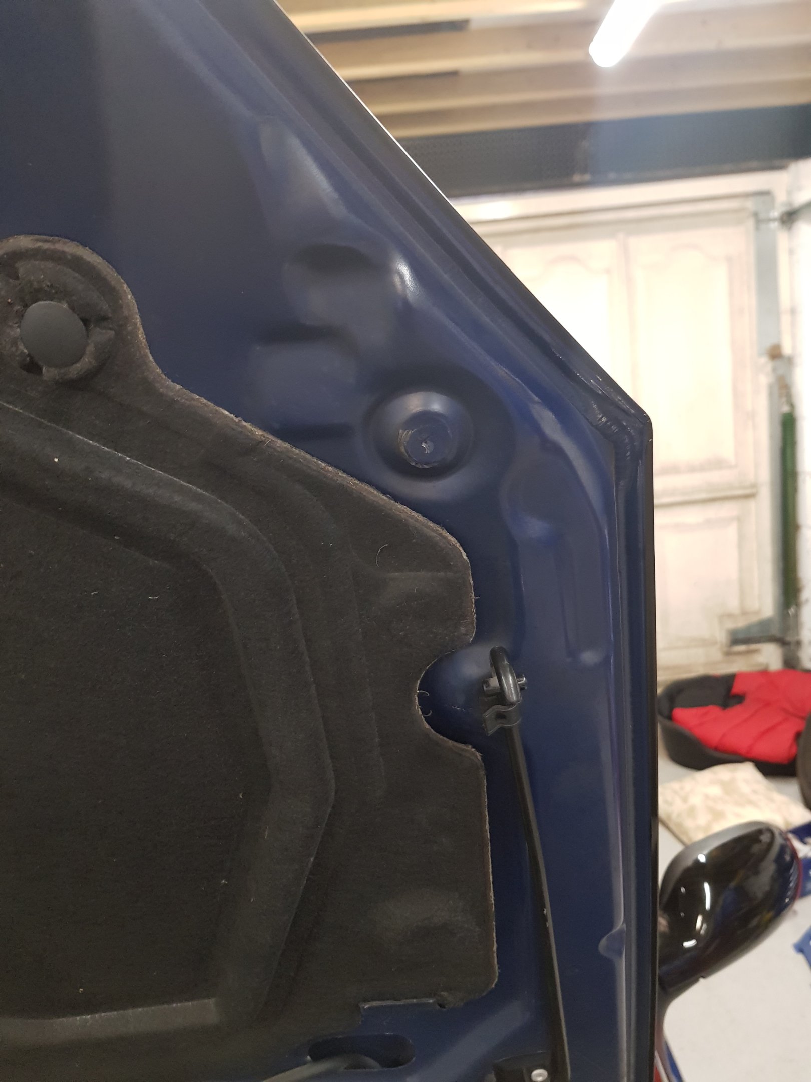

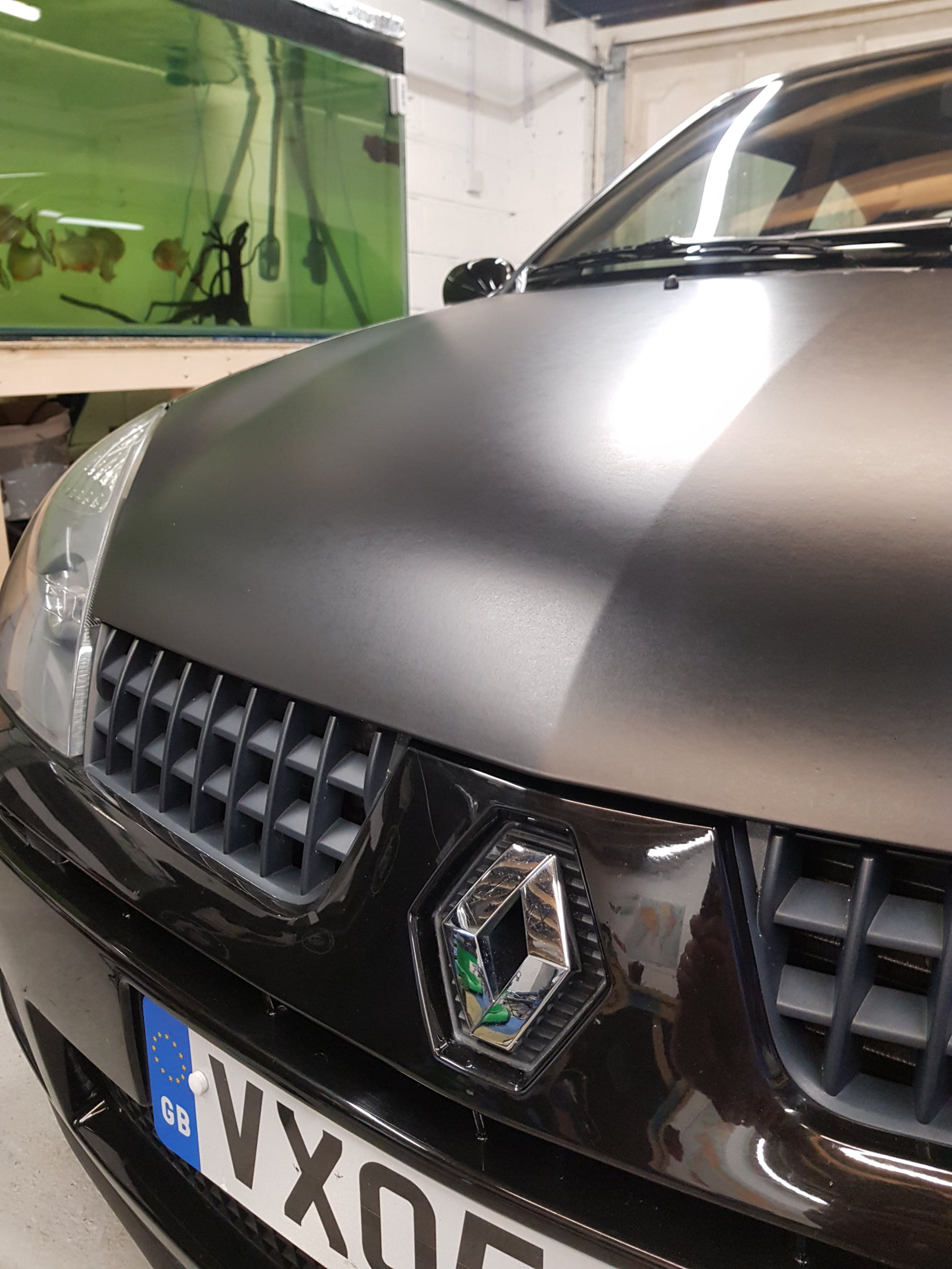

So my BG182 had so many dents in the bonnet I couldn't see past it, I found a bonnet on the bay for £40 but it was a weird purple/blue colour. I got a quote to respray it, blow it into the wings and spray the tops of the doors that need some love also, £750!! So I ended up wrapping the bonnet myself with hexis Matte black. Came out pretty good, thoughts?

Spraying the tops of the doors, above or below the window?
Yeah looks good mate
Thanks mate, above the Windows, They are pretty bad. Had a quote of £500 for cash but the guy doesn't use a booth and crap paint would grate on me every time I look at it....

Took me months to find my new BG bonnet and that's not without dents (has a couple very minor ones that I'll get a dent man on eventually).
They all seem to be pressed in in the front edge

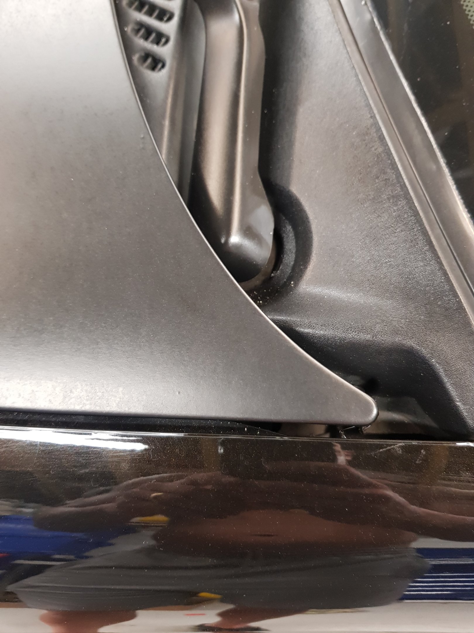

Looks alright this! Any close up pics?
Can post one up tomorrow but, I probably watched 200 videos before I wrapped it so it's pretty spot on, corners are good and no bubbles or marks. Pleased with how it came out
