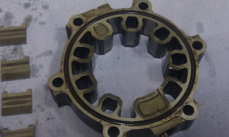

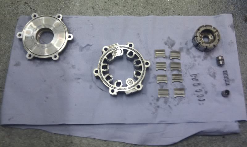

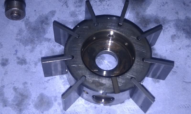

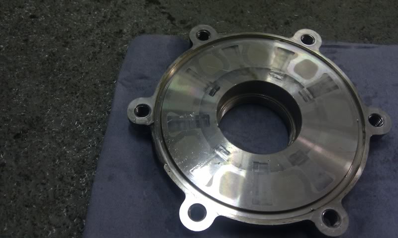

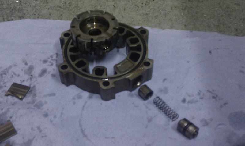

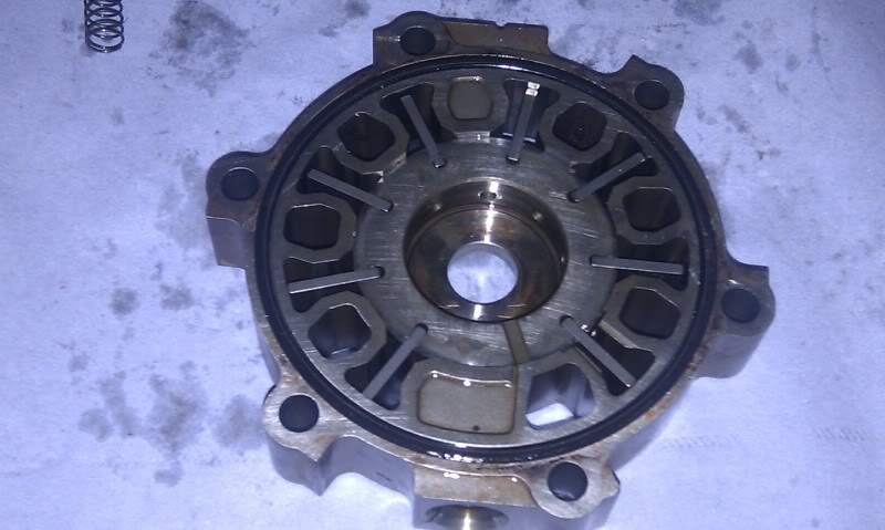

Insides of a dephaser
Good pics.
I wondered what they were like inside.
So, how exactly does it work and what are the parts that make them become vocal?
Never realised the inner ring could be removed like the above picture.
When I split my knackered pulley apart one of those small square shaped pieces was really loose.

Nice pics Danny. Never seen one taken apart before.
