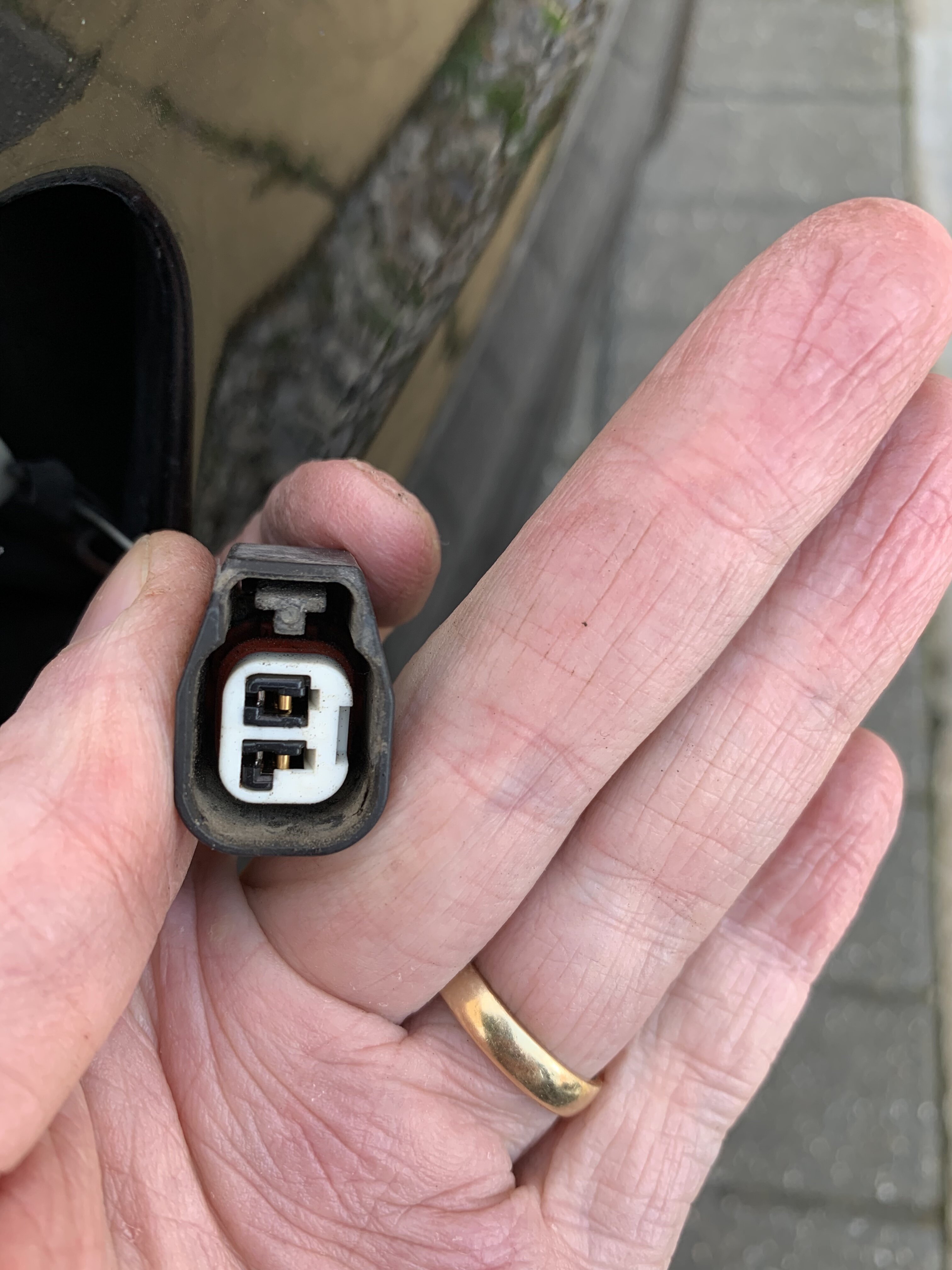

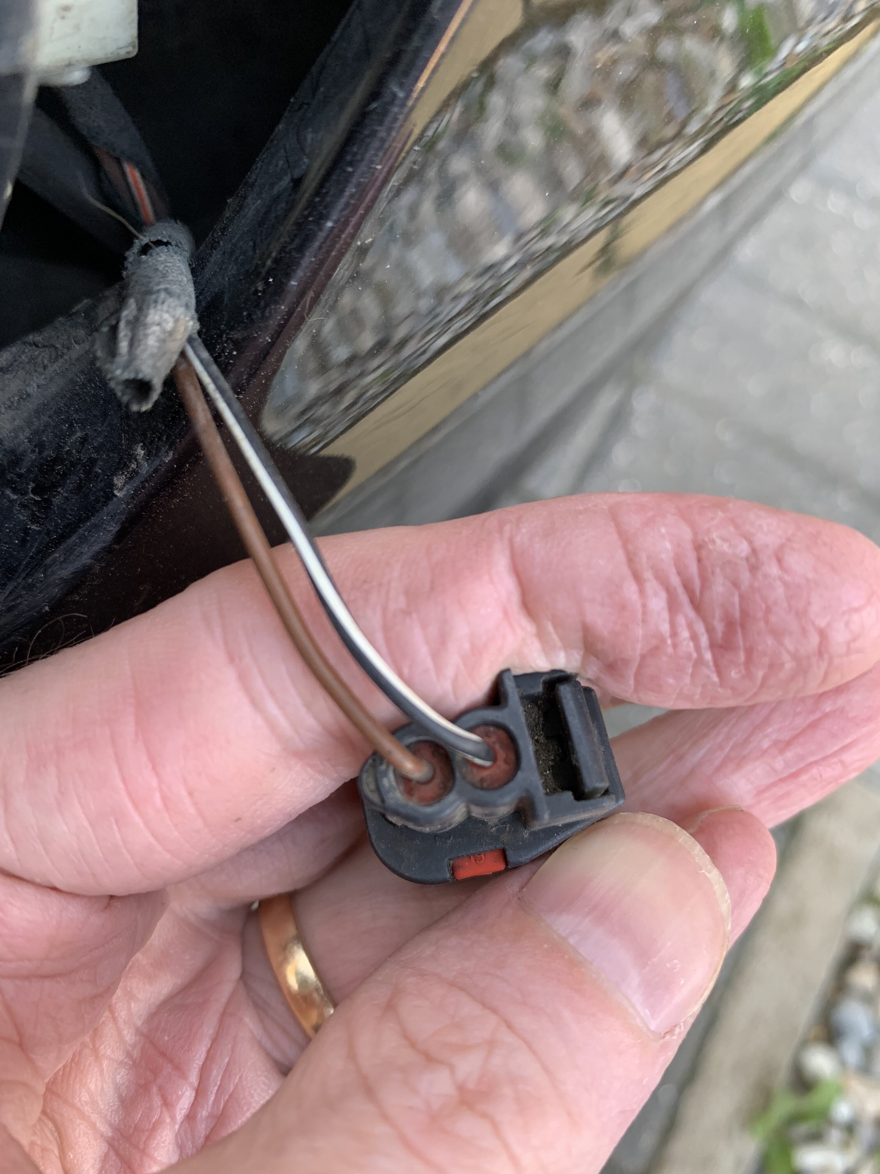

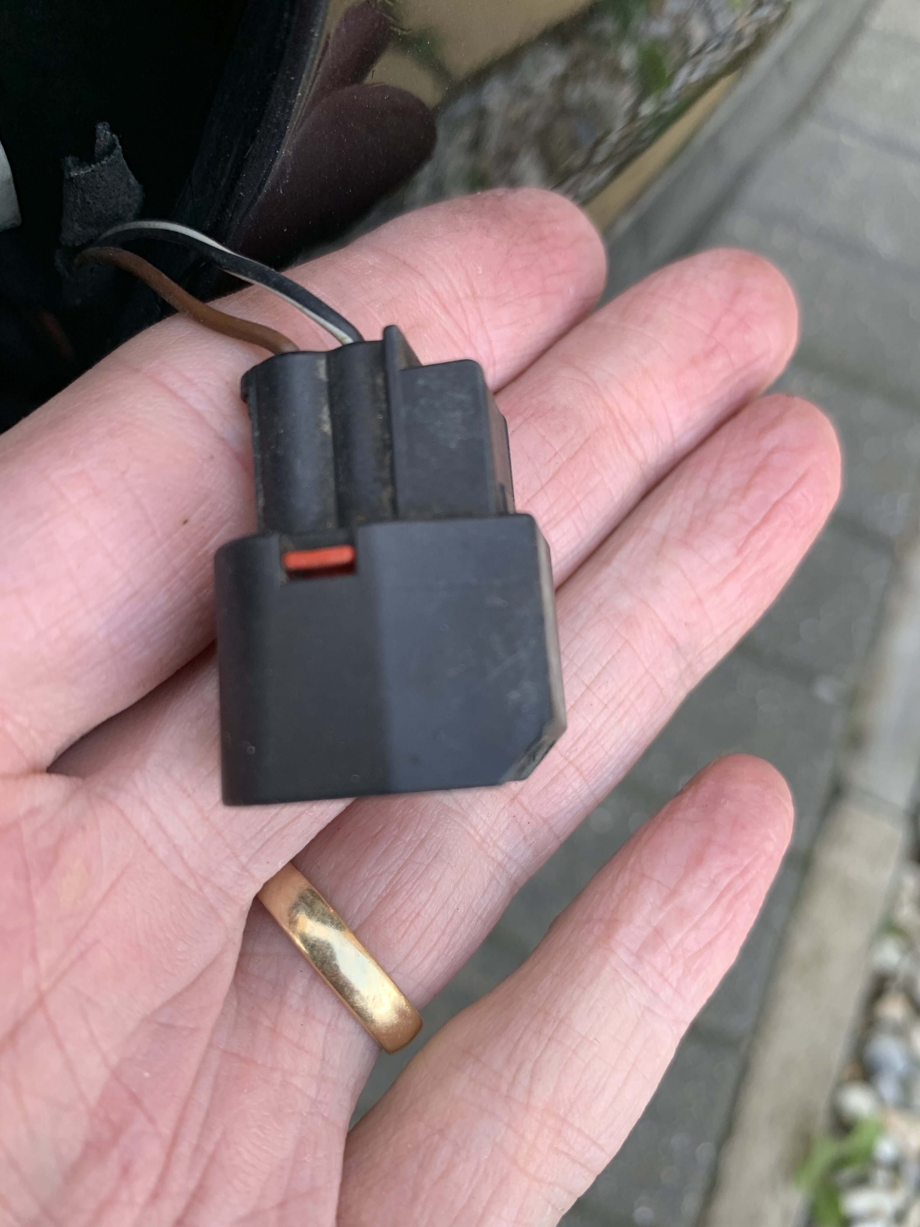

Good morning CS,
The 997 has been throwing an indicator fault randomly yet every time I got out and checked it was working.
After it trolling me for a couple of weeks, I’ve ascertained it to be the front left turn signal, more notably the wiring.
Wiggling the brown cable will cause it to go in and out of fault.
Naturally I can’t find the loom anywhere or the part number, and if I do, I’m sure it’ll be a few hundred….
So, is this re-pinnable ? How do it remove the cables and pins from the socket.
Thanks
Good morning CS,
Thanks
View attachment 1655441View attachment 1655444View attachment 1655445
Try popping that red tab out and the pins might slide out but might still be held in with wee prongs on the terminals you can get cheap depinning tools on fleebay
Cheers for the response, fixed it today.
Pulled the white connector with needle nose pliers as its a locking mechanism, then used a two screwdriver combo to release the pin - tha wire had snapped so had to release it with one 'driver and push with another.
I now have fully working indicators again.
