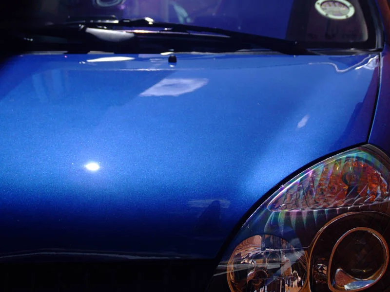

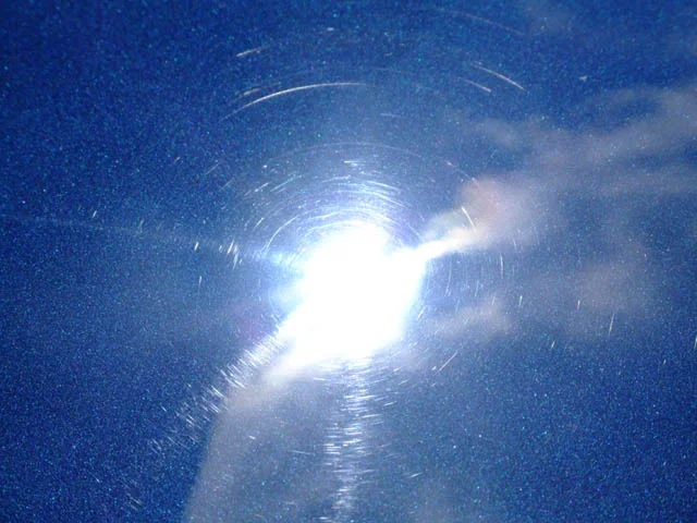

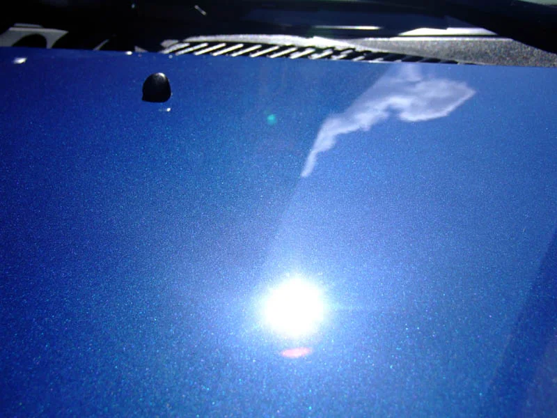

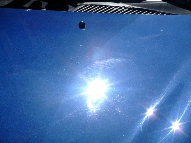

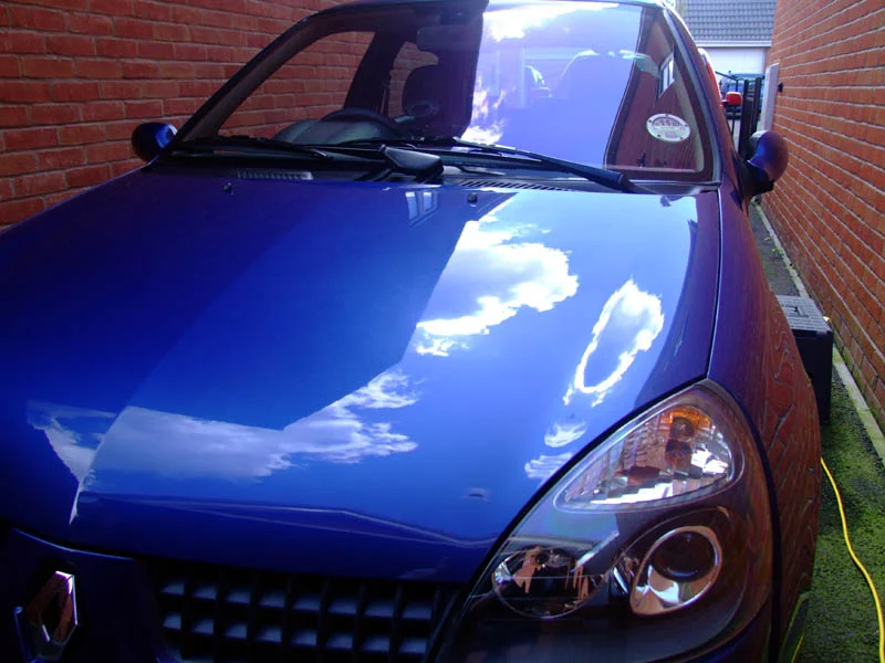

aceface makes a good recommendation with the Menzerna products.
With the pc I went from first two defect pics [badly swirled] to following three pics [no swirls!] just using the Final Finish polish [mild]
:D
