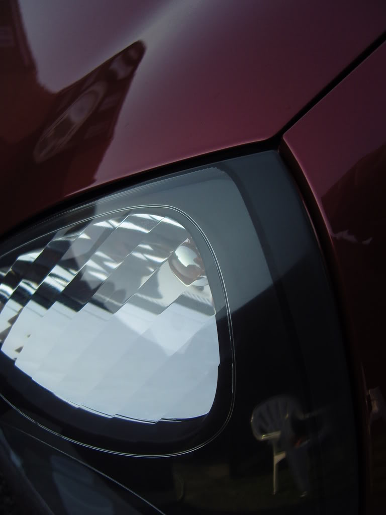

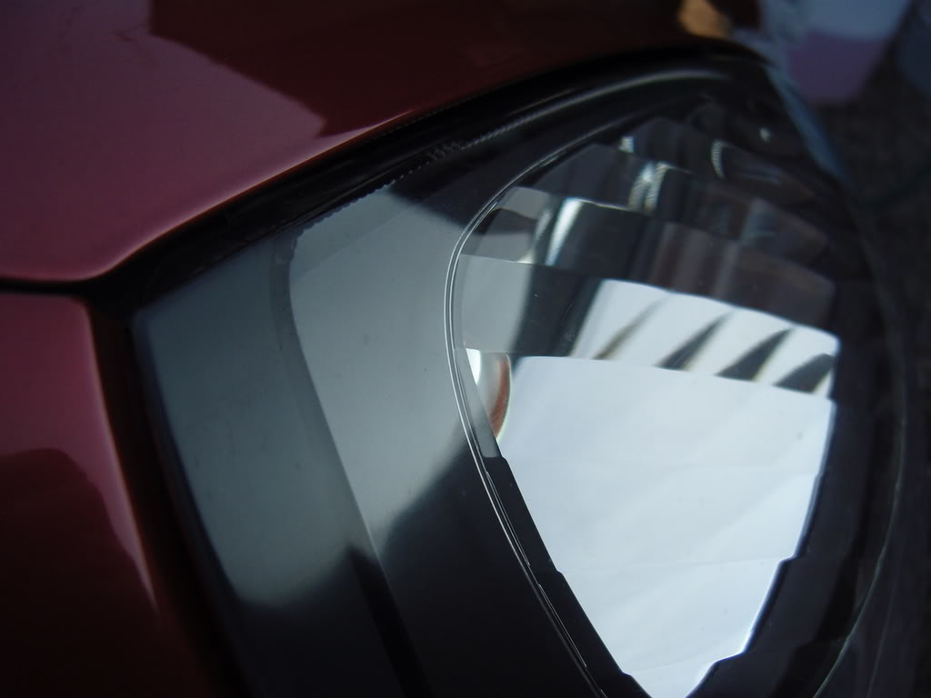

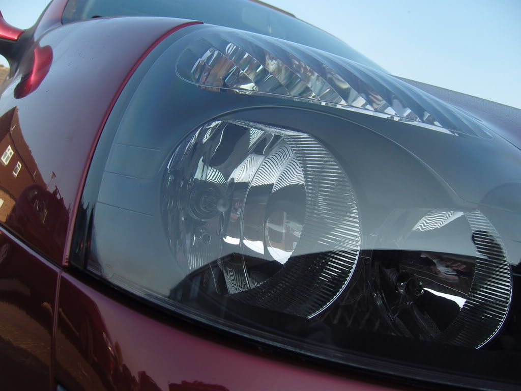

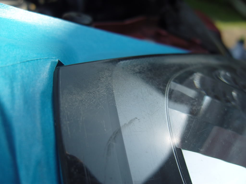

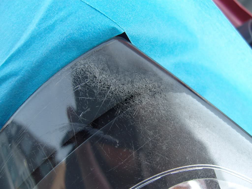

Dave (DH182) popped over this afternoon for a correction on his headlights.
They werent in the worst condition I've seen, but I can see why he wanted them doing!
Here are a few pics.
Before:
After:
Great meeting you mate and hope you are happy with the result.
For those who want a bit more detail, I used:
Meguiars Unigrit - 1000, 1500, 2000, 2500, 3000 on Meguiars Backing Pad.
DAS-6 Dual Action Machine Polisher.
3M Perfect-It III Polish
Menzerna PO 85 RD 3.02 and PO 85 RE 5
Menzerna 4" Pads - White (cutting), Orange (polishing), Yellow (finishing)
Tropi-care TC-5 Detailing Spray
