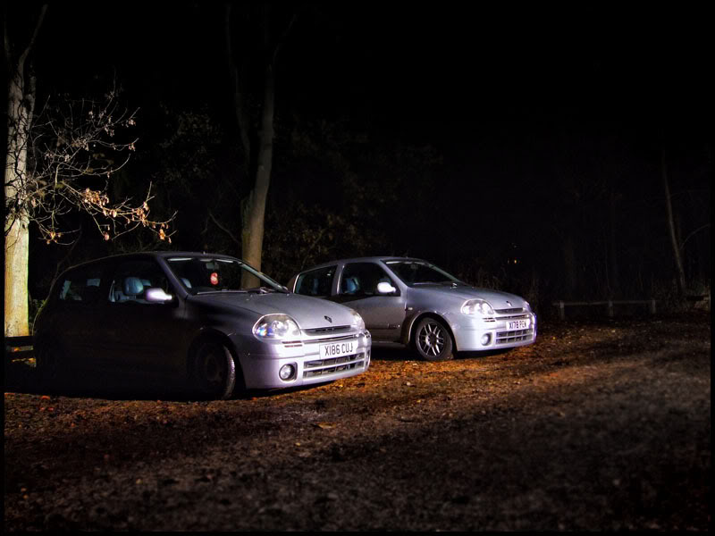

Keep up the good work, was actually going to buy a silver ph1 next week but the dude has put off sale for a while. :(
Could have turned the twins into triplets tbh!
