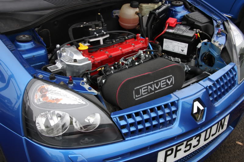

And how much bonnet clearance do the Ktec's give on a ph1 with 90mm trumpets and a decent filter setup that has a proper clearance from the tumpet to the filter? ;)
  A shed
That I dont know, and fair point. All i know is that 90's with a proper filter with proper clearence fit on a phase 2 no problem, and if youre willing to hack away the inner skin of the bonnet (which people do/have done) then apparently 120's fit with a proper filter as iceman? did it on his endurance car (or so im led to believe, i think bigash saw it so may know better) which would give a 300mm total length

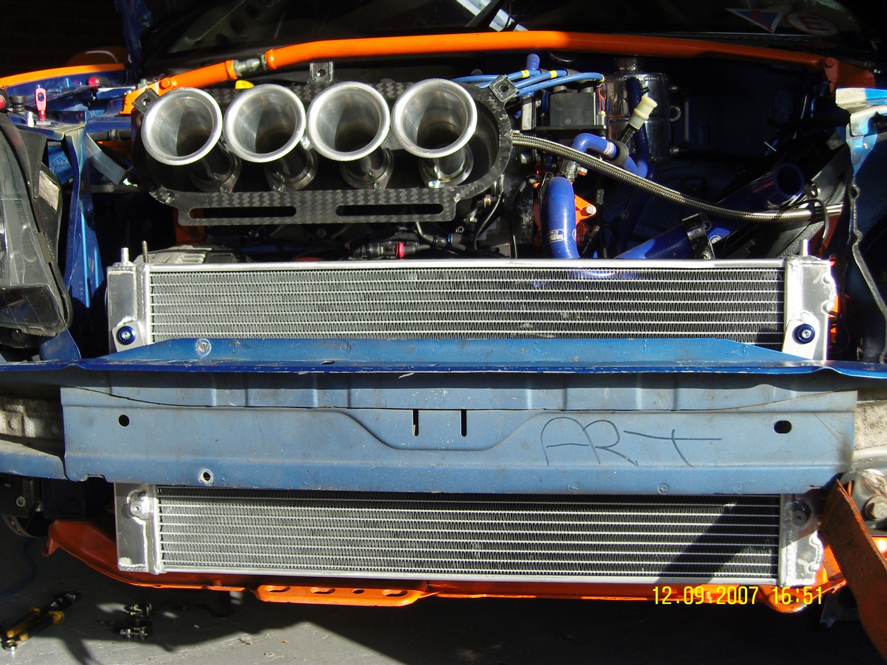

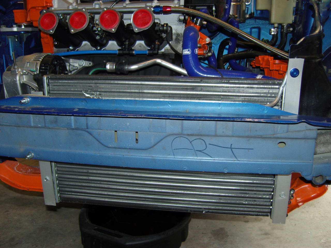

The angle of the KTR kit is daft. If they'd just designed them to be 10degrees further down you could get proper trumpets on it

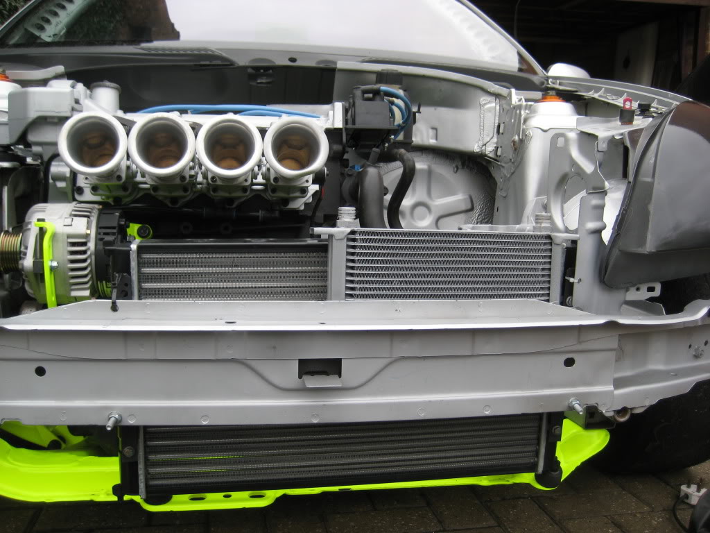

SF's for comparison
He did get 120's on his DTH kit yes - with a gutted carbon fibre bonnet
You can see just how much higher they are than the slam

But he's running the same carbon backing plate and filter as mine - there's about 10mm around the trumpets and around 15-20mm in front of them. The sausage filter is huge

They look too tall for that backing plate, were they not practically touching the filter?
should be no worse/better than any other 120's with a backingplate and filter surely? think it might be a trick of the eye with the photo.

The filter on mine was pressing against the bonnet - so I know for a fact on a DTH kit it wouldn't fit as they angle up about 10 more degrees (see above pics)

You can see on that pic the advantage of the SF's if you don't want to arse about with spacers. The 120 trumpets sit about the same height as the original slam panel, so as you've said other than the 2 studs you don't have to chop your bonnet.
Compare it to icemans pic with 120s, they sit about 15mm higher than the slam panel

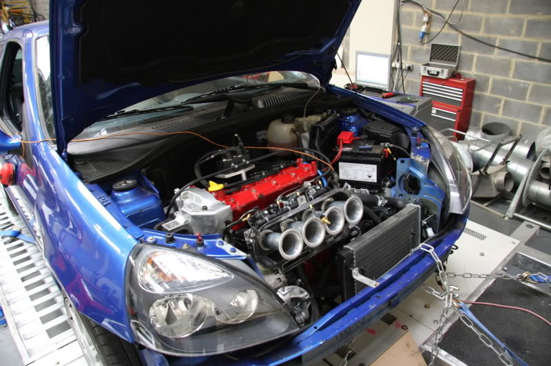

I suppose you could get the DTH's machined at an angle to lower them a bit
