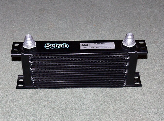

Throw an oil cooler in there for banter:
