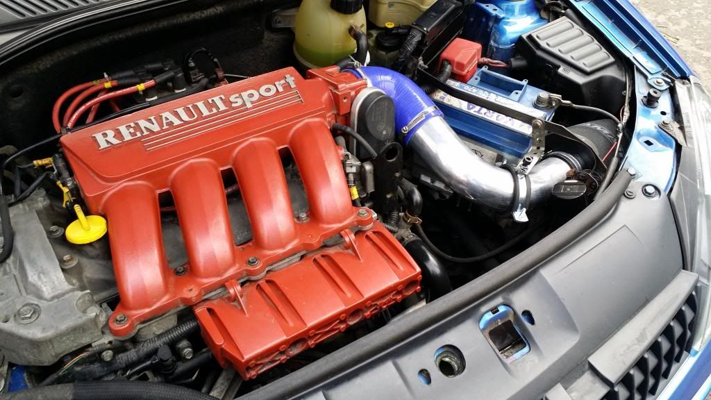

Then we both decided to do the same IK setup, something like the k-tec one, but with a combination of silicone and alloy instead of full silicone ended with a Ramair 70mm filter at the end.
We decided to add the new setup to the silver clio and then repeat the test. Here's how it looks:
We went for another drive to see if it gained something else beside the noise (which is mental!)
So we were basically neck in neck now which proves that this setup is better than an open cone near the engine like it used to be.

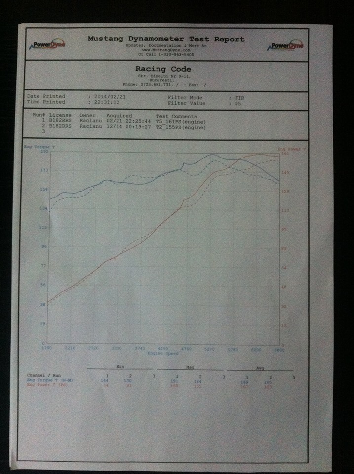

update:
the silver 182 went on the dyno today and it pulled out 6 bhp more vs the old Green intake setup:
The blue car also received the same intake couple of days ago. Now we're gonna repeat the road test to see if I also gained over my old (BMC CDA) setup and then probably another dyno run

and the old vs new dyno graph:

finally got out again and the results were a bit unexpected:
The BMC CDA setup is pretty good actually as I didn't gained any from fitting the diy kit beside noise.
Anyway will sell the BMC to get some profit. Still the diy k-tec style remains the best value/money/power gain kit over anthing I've seen so far.
I for sure recommend it!
