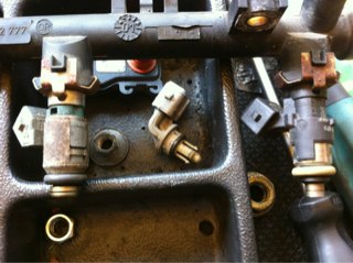

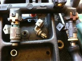

Looking at why my car isn't idling right.
Turns out there are different injectors in it. 3 magneti marelli ones and one Bosch one (on the right)
I check parts site and with my reg it comes with these same two options for injectors.
Is it okay to use a mix or should they be all the same?

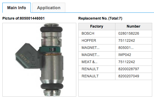

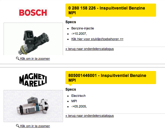

​It's these two:
Magneti marelli seems to be the original one with part number 805001446001. And the other one is a Bosch 0280158226.
A little research with those numbers shows this:
So it seems that it's a replacement part for the original one? Can anybody confirm?
As with Danny, i've only ever seen the Magnetti ones. They're cheap enough second hand, get it swapped over.
