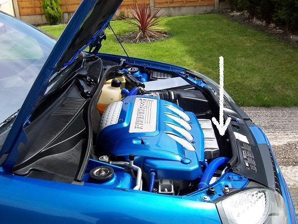

No mate, it's not under the engine cover.
It's beneath the fuel rail cover (the rectangular aluminium bit at the front of the engine)and is a bit tricky to get at too.
Look under the fuel rail cover from the right hand side and you will see it.

yeah its right down the front of the engine below the injector guard, its best to do it when the car's cold

As said .Under the fuel rail guard :
