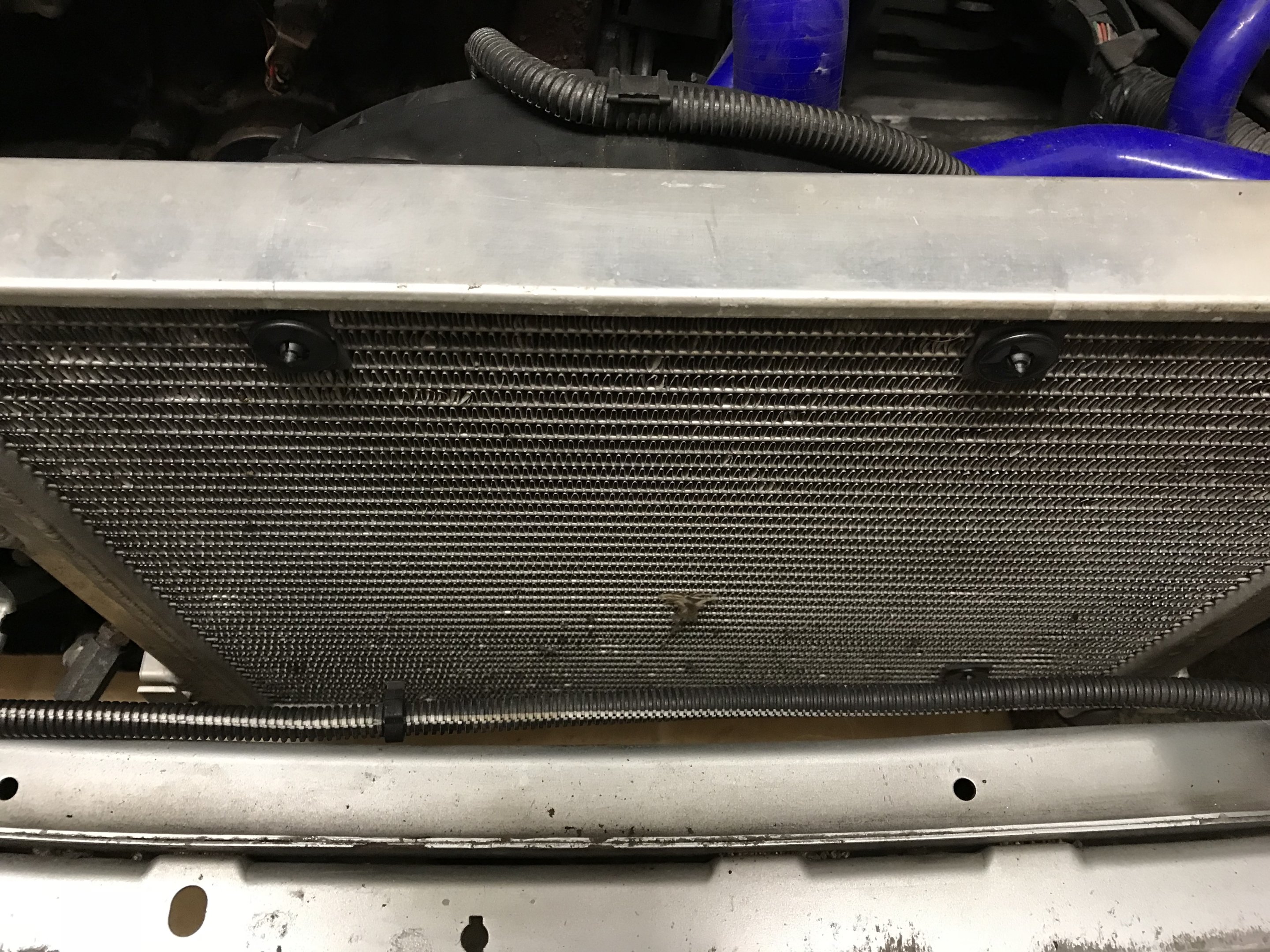

I have a direnza rad fitted to my 172.
I have mounted mine with a similar kit to the one in the links below.
View attachment 1352609 https://www.carnoisseur.com/products/details/revotec-fan-pull-through-kit?gclid=Cj0KCQiA7dHSBRDEARIsAJhAHwjhuLAfDtz4U42wUWAsdFkQRVhhWoV1CmeQPS2iJW103wDoM5fSnAsaAkUREALw_wcB
I have seen these however wanted them to be my last resort! I would rather mount with bolts if possible however I do fear most have used ties.
After playing around with my car today I found out that the Direnza rad has mounting points for the original fan, really easy to fit.

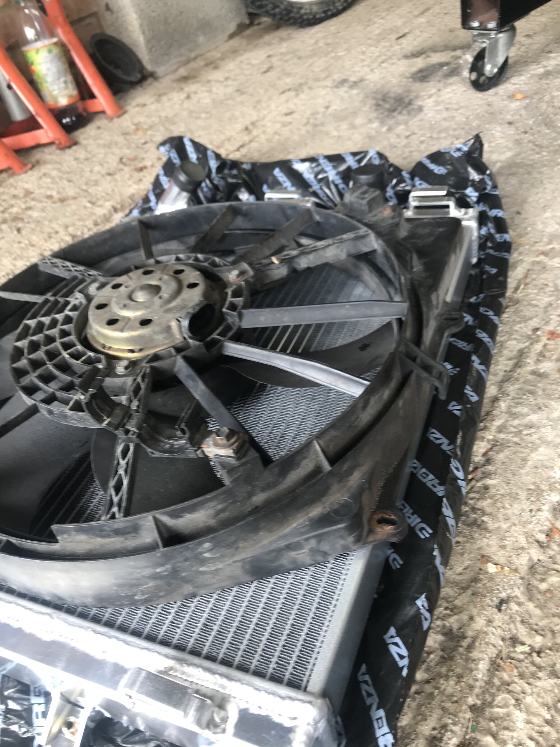

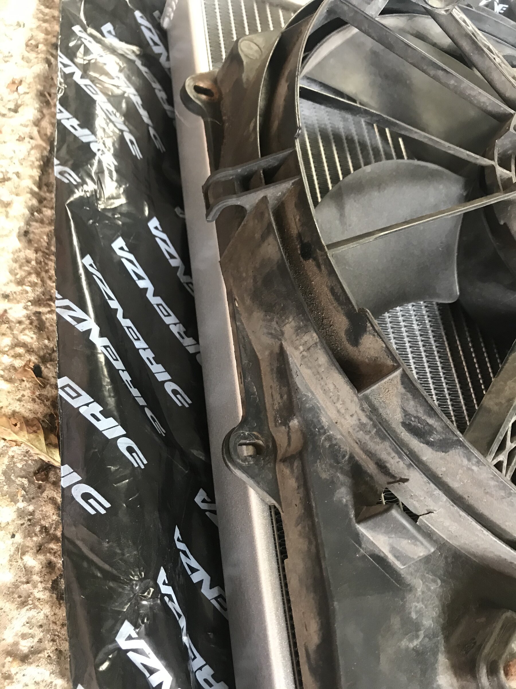

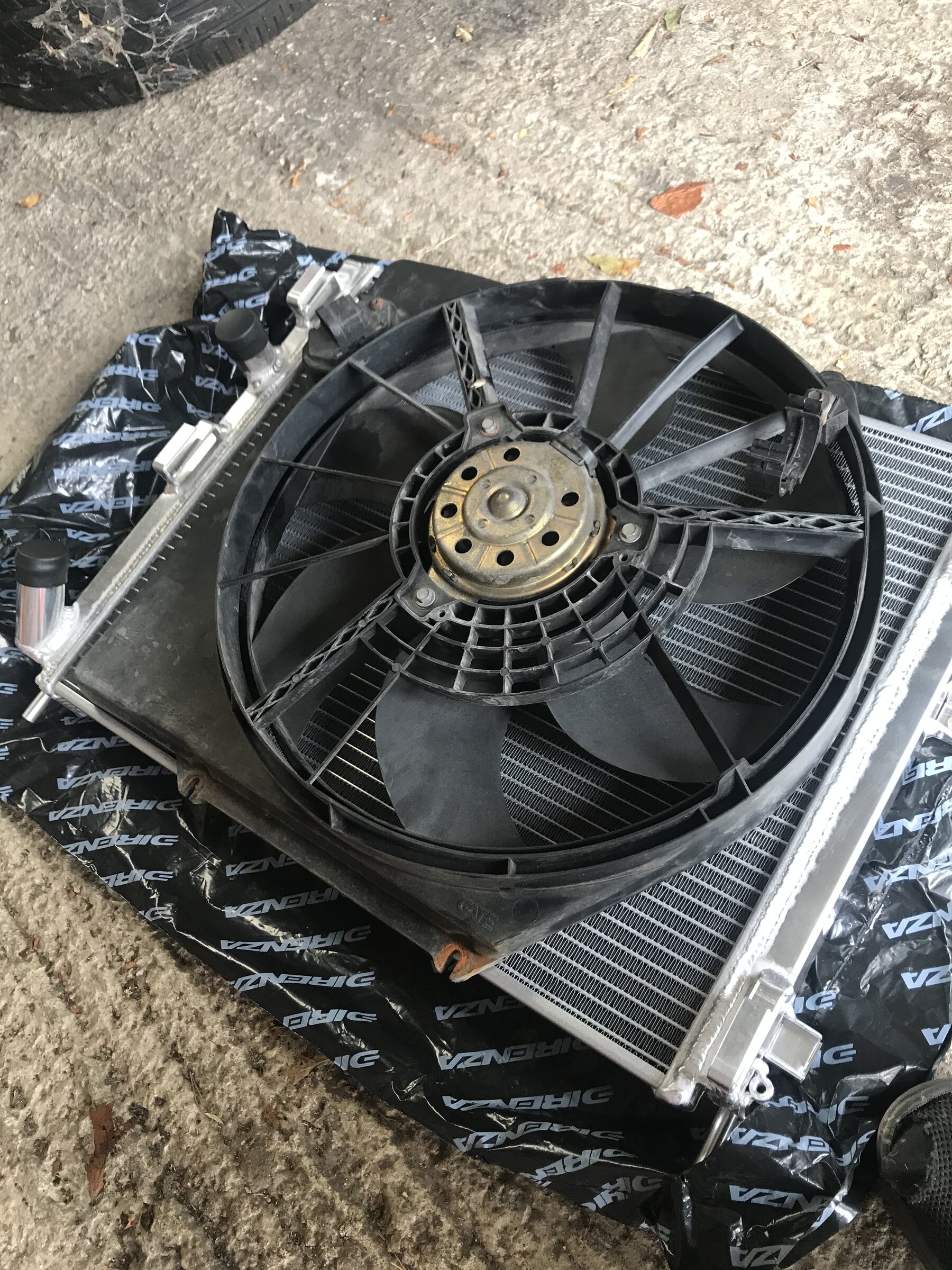

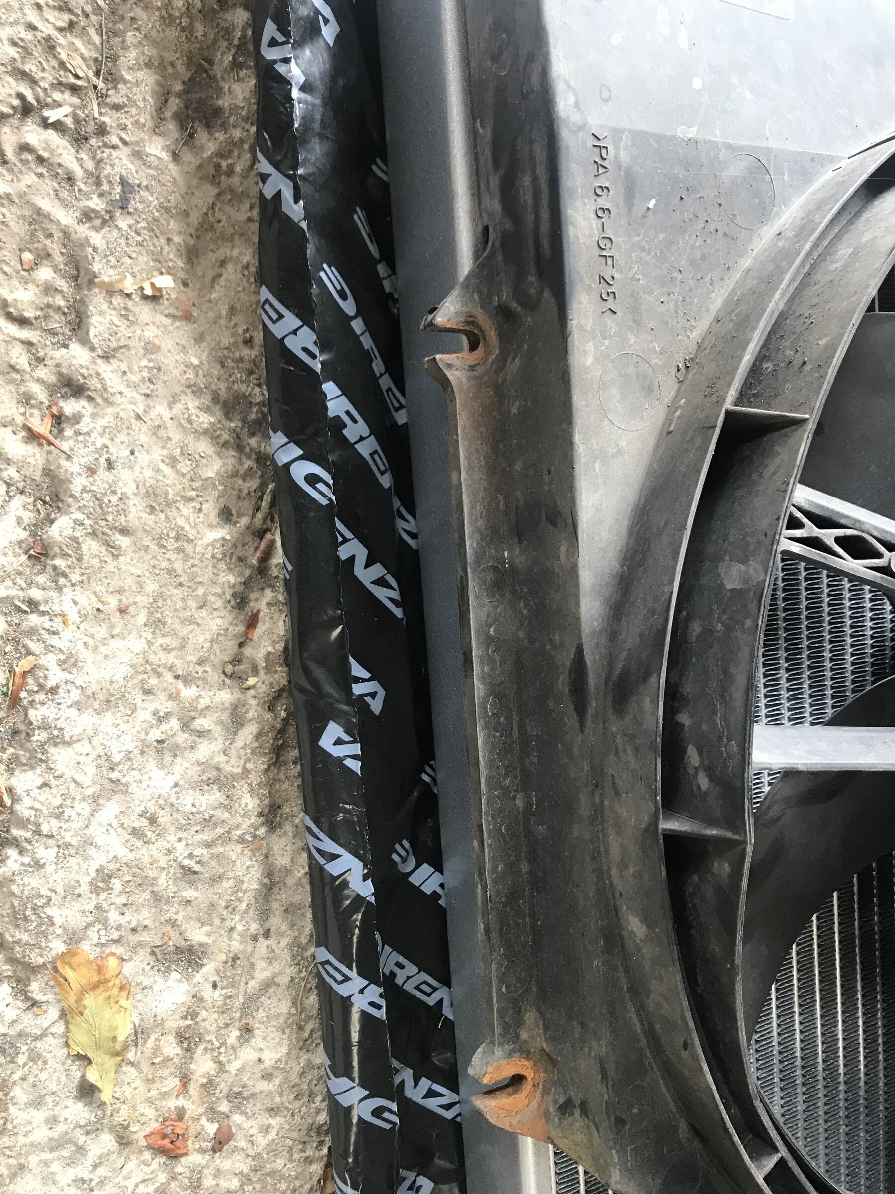

Sorry for the thread revival but how does the fan mount to one of these rads? I can’t for the life of me work it out, unless I need to order some extra hardware to fit it?
On mine it just slotted into the tabs.
Was really easy.
I’m assuming I may have a non cup radiator? It just doesn’t fit lol

My rad looks like that but my fan housing has tabs which slot into the 4 metal hooks.
