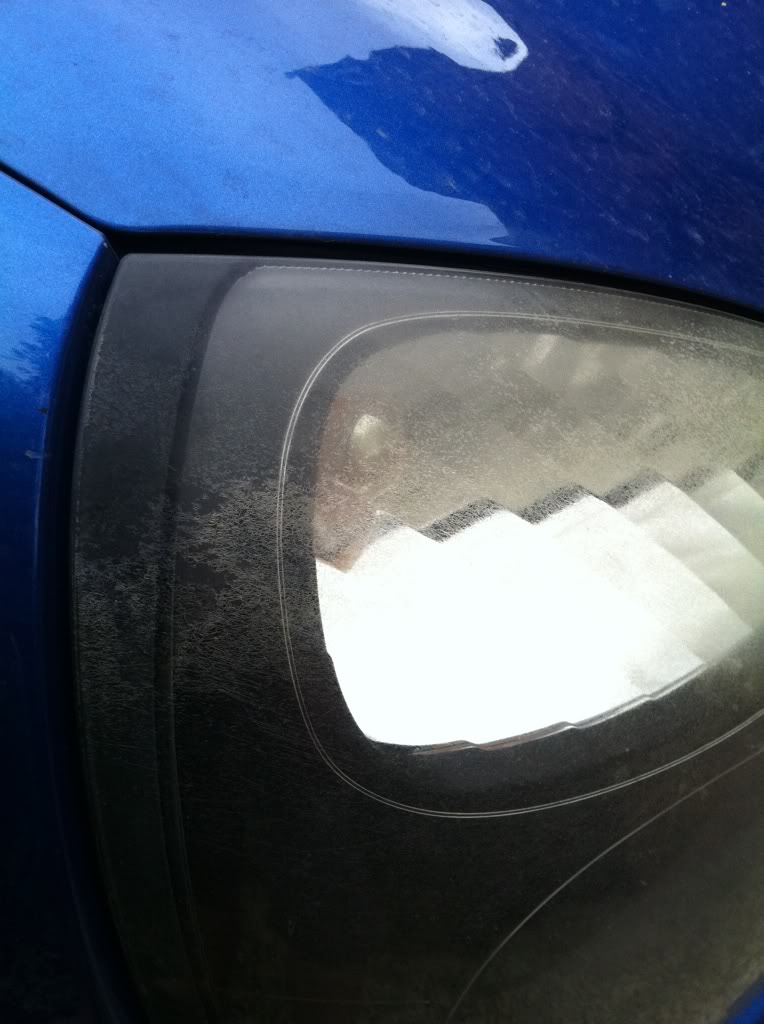

my clio mark 2 phase 2 52 plate healdights have what looks like limescale on the inside
anyone else have this issue / solved it?

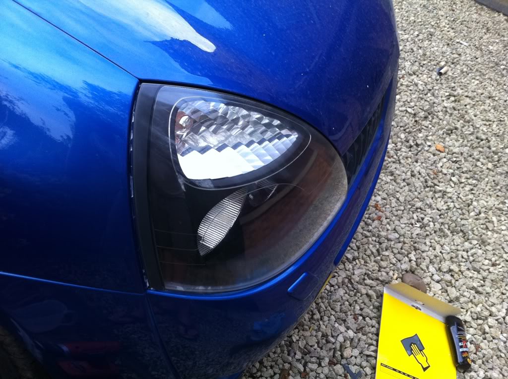

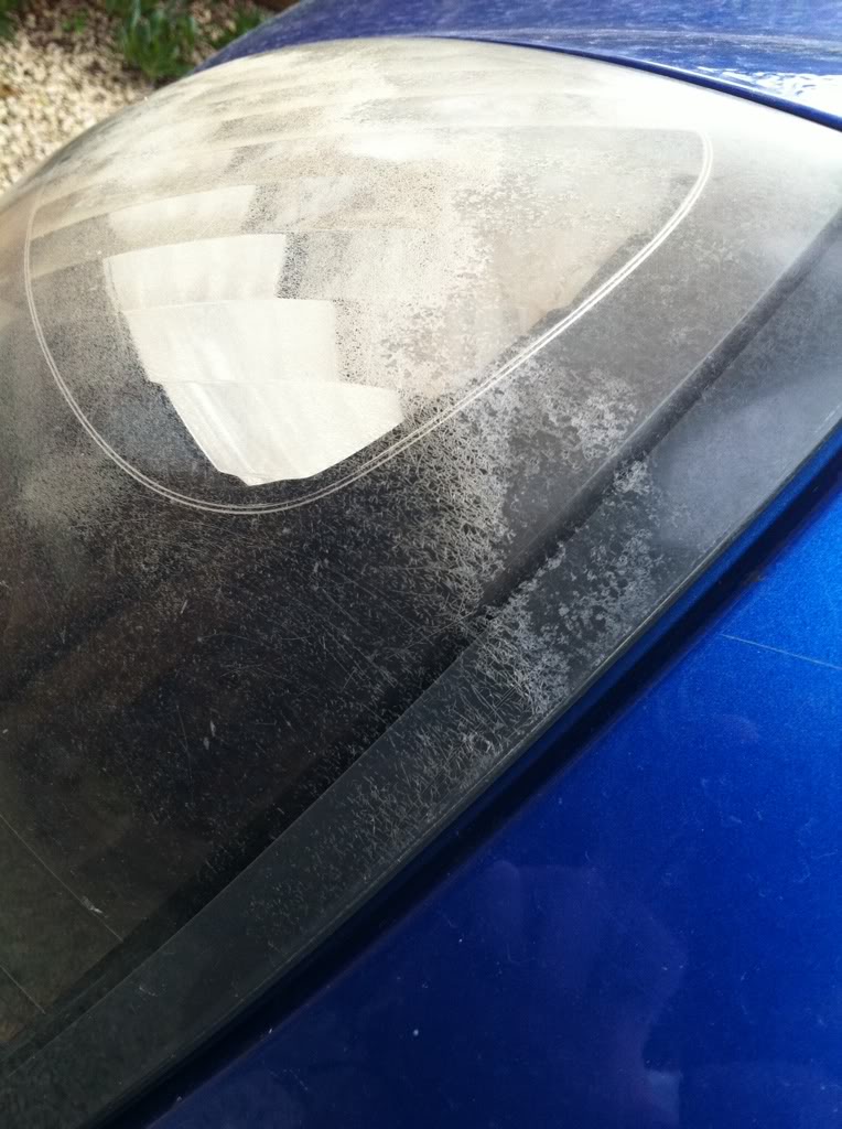

Here are mine from today.
Before

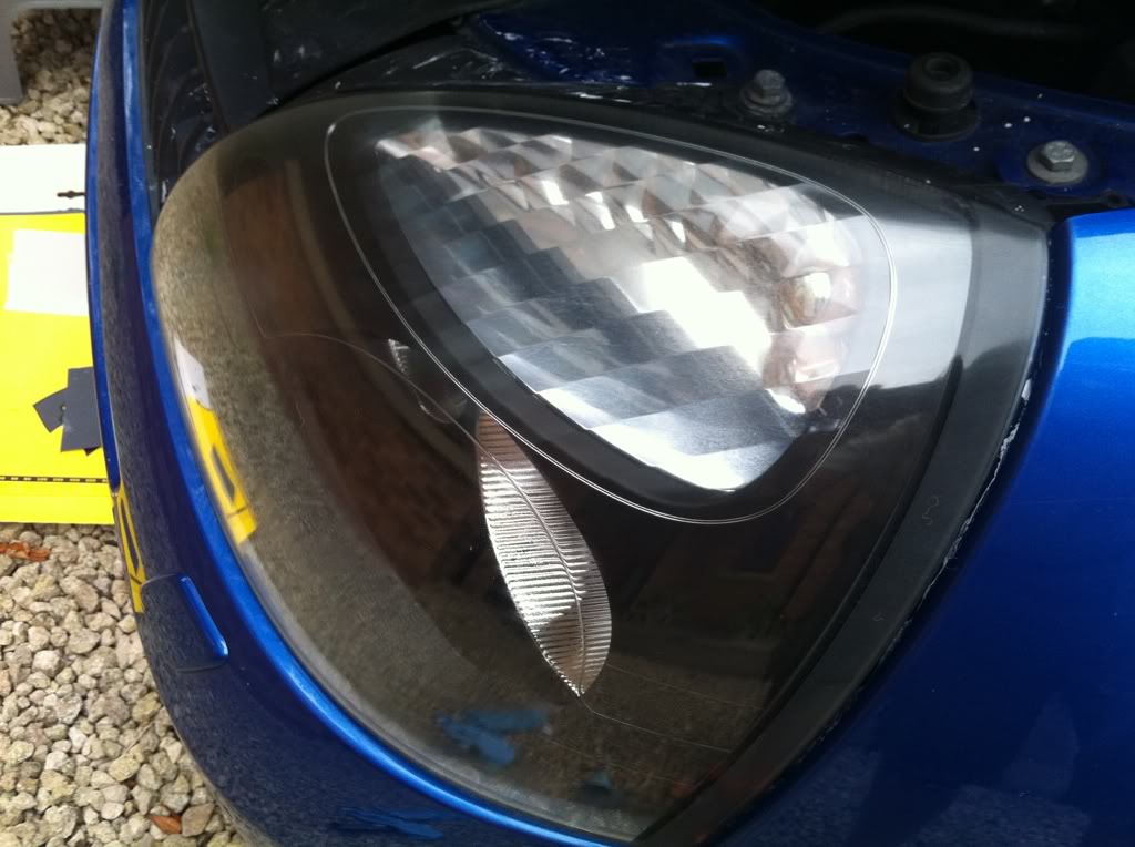

After
Started with 1200, 1500 then 2000 wet dry followed by megs on a pad attached to a drill worked much better than expected to be fair.
Thanks cs for the guide parts cost £25 and took less than 2 hours.
