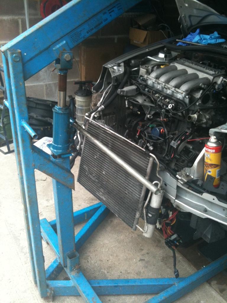

B barnesautos Car 172 Ph1 Apr 1, 2021 #2 No need to disconnect the a/c , it will swing out the way in the drivers side . Sent from my iPhone using Tapatalk
B barnesautos Car 172 Ph1 Apr 1, 2021 #4 Bluesky50 said: and leave ac pump in car, makes sense Click to expand... Yes , disconnect it from bracket on engine and let it hang supported [emoji1303] Sent from my iPhone using Tapatalk
