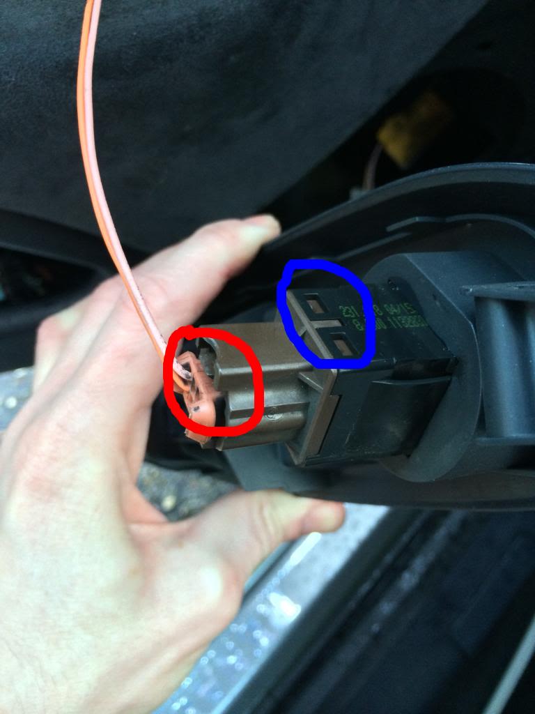

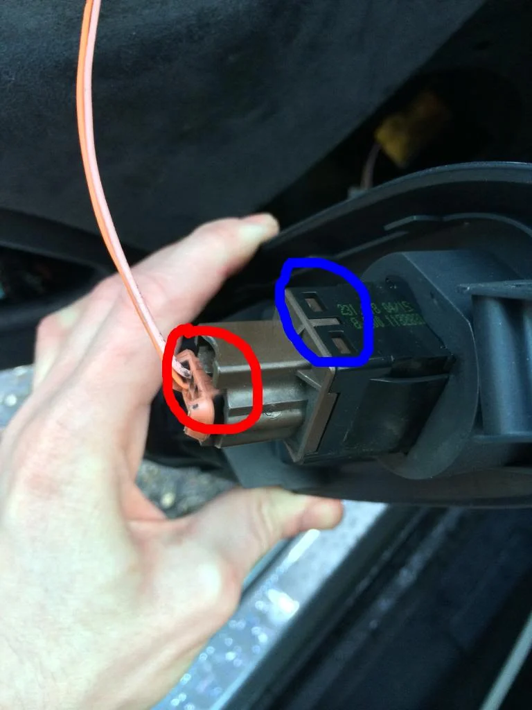

Hi just a quicky, trying to remove cards atm... when it comes to the passenger side what do I do here?
I'm following a guide but it's from a Ph1 so no air-bag is mentioned? Just wondering if I need to disconnect the battery first and I presume it's the red connection here I should be releasing not the blue?Cheers...

yup, the red. give it 30 mins with the battery disconnected.
mind you, in theory if you switch it off first and then unplug it you should be fine? i always err on the side of caution though, especially after a saw an airbag go off on a mate when he was being impatient;)
