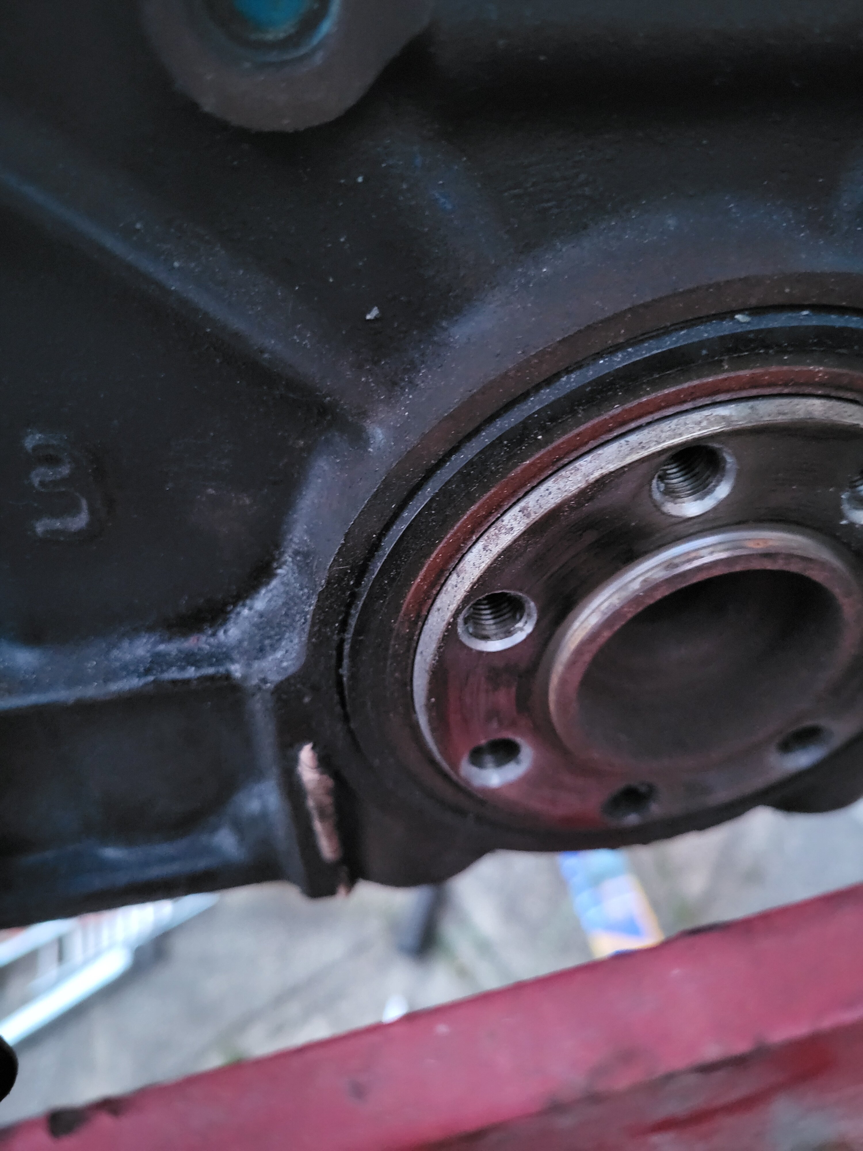

I'm really on the fence about resealing the rear (flywheel) crank seal.
I know it's a common leak point and people recommend doing it, but on the other hand this is all the leaking it's done since new (1999) so I'm not sure if it's better to just leave it than disturb it.

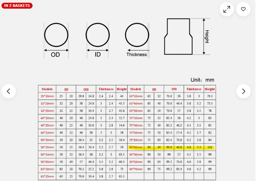

I've used a piece of PVC pipe to put them in before. Doesn't knack the seal, can't remember what size it was because it was from an old pump housing
Personally I'd do it, just because it's peace of mind. Like Brigsy said, there's a proper tool so you don't make a hash of it
Seal is 85 x 105 x 8 i think, so something around that diameter should work.
I assume this is ID/OD? Looks like you could probably use something like this (ebay special) as long as you can make sure you don't smash it in too deep.

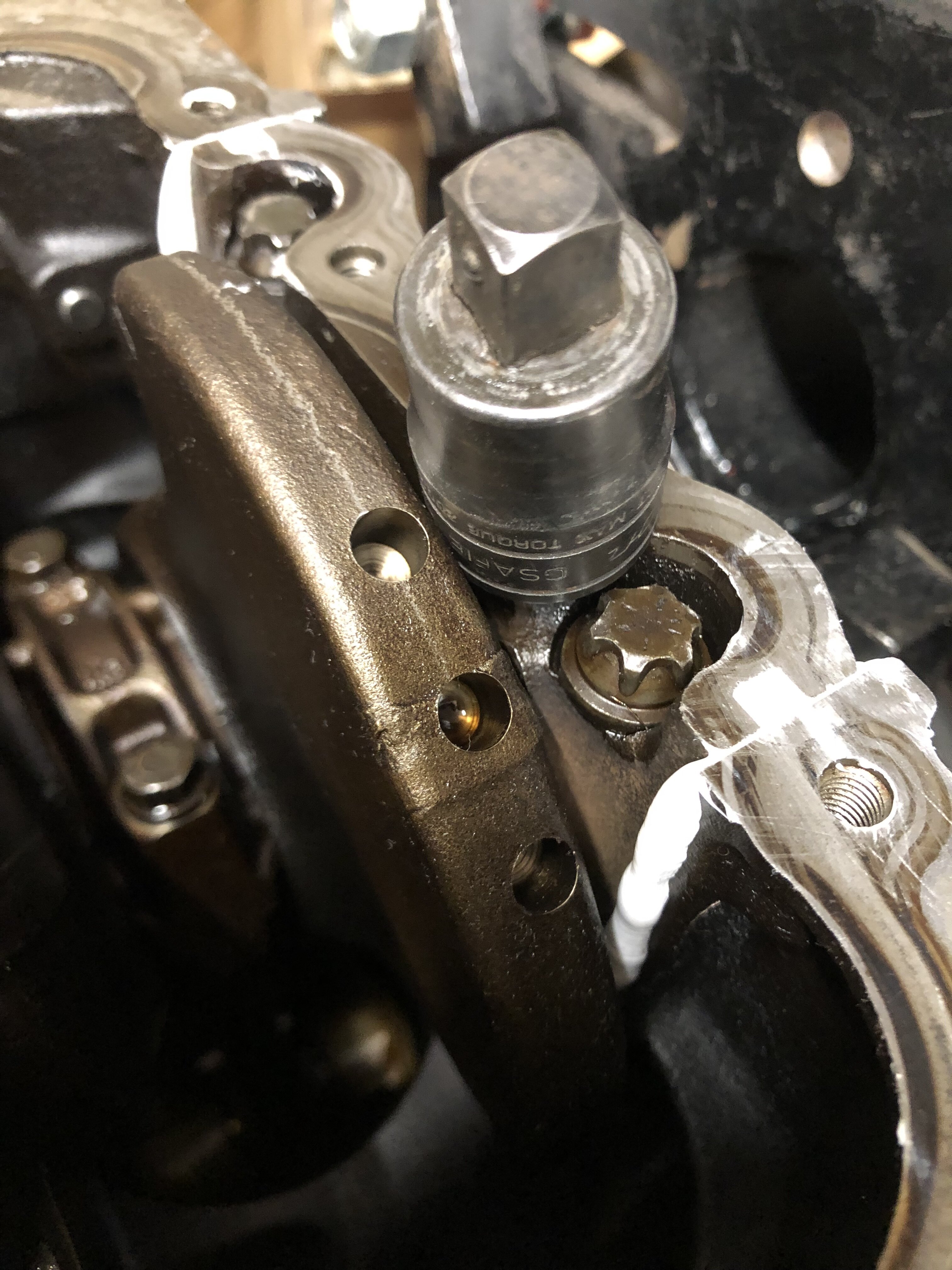

I slacked the bolts off and couldnt get them done up again! (f**king e-torx!) so I've ordered new bolts there too.

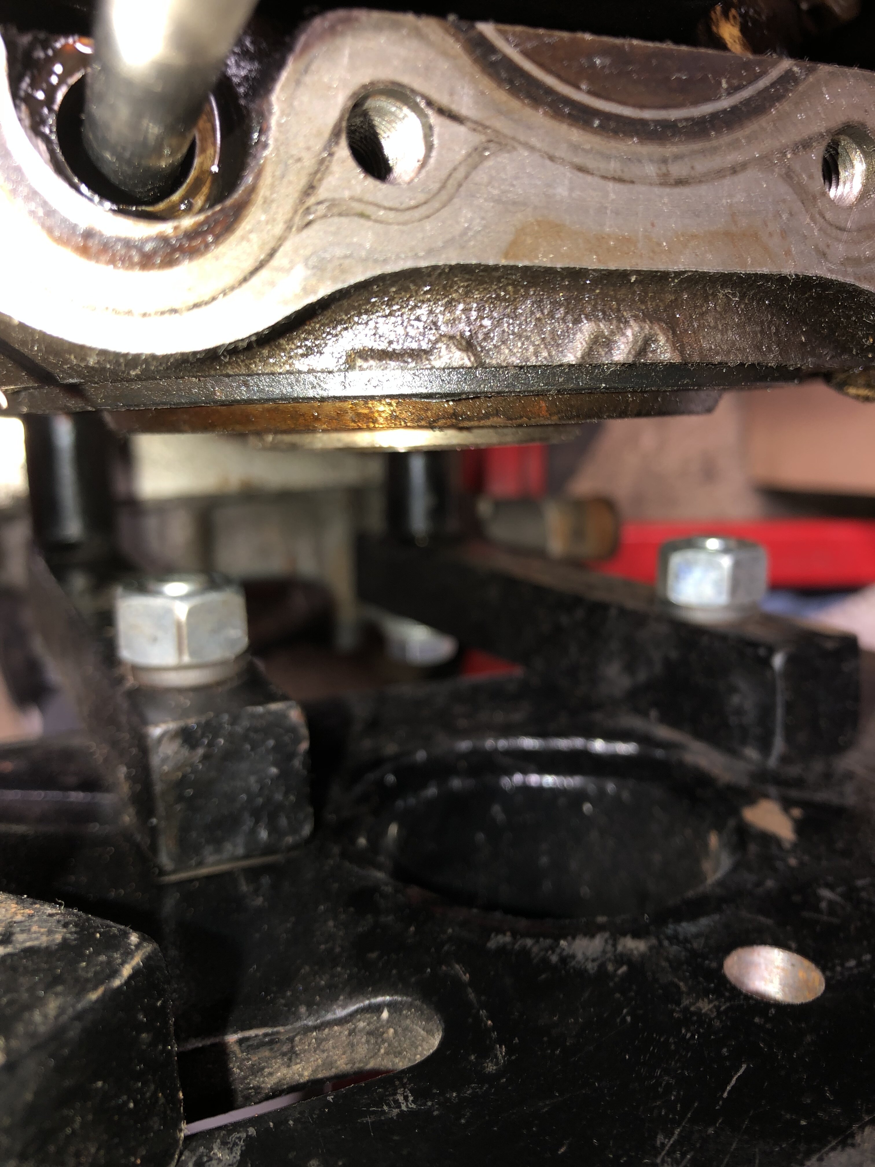

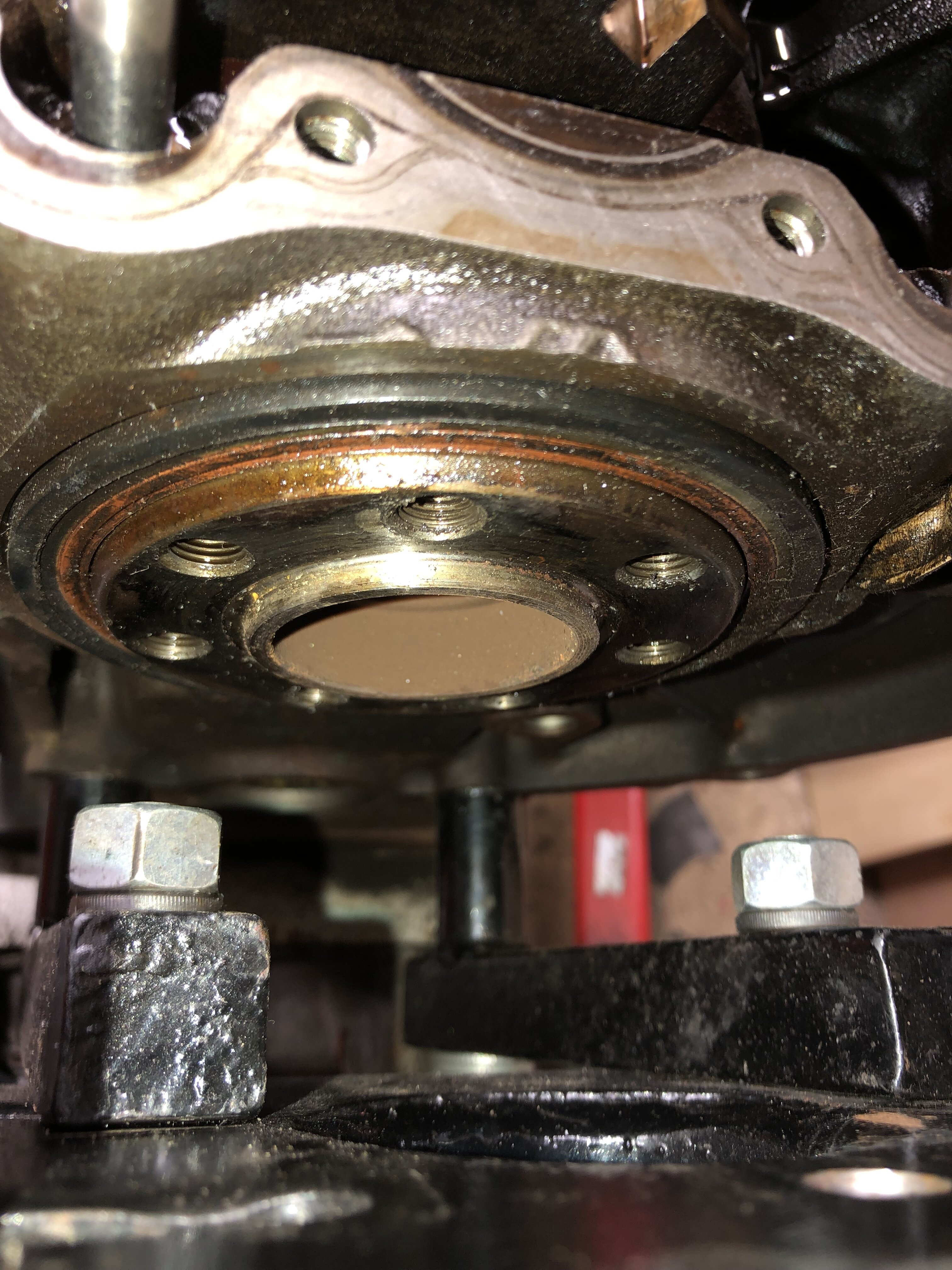

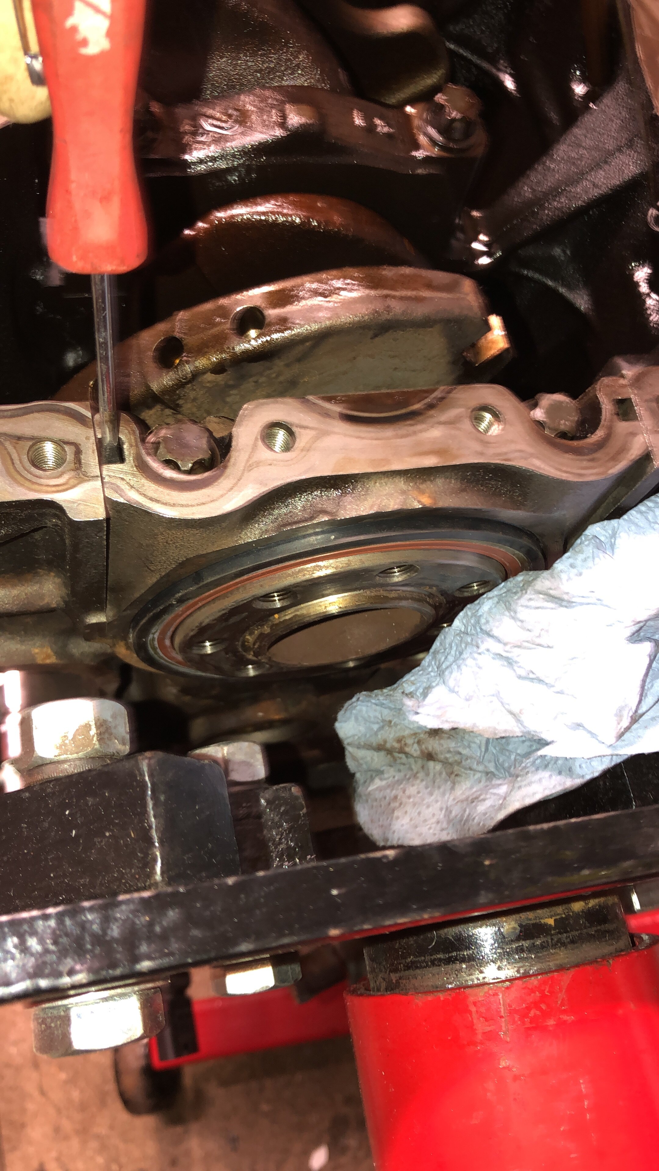

Here’s how I set mine up.

Much better trying to get the seal tool for anyone wanting to do it, yes you can use a piece of coke bottle etc to help it onto the shaft but the most important part of the tool is that it sets the depth correctly.
