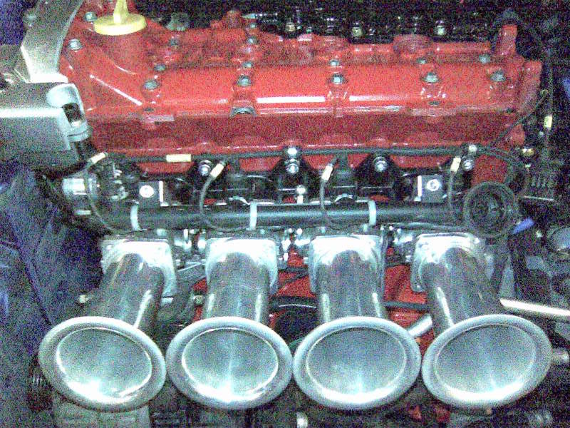

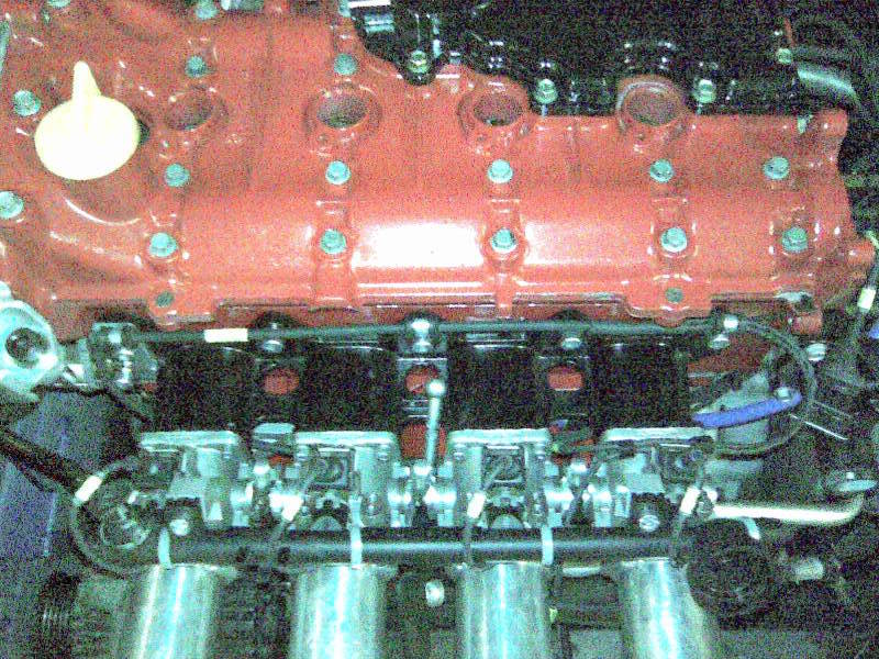

I made a custom loom for my ITB'd Track car on an OMEX 600 ECU! Cant quite remember the price but i recon it cost me under 100 quid to make.
So my ECU is located on the inside the firewall below my Mk1 Clio Dash!
You can literly not see any of the wires in the engine bay!
Measure twice, cut once!!!
Indeed, very tidy work. you need to contract yourself out mate.
