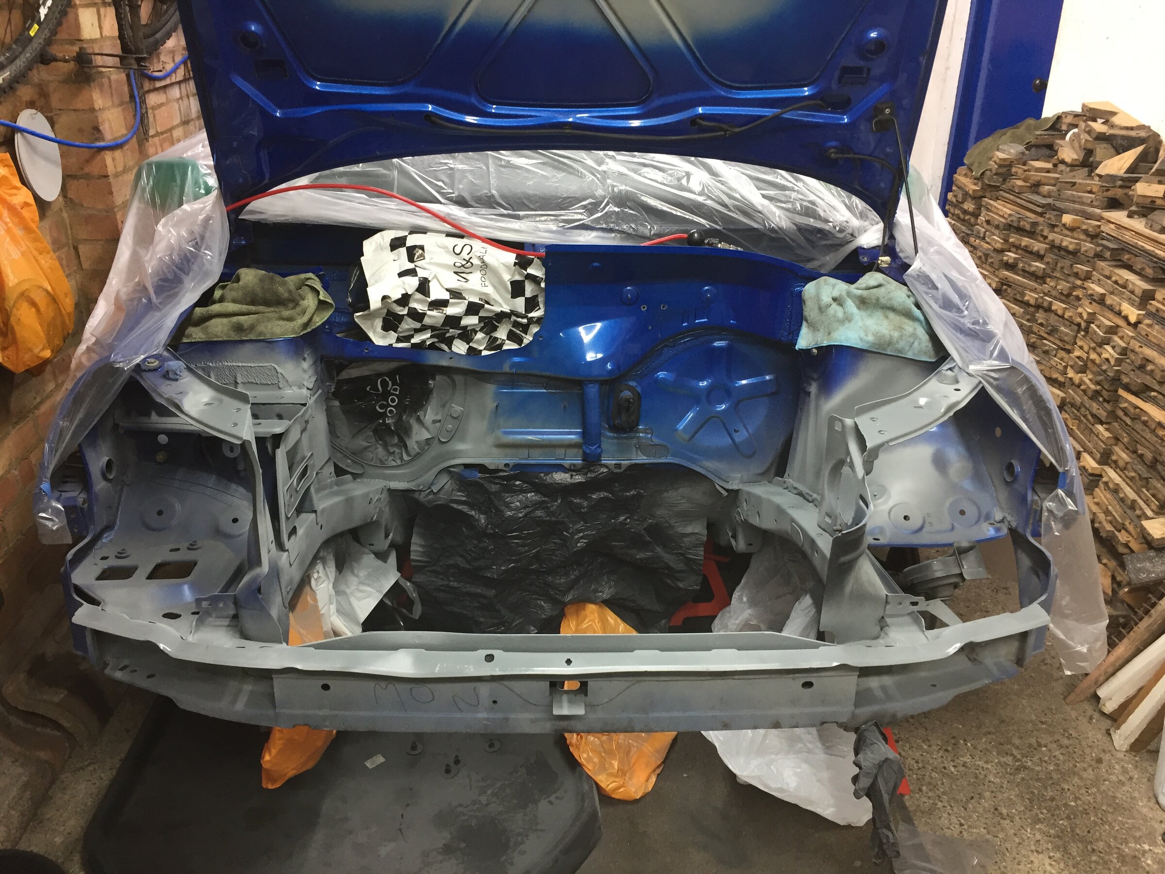

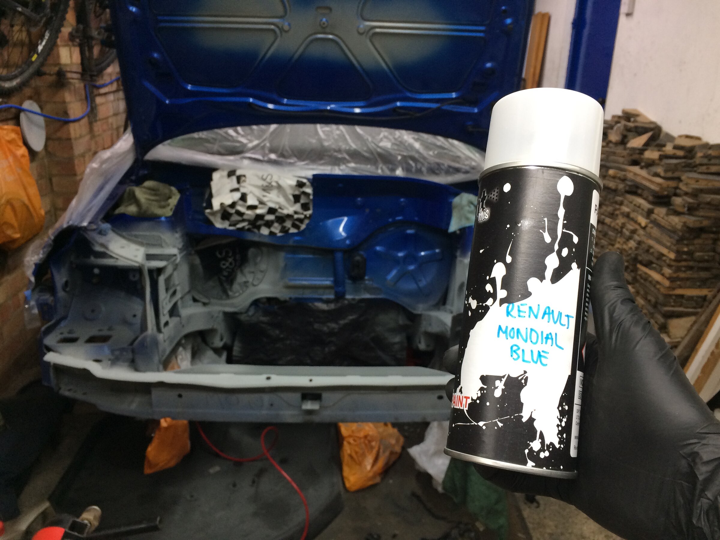

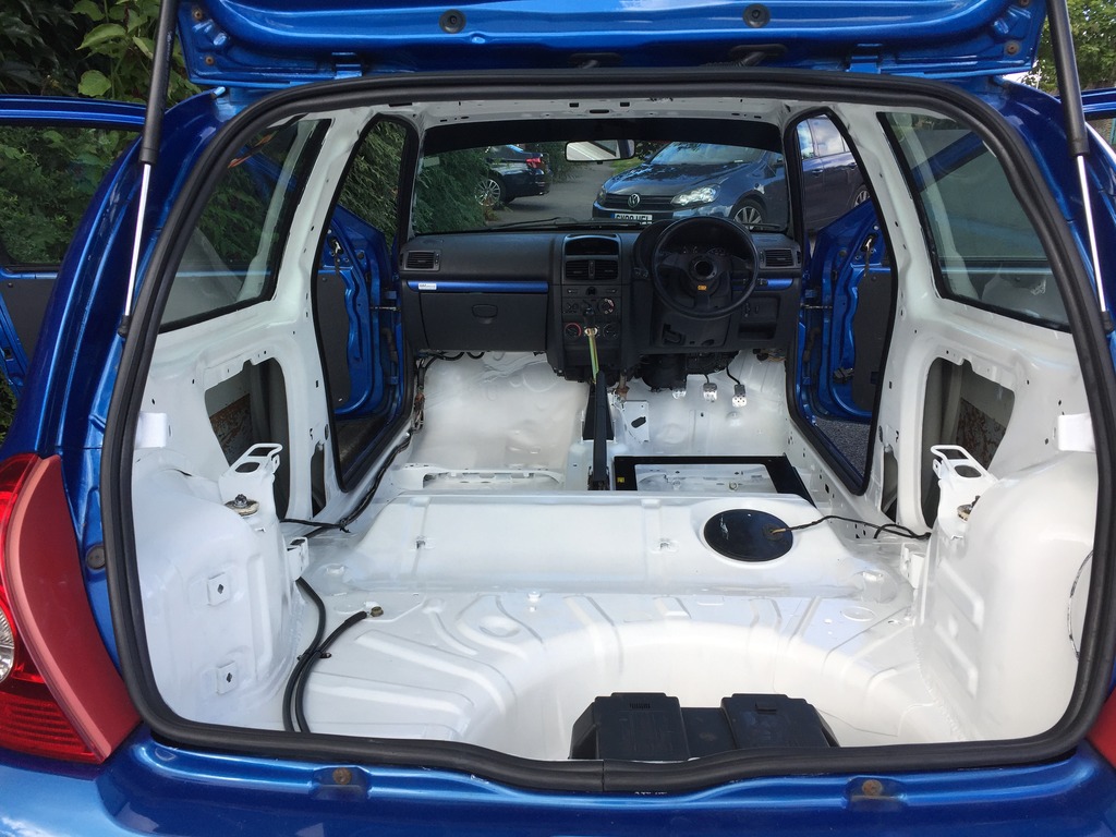

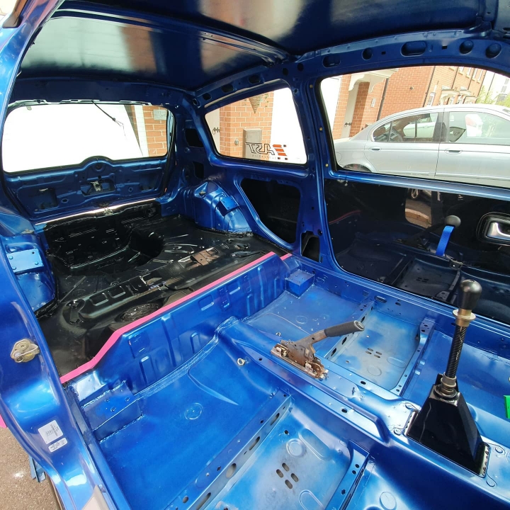

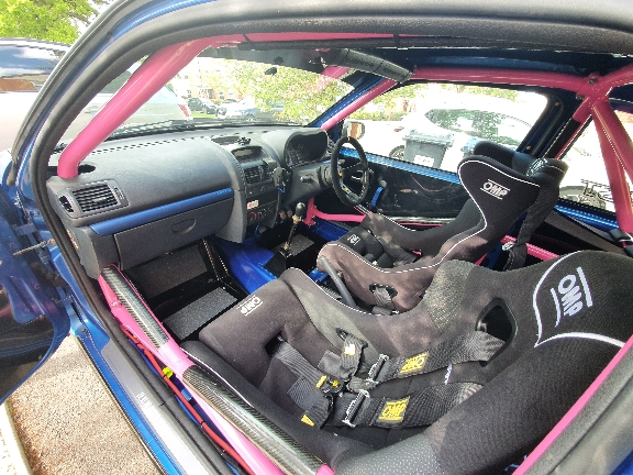

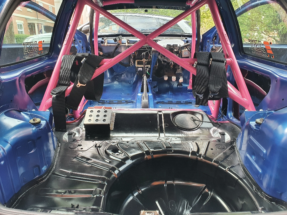

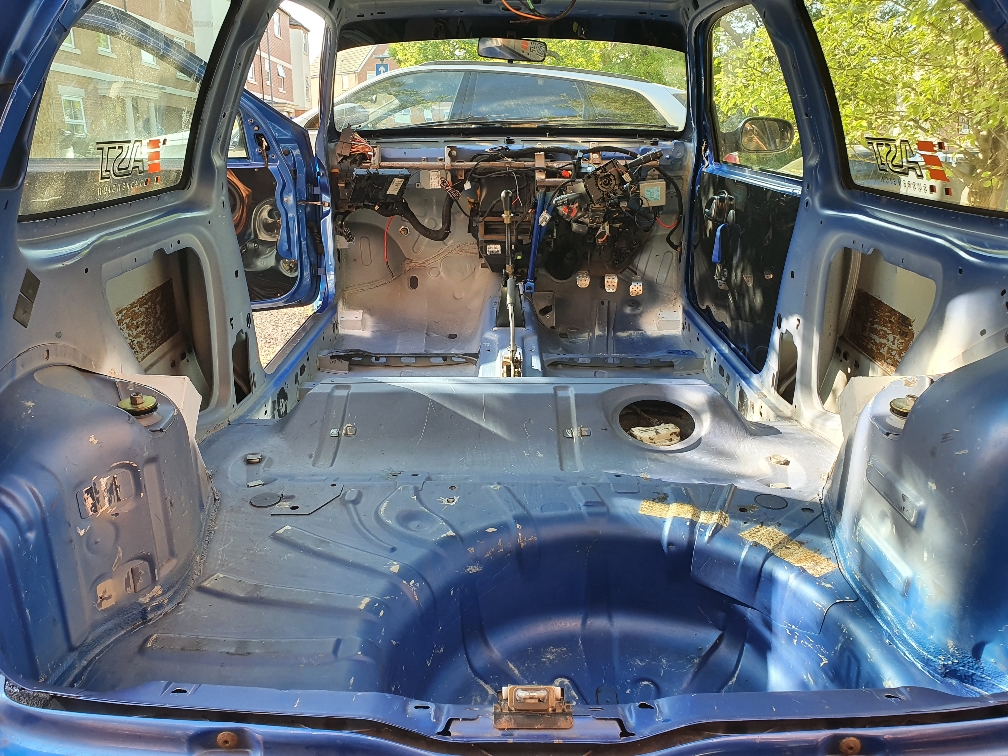

How long it lasts will be another story.. All i did was Scotch Brite everything and panel wiped it then blasted 6 big cans off Mondial over and 6 big cans of Clear coat.. I ran out of blue and just did the rear floor gloss black.. End result looks fine, not perfect but its a trackcar and i needed something to do whilst bored.. Before and After..

How long it lasts will be another story.. All i did was Scotch Brite everything and panel wiped it then blasted 6 big cans off Mondial over and 6 big cans of Clear coat.. I ran out of blue and just did the rear floor gloss black.. End result looks fine, not perfect but its a trackcar and i needed something to do whilst bored.. Before and After..View attachment 1472377View attachment 1472378View attachment 1472379
This is a perfect example of why you need to prime first. One unified colour for your colour coat to lay on top off.
Eddie555
  Q7 2018 & 172 Cup.
I'd agree with you as you can tell the paint is patchy in places, like under the seats.. TBH it probably needed a few more coats of basecoat but i wasnt able to get anymore.. But i would also say it doesn’t look as bad as the pictures in real life..And as i have already said its a trackcar and i just wanted it to look a bit tidier plus it helped use up 6 days of lockdown boredom..

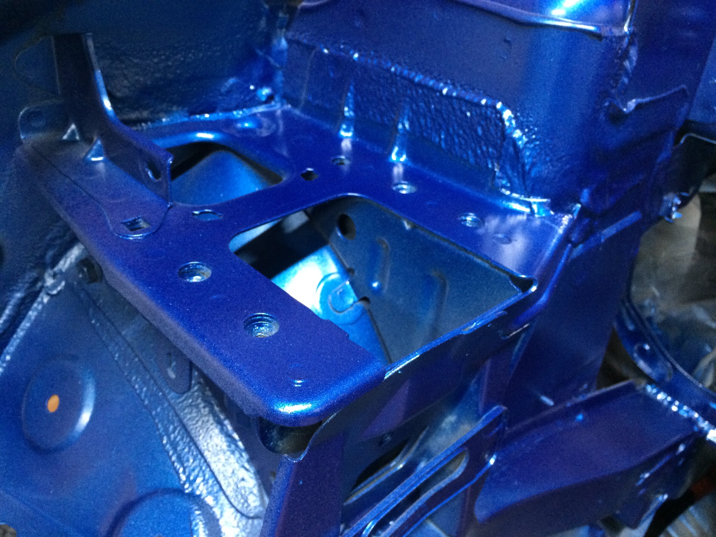

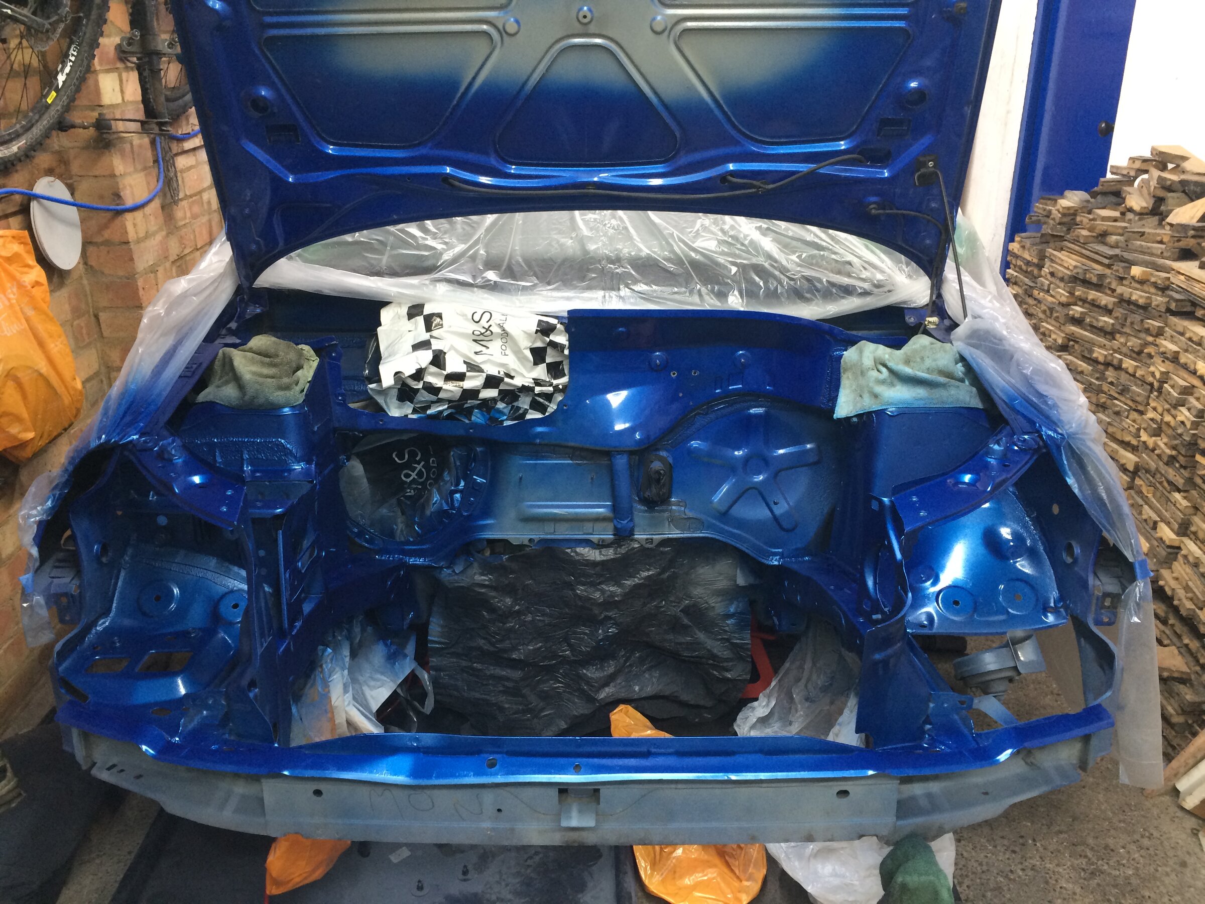

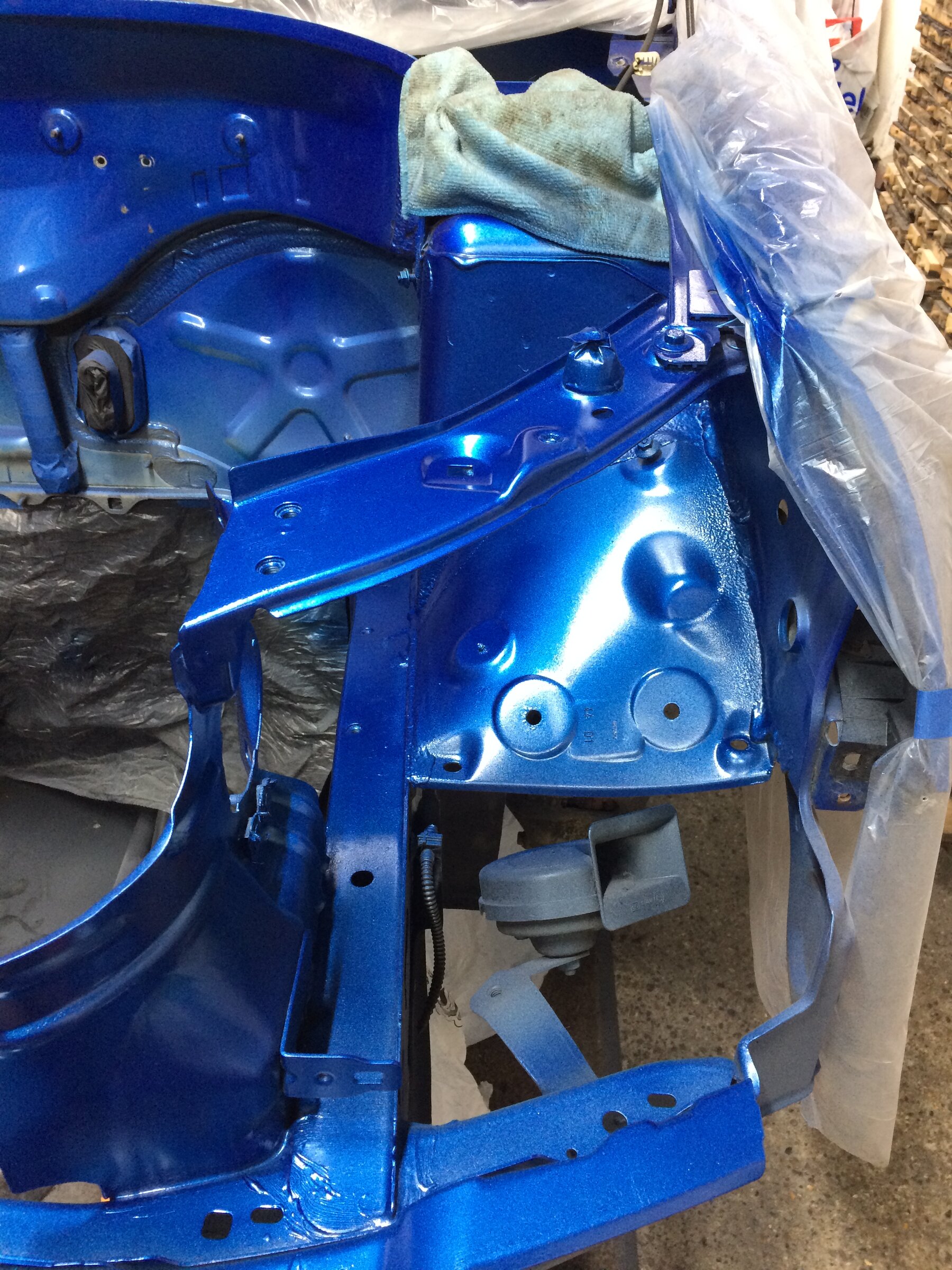

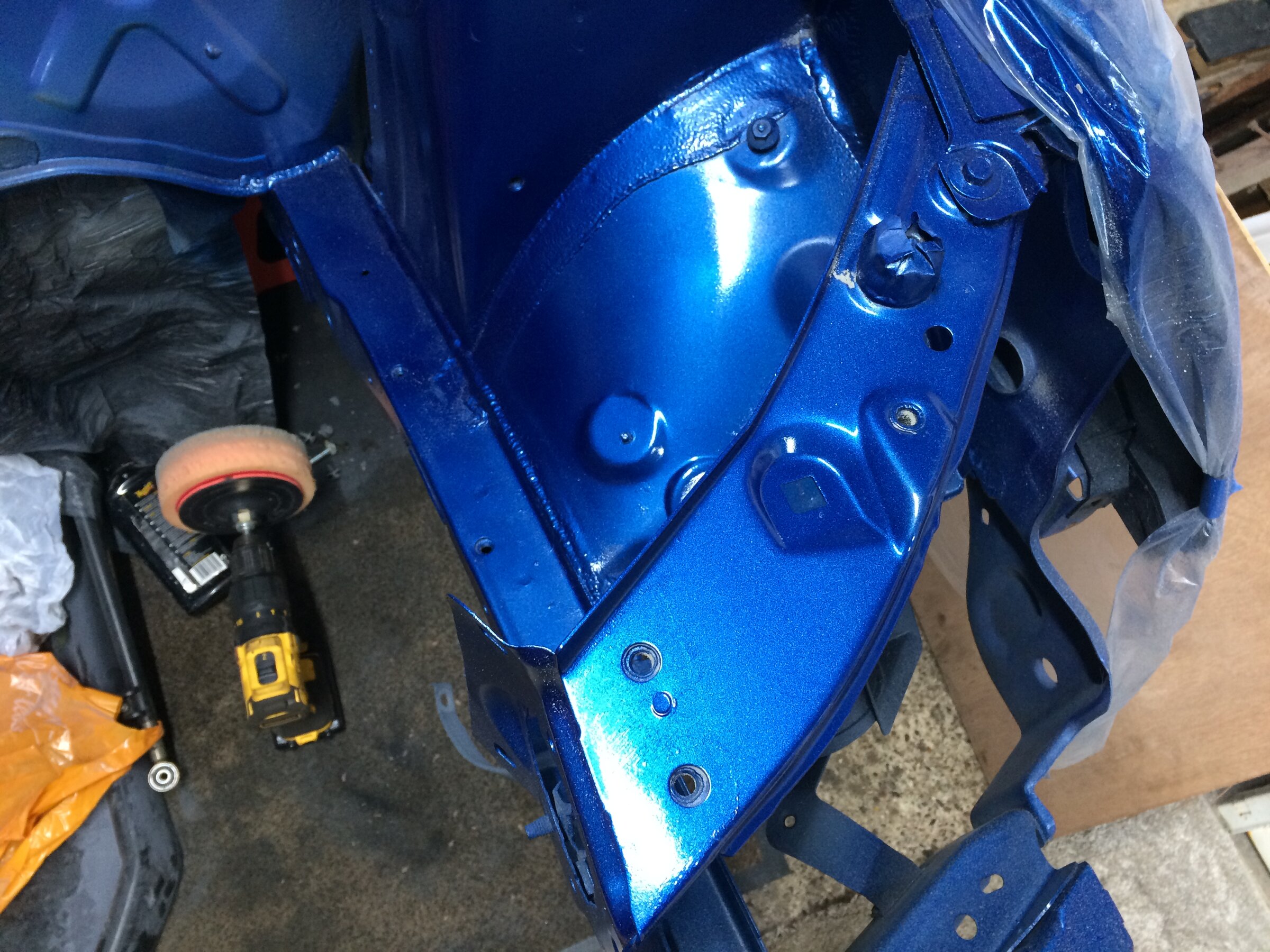

I didn't end up spraying in inside and ended up using hammerite but I have recently done the engine bay using 2k. I would never do it again without a proper airfed mask. The stuff is very nasty so if you decide to do this make sure you have the proper equipment to protect yourself.
2k engine bay bit orange peely, primed with Bilthamber eletrox
Hammerite interior
