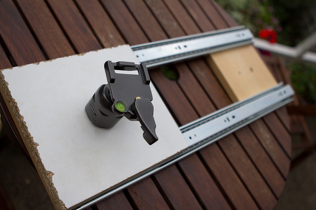

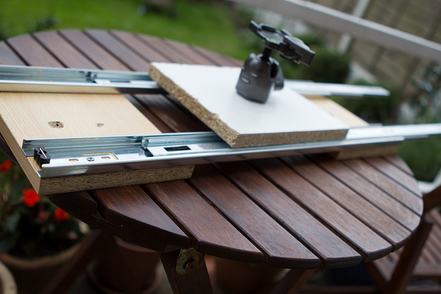

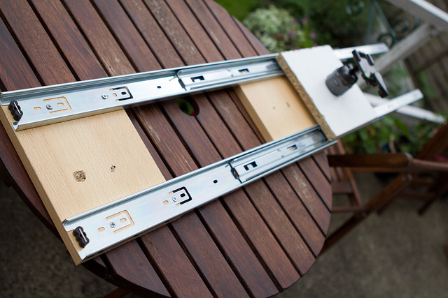

I wanted one of these to have a play with, cut didn't want to spend a fortune on one.
So with some inspiration from Greg's recent design, which i have yet to see up close but have been told about, i decided to make one after work today.

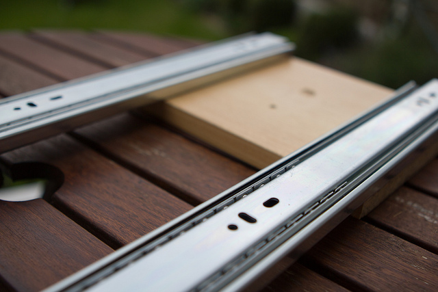

I went to screwfix and bought some drawer rails, smooth ones for just over £8 and the rest of the stuff i found lying around the garage.
It looks rough, but it works. I'm going to try and find some nicer wood for the camera part but until then it'll do!
I'd also have liked it a little longer, this is 550mm long and is the longest they had in stock. I'll keep an eye out for longer rails though.

Are you just pushing it along? The slide doesn't look 100% smooth, perhaps setup a pulley to do the motion instead?
Looks cool though, nice low cost solution.
That's really cool
I saw a guide where a guy had put a long elastic band from the mount and used that to pull the camera along - gives a nice soft start/finish to the movement and removes any hand jerkiness :)
