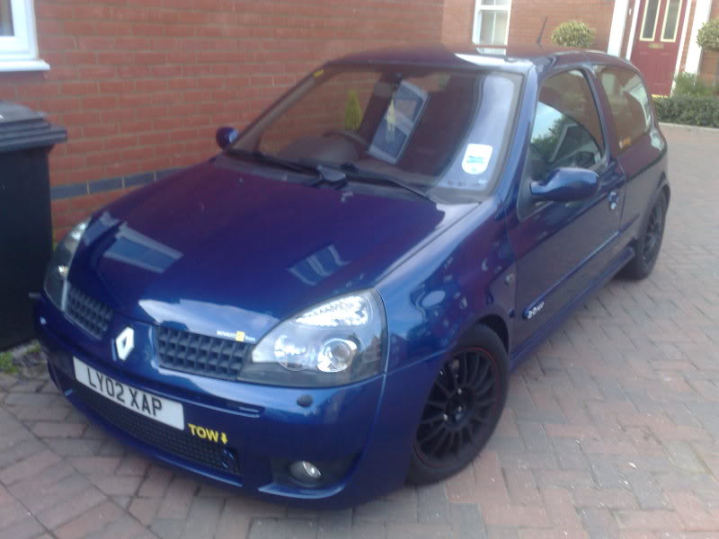

Im aware that plenty of people may have used it before but as someone who is just getting into the whole detailing malarkey (expensively :( ) I only used the stuff today.
Few weeks back did a wash, polish, CG Wet Mirror Finish then some DJ Blue Velvet and its started to gather crap loads of dust and stuff from sitting under the trees at work. So tonite did the following.....

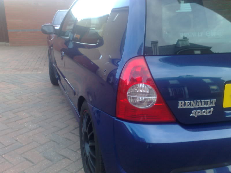

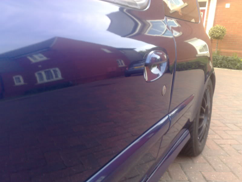

Snowed, washed with AG shampoo and dried then applied some Red mist... looks bloody awesome IMO
Obviously after drying there were a few dry water marks (god knows what some of you call it!??!) so decided to try out the quick detailer
What other quick detailers do you guys use that you rate?

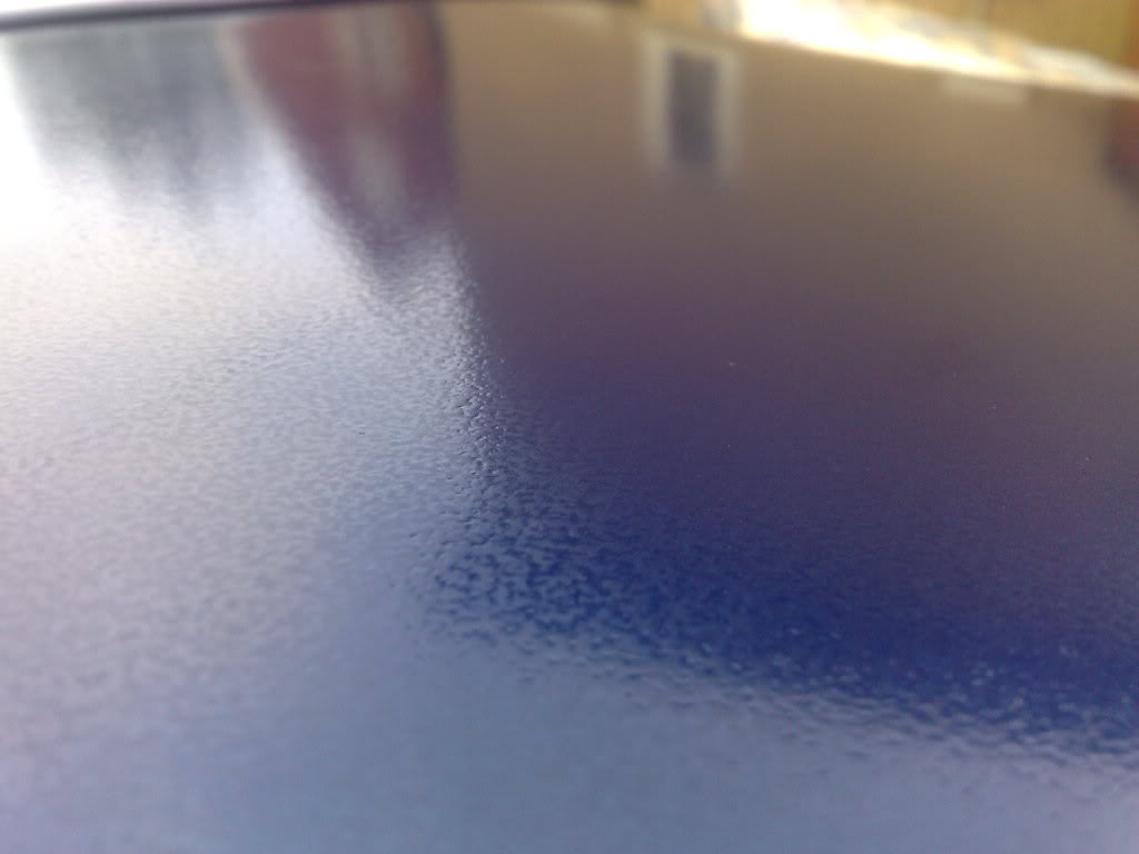

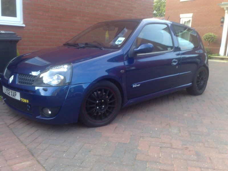

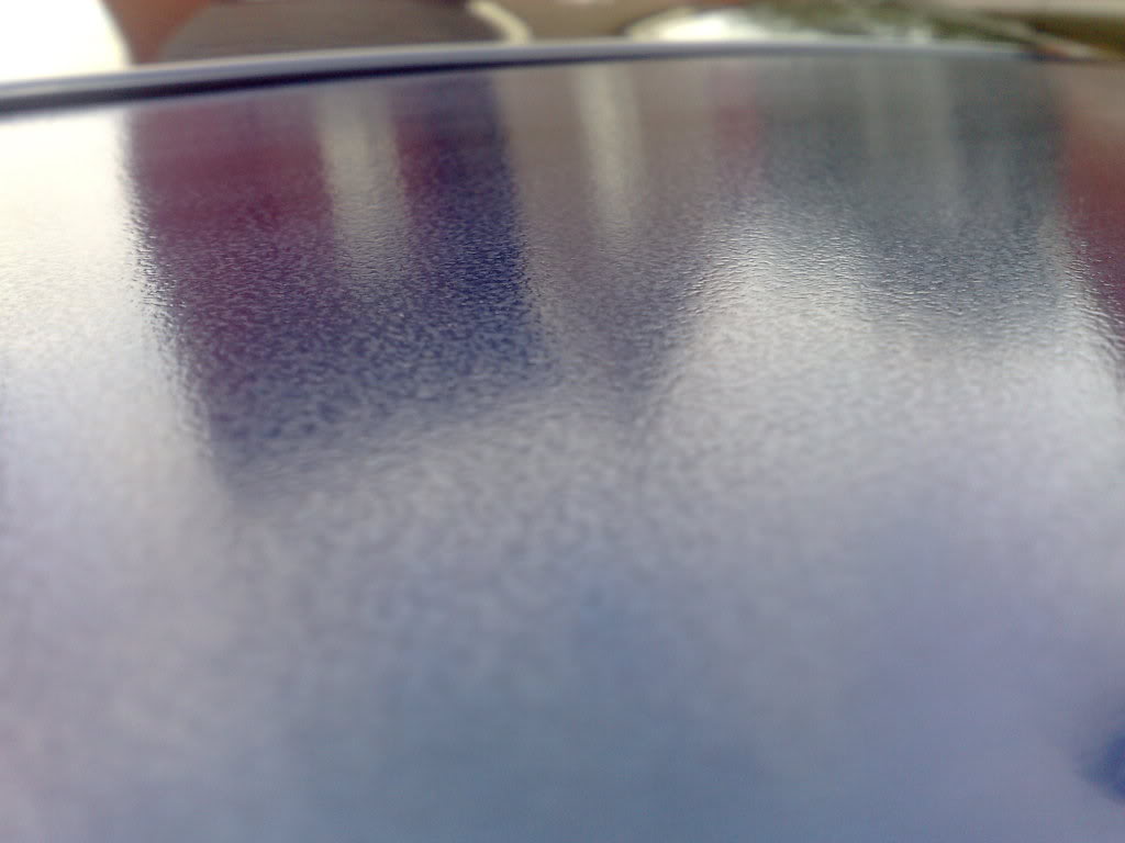

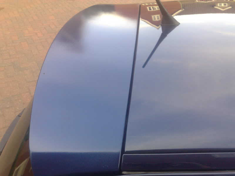

Oh and whilst im here I thought you'd like to see my nice finish on my spoiler (can also see it on 4th pic down) ;) :eek:
Cro
  Meg'd r27
Lol dude that needs super wet flatted down :) The dodo looks likes it does its job nicely
  Bumder With A Buffer
haha spoiler doesnt even match lol nice car but mate :D
I know :( f**king Holts spray is s**t!...Its hard to explain but it came out of the can "dry" as in it was sprayed on then was dry pretty much straight after! Il be getting it done professionally soon.
  Flame Red Delight
yea professional is the way to go i would say mate, take it you never sanded it down either as you still have the orange peel effect on it
Well maybe my limited experience at spraying large parts showed here... I honestly didnt think of sanding it down after its final few coatings and before lacquering. I sanded it down after primer and before coats but didnt think about the top coats :(

I'd have a go with the wet & dry before sending it off to be professionally done.
Try 1200 Wet, 1500 Wet, 2000 Wet and then Meguiars Ultimate Compound.

Just soak the paper in warm soapy water for 10 minutes then use it wet, take it easy on the edges and let the paper do the work, keep the paper flat with a sanding block.
Work from 1200 - 2000 and then compound.
I've just sanded my entire Peugeot 206 down with 1500 paper and then G3'd - lol
That was a bit nerve racking, but it's come out fine!

I 2nd this. Depending on how thick you painted it, it should look 100x better.
But i wouldnt bother with 1500 grit. Go straight to 2000 otherwise im sure you'll strike through.

No I "want" a small 307 splitter ;)
  Ph1 172 + Combo van
Sorry to say it but i dont like the car atall.
Waaayy too many colours going on. Black, blue, red, yellow and white.:dapprove:
Yellow is off now.. black wont be black for long... just running the tyres into the ground after using them wheels recently for a trackday.

:) Did a little bit with some P1500 yesterday... cant get P2000 for s**t round here :(

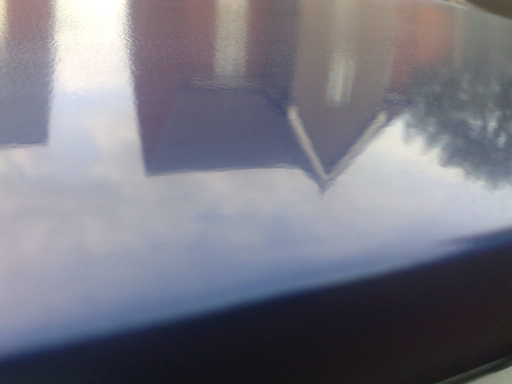

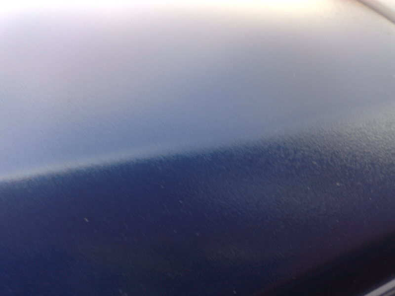

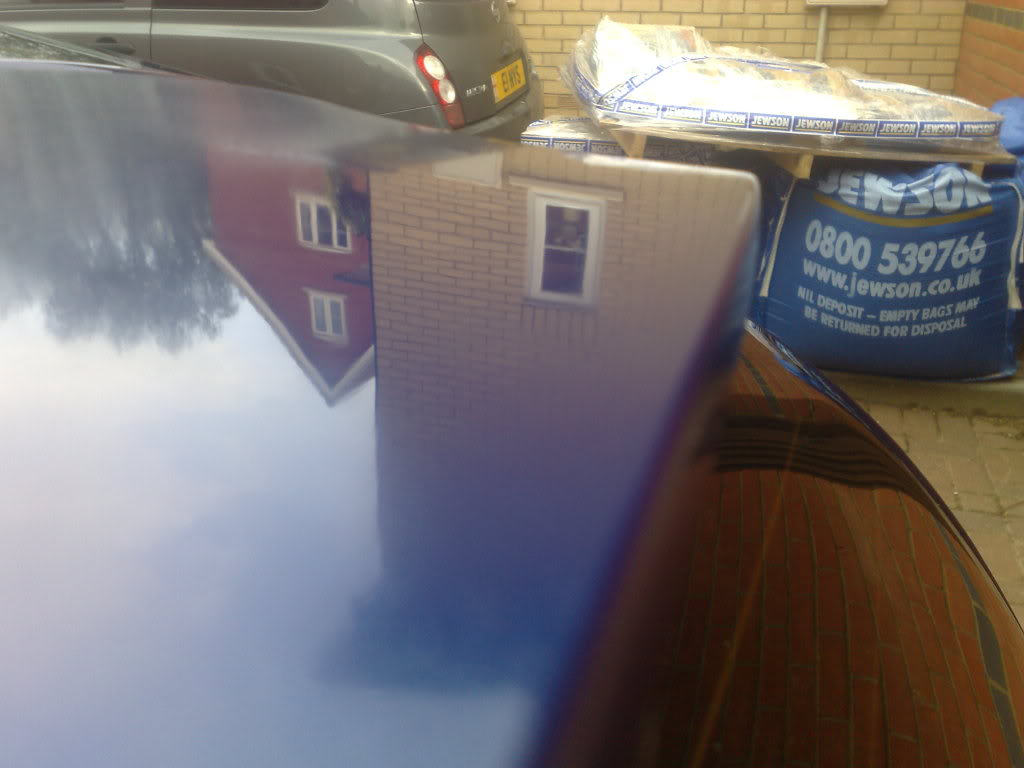

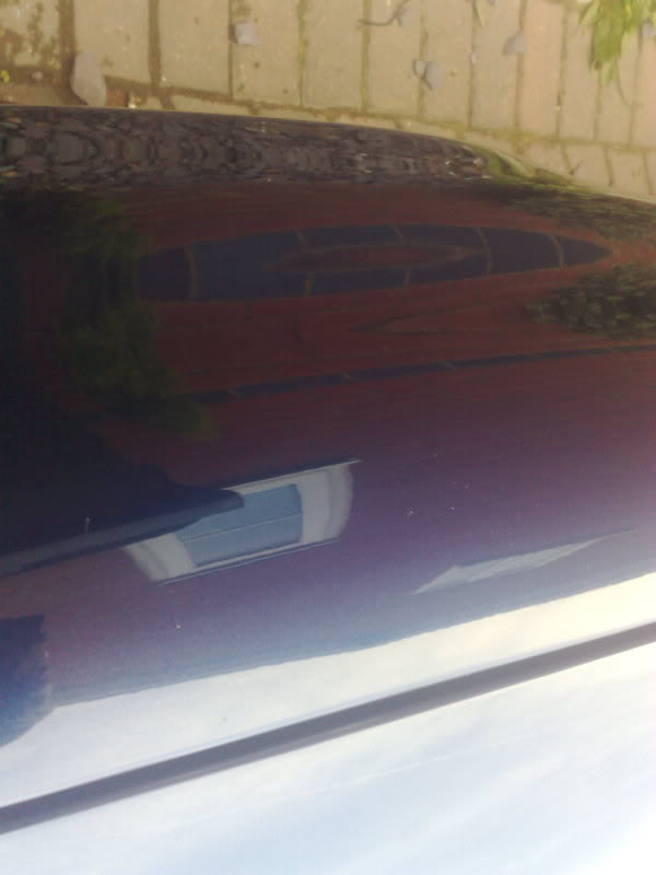

Couple of pics if you can make it out.....
This bit I hardly touched its just where I ran over ..
You can see what bit I did here by the reflection of the house...
slightly better..
Another one after a few passes..
This one you can really notice...
Unfortunately it pissed it down and although I wanted to carry on.. I dont like getting wet!.. Will wip it off tonite maybe and do it off the car..definitely a mark improvement IMO
Yeah its a lot better with just that little bit done... I wasnt sure if it would work hence why I did a small area to test it with.
Anyone got any P2000 they can send me?!! Me love you long time if so!
colour match is still off though :(

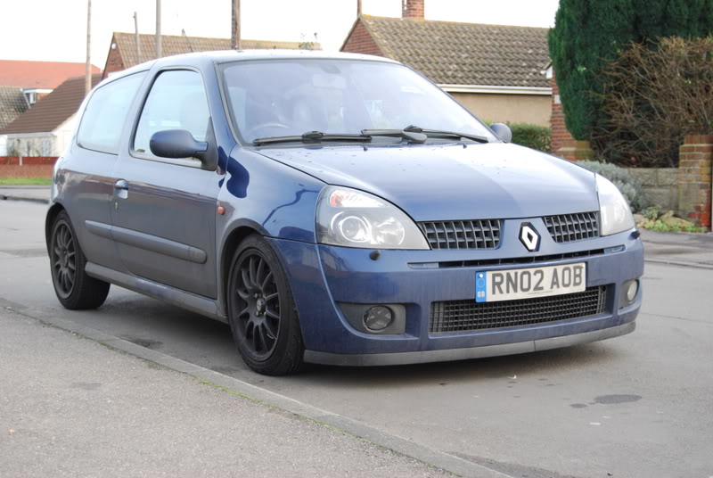

Oh and about the 307 splitter there is 2 types...
Thin one like the one in my top pic is 7414NQ
And the bigger one is 40417nq
