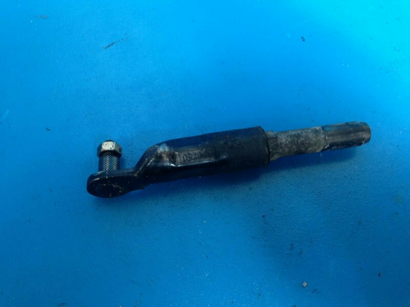

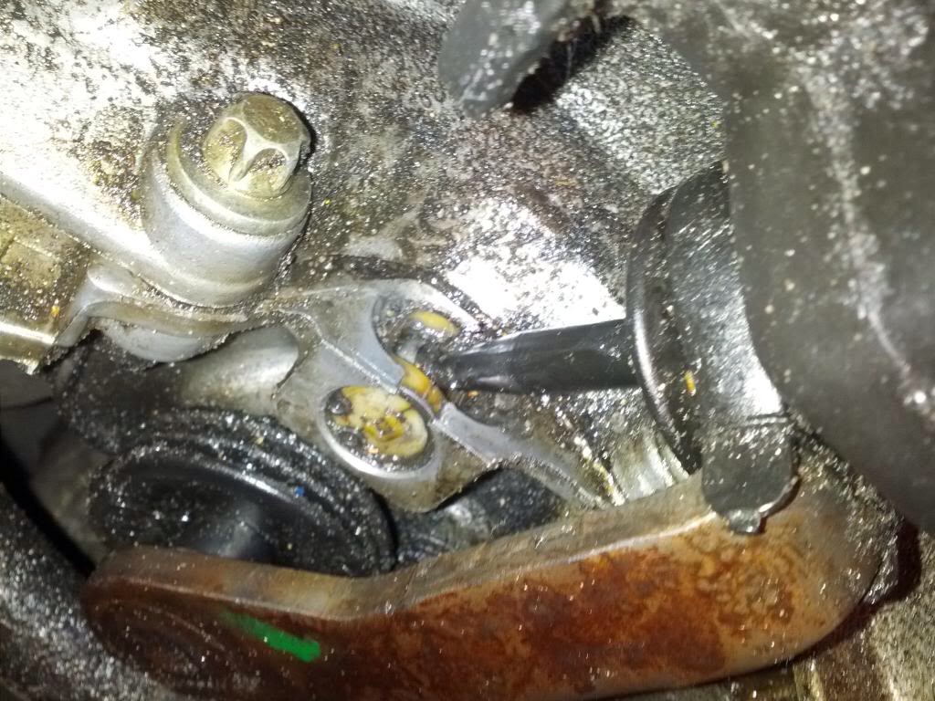

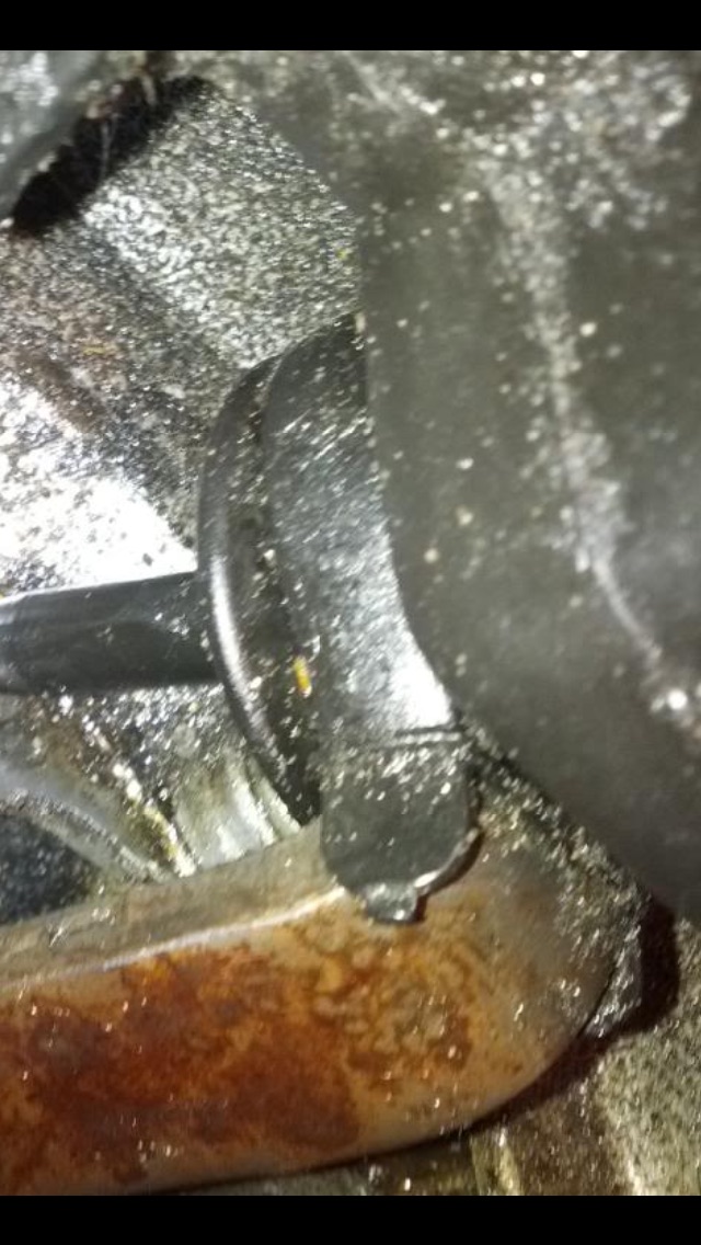

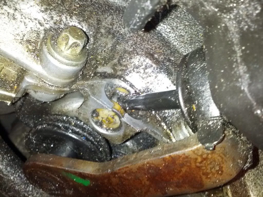

Found it, it's this part of the linkage
And it attaches to this:
Thanks for the pics Mark!

White bit is a sod to fit. Well mine was. I squished mine in with a socket on a jack that still allowed me to poke at the circlip to get it to fit. Just using the weight of the engine and gearbox did the job. Compare size of old and new and you'll see what I mean!

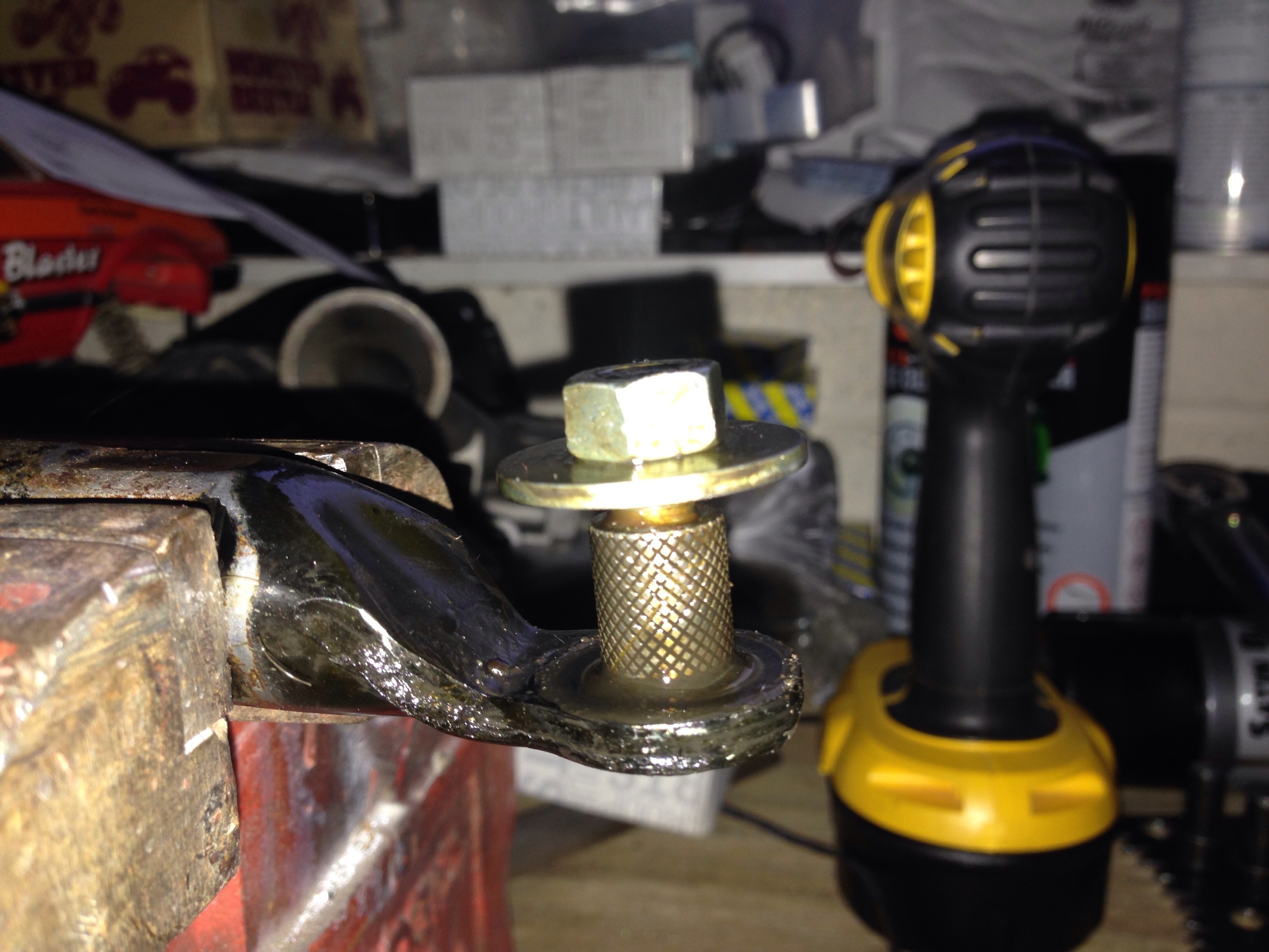

So the knurled bit is actually removable and is jst sat on the bolt!? Where does the other part go? I can't find it on the gear linkage schematic.
Thanks for looking into this by the way!!
I just hope the few thousand miles I've done with a new conrod linkage bit with a worn knurled bit in it haven't worn the conrod as that white bush is such a dick.
I'm guessing it's these two. Can't believe I didn't realise it came off.

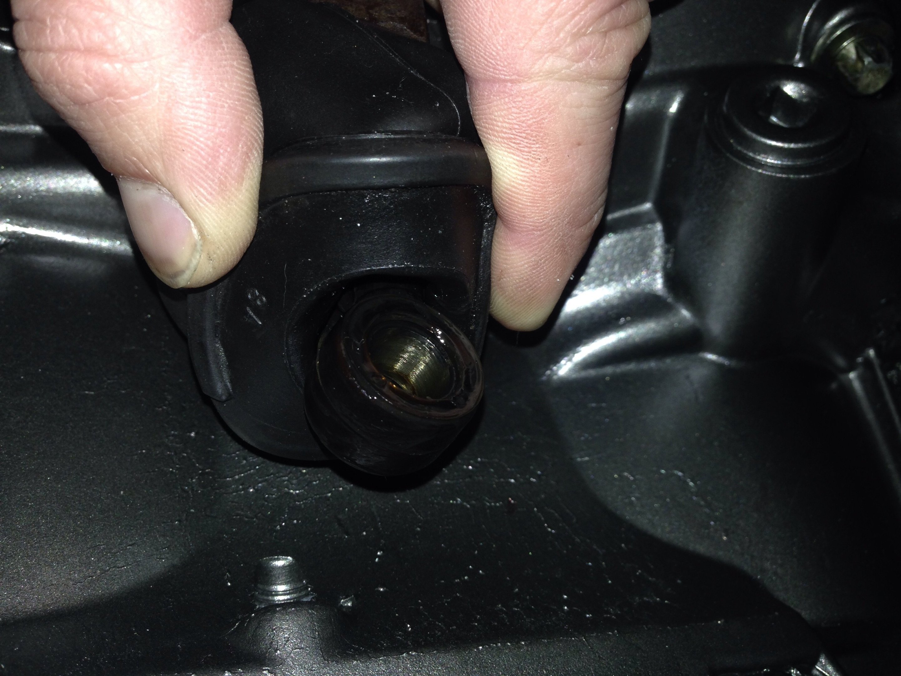

I know where the fucker goes now!! That nylon item is hidden under the rubber boot that the rod passes through. It's on the main selector shaft
Am I being really thick? You mean inside the boot over the end of the selector where the ball on the conrod resides? Or are you on about the bit under the circlip?

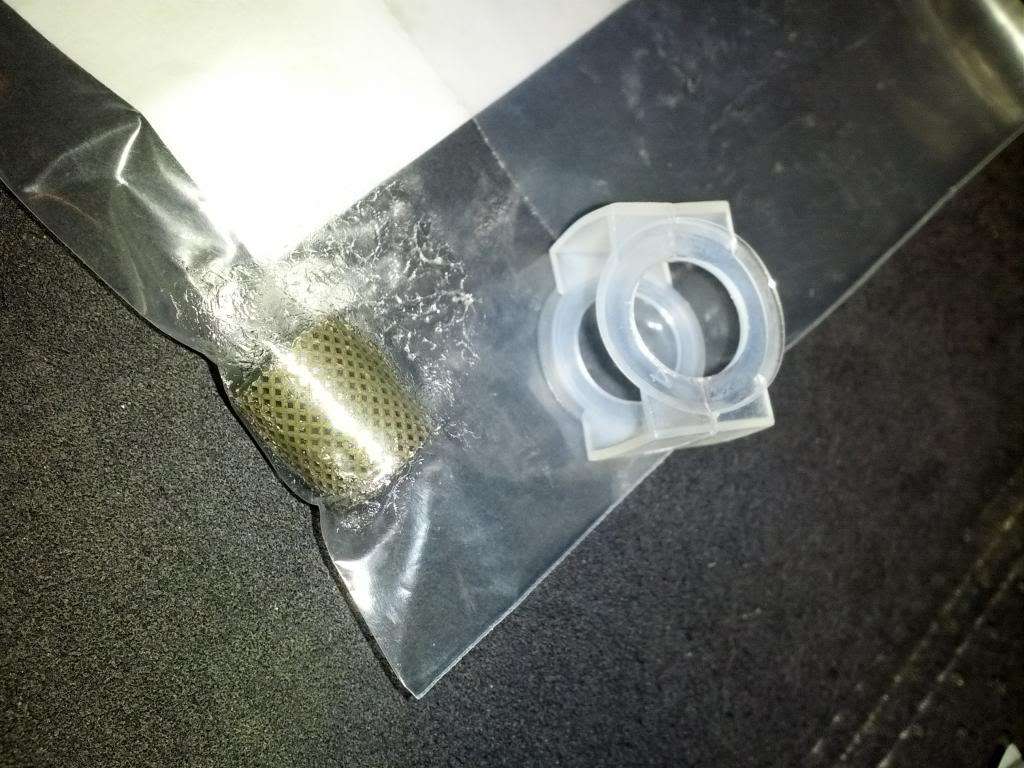

Parts have arrived any they're not the right ones I don't think. The metal bush on mine isn't detachable but i've been provided with that, think it's the older gearboxes that have this detachable knurled sleeve.
Also received a plastic seethrough looking bush, again I don't think I even noticed this part on my gearbox when taking it apart last month.
Going to dismantle it at a later date and take pics of what I actually need to avoid confusion. Not annoyed in the slightest, as they were so cheap!! :D I'll be able to throw them at someone for light entertainment
Going to dismantle it at a later date and take pics of what I actually need to avoid confusion. Not annoyed in the slightest, as they were so cheap!! :smiley: I'll be able to throw them at someone for light entertainment

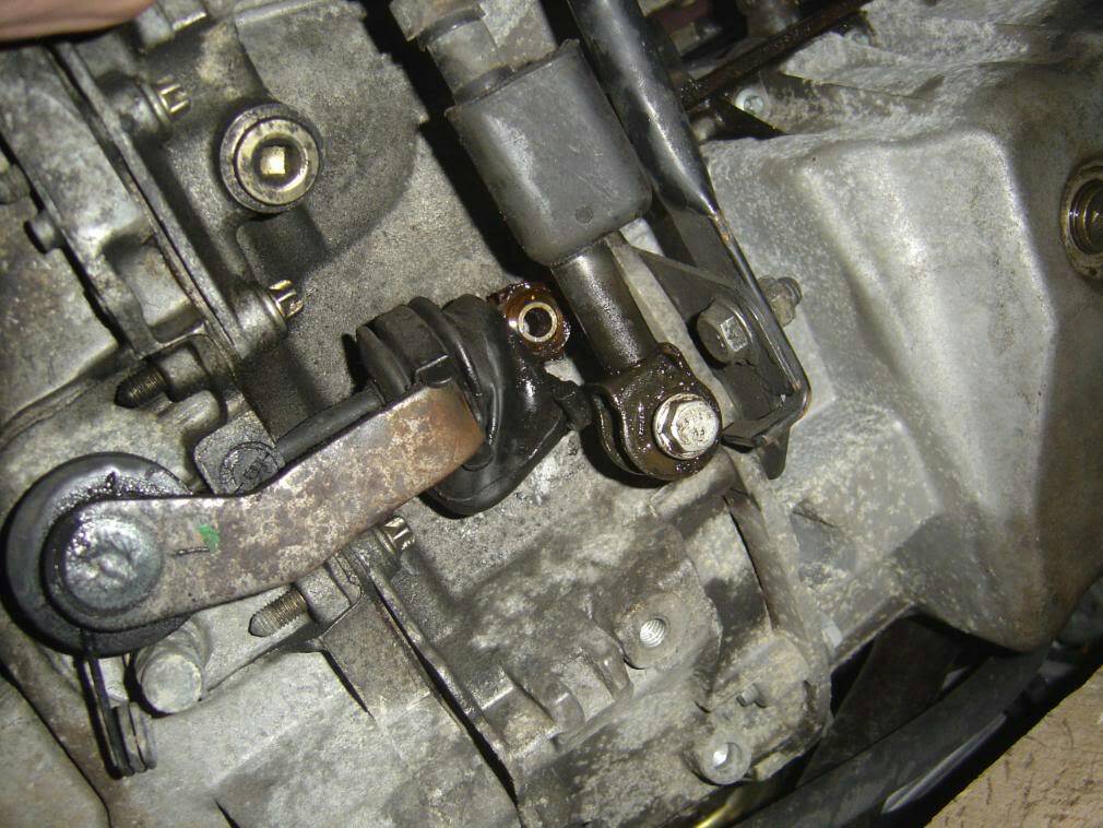

I expect like me you have this one piece item which has no removable bolt or bush and no nylon insert

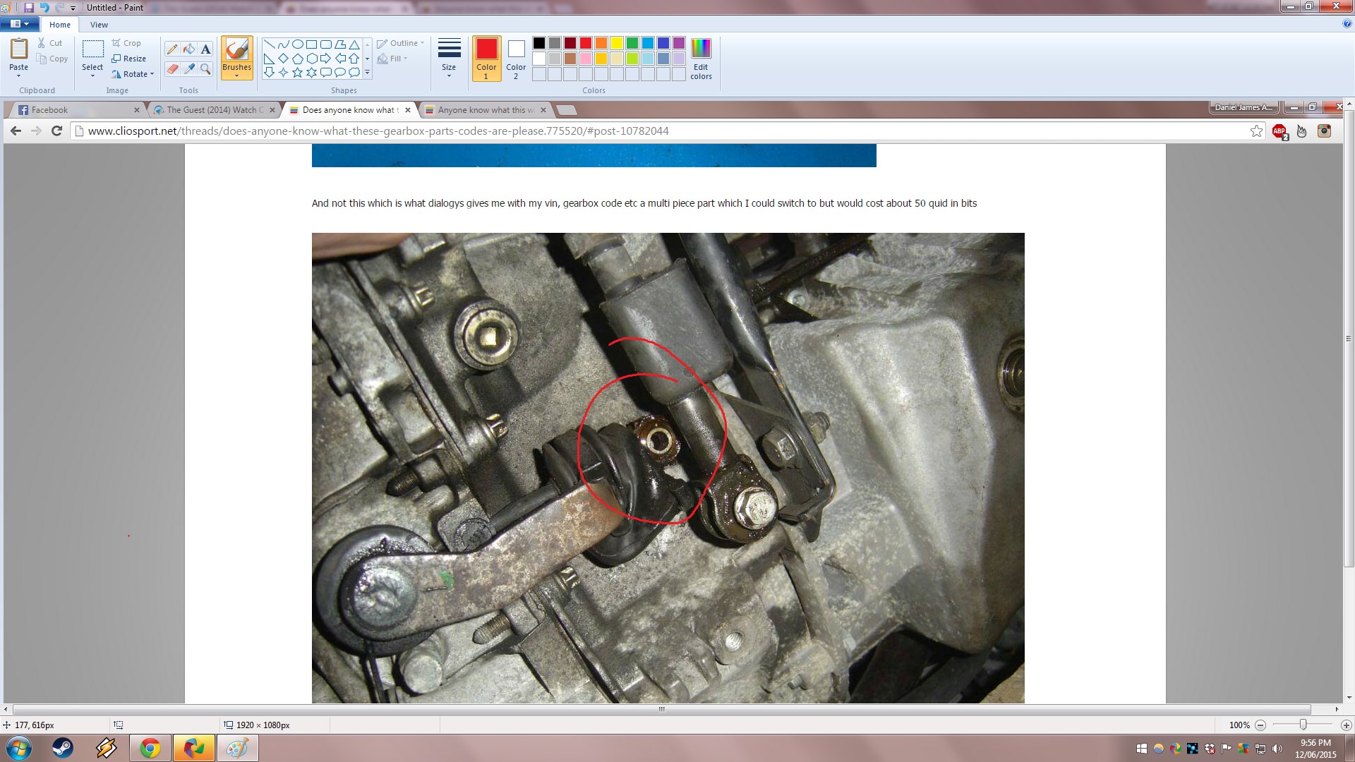

And not this which is what dialogys gives me with my vin, gearbox code etc a multi piece part which I could switch to but would cost about 50 quid in bits
Right I'm pretty sure I've got to the bottom of this. The one piece item as far as I can tell is referred to as a filtration module and has the part number 8200201750 with a star in front of suggesting it replaces 7700107339 and 7700107354 which are referred to as Link rod (ending 339) and clevis gearlvr (ending 354) which require the small metal bush and nylon spacer.
The clevis gearlvr doesn't wear which is why it doesn't seem to be listed as the first option anymore and if your clevis gearlvr was damaged you would just fit 8200201750 rather than buy all the bits again but you can still buy the wear parts for the clevis gearlvr if you like and yours is fine as I have done by mistake.
So if you have the lower picture you order the bush and spacer. If like you have the top photo like me then it should just be 8200201750 which seems to be about 25 quid. I will order 8200201750 soon to hopefully confirm this. If a clevis setup arrives then I give up!!

I need the bush that sits on the knurled section of this, think it's small round and black if that helps haha
You need the whole Conrod and unfortunately like me that knurled bush is part of that particular part unless mine is just fused on!
I'll be ordering 8200201750 filtration module on Monday as much for my own sanity as to improve my linkage so I'll post a picture when it turns up. Should hopefully put an end to all this.

I definitely need that part then but yeah some versions have that knurled part removable, some are pressed/welded on. Depends on the year of car I think I remember when fitting the yanoo stiff shift as he provides an uprated bush and you can only fit it if you have the detachable knurled bit which me and you both don't have.
