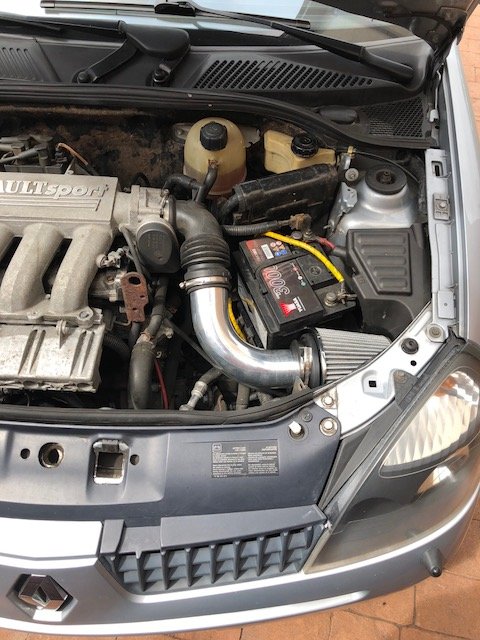

Does the size of the Ramair filter alter the sound at all? Would I bigger one be better for the engine to get more air in?

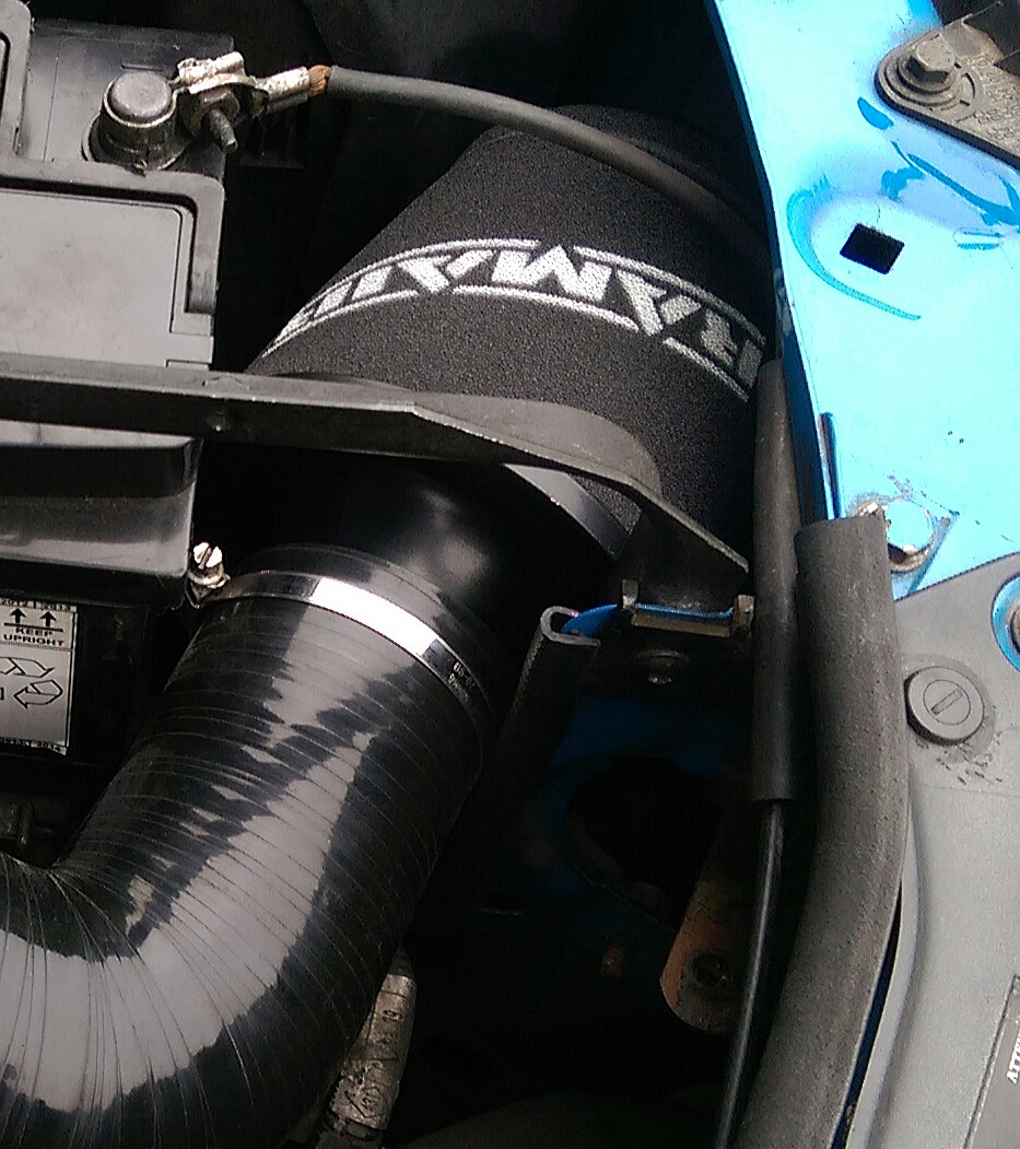

I think the material of the pipe makes a difference to the sound. My last 182 used a 90 alloy bend into a 90 silicon bend. I bought this setup to allow me to remove the RS2 manifold, and to be honest i thought it sounded better than the RS2 setup.
I've now got a 90 silicon bend into the standard 90 bend pipe , and it doesn't sound as good. Almost like the induction noise is being dampened by the silicon.
Only drove the previous setup a few miles, but plan on replacing the silicon bend with an alloy one in the future on my new 182.

I would expect a solid pipe to be louder to be honest. Would have thought the softer silicone (or rubber) would absorb some of it.

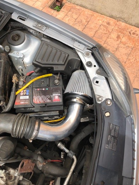

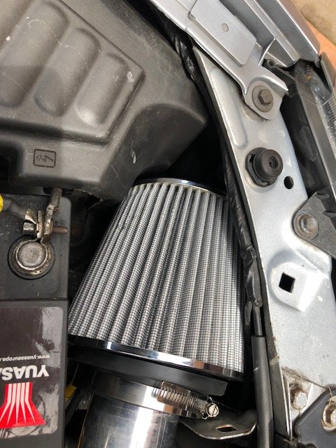

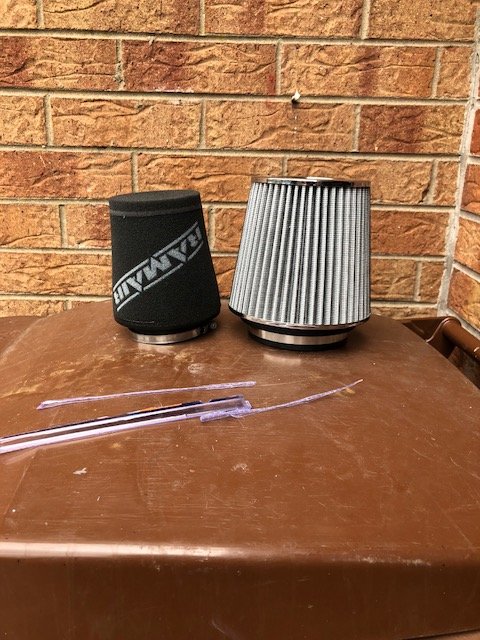

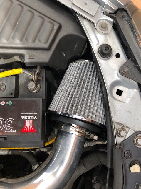

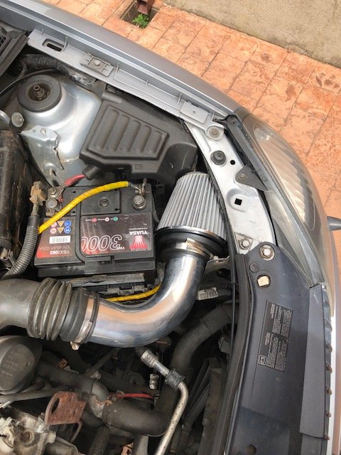

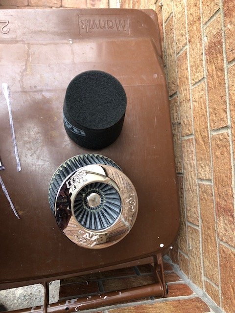

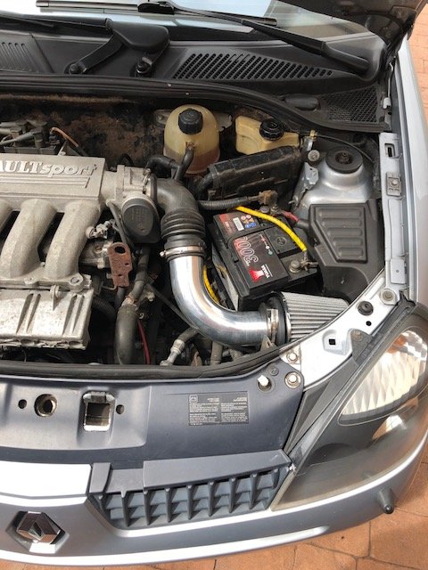

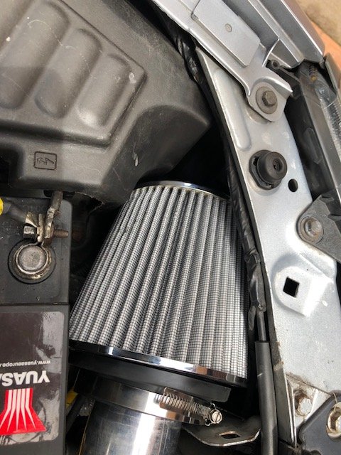

Well, in order to quiet mine down I spent £45 on a K&N filter. It sounds quiet up until about 5k RPM then sounds almost like the Ramair. Dare I say it feels a little sharper too. All in all I'm pleased.
Tight fit, but I much prefer it.

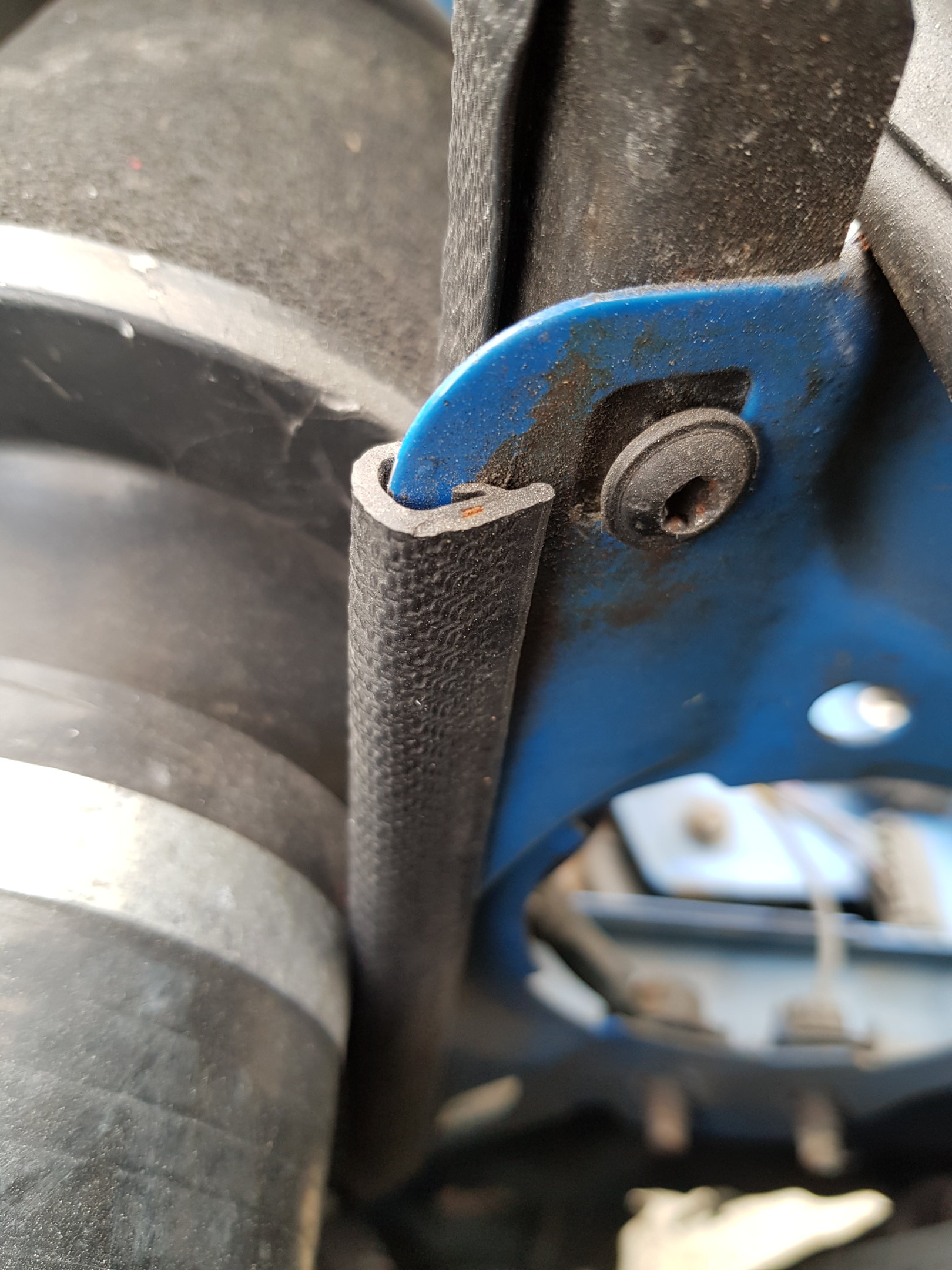

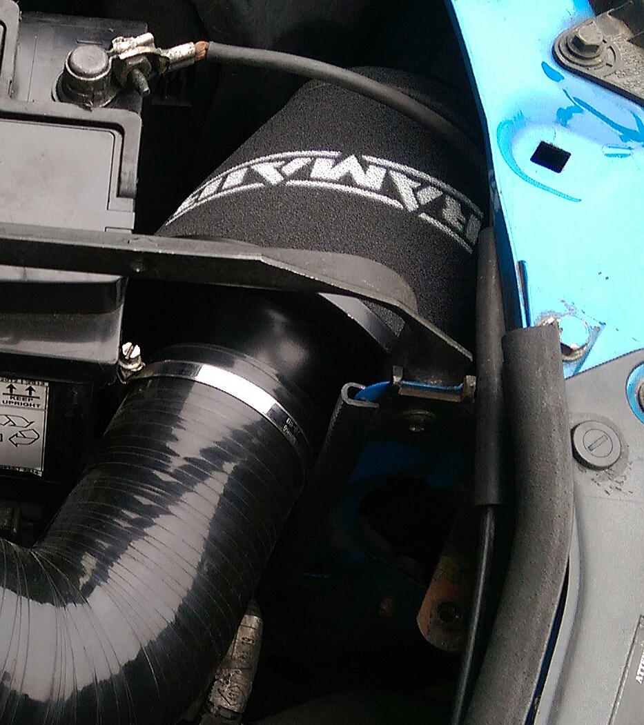

Also, I've put a bit of rubber strip on the brace so that it doesn't rub. Not really noticeable on mine as i have silicone pipes but it's worth a try on the ally bends.
Digging up an old post here but what have you used to stop the pipe rubbing on the metal Mark?

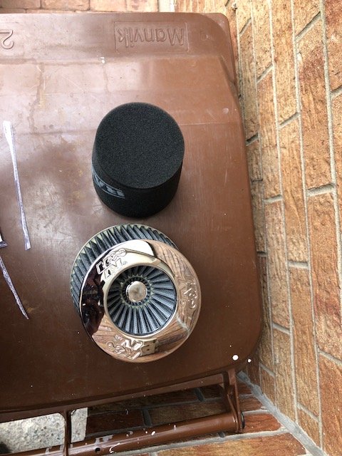

Most people seem to be using the ram air foam filter. Any reason nobody's using k&n?
One here for 25 quid, same price as ramair and looks much better imo. 76mm so would need a reducing joiner
https://rover.ebay.com/rover/0/0/0?mpre=https://www.ebay.co.uk/ulk/itm/323254826865
I went for ramair as the neck was the correct diameter with no reducer needed and it was also offset which was perfect as my battery it a bit too big so having it offset moves the filter away from the battery a little
  2003 Clio 172
I doubt a cotton filter will filter any better than a foam one. If anything I would have thought a cotton one would let more dirt through. Only one way to find out though. At the end of the day, all free flowing filters will let more dirt through than stock, whether cotton or foam. As long as you keep them clean and oiled I doubt enough of anything will get through to cause any damage.

That's about 9 quid more than the one I posted and even though it has an adjustable diameter it still only goes as small as 76mm.
My main question is, why aren't people using k&n? Do they sound crap in comparison?
I'm weary of the ramair from what I've read of the foam breaking down and the amount of dust/dirt it let's in.

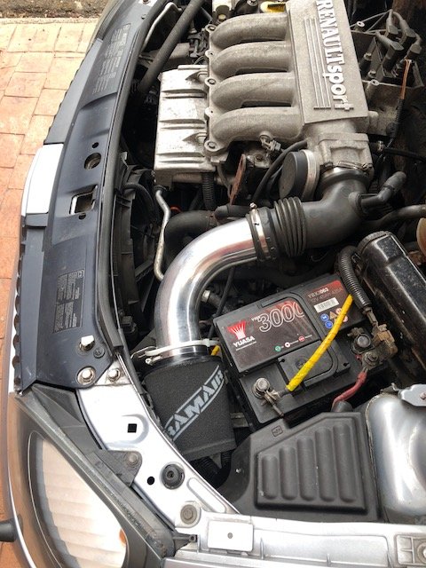

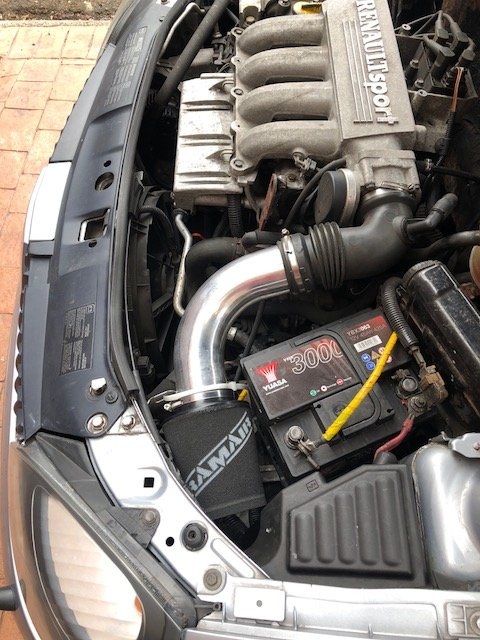

A few people are asking about the parts required for my induction setup, so though I would make a tread for reference.
First of all, it looks like this:
It compromises of a RAMAIR foam filter and an alloy 90 elbow pipe. At time of writing you can get both from ebay:
ASH 90 70mm Elbow pipe (currently £12.95): http://www.ebay.co.uk/itm/Alloy-Bend-90-Degree-L-Elbow-70mm-2-3-4-Silicone-Hose-/130711715302
RAMAIR 70mm offset filter (currently £24): http://www.ebay.co.uk/itm/RAMAIR-IN...arts_Vehicles_CarParts_SM&hash=item5af34e6c91
RAMAIR doesn't seem to sell the exact filter I have in the pic above on its own anymore; the new ones are a bit smaller than mine - they are 2.5cm smaller at the wide end (but the same at the bottom end), and 5.5cm shorter in length. Mine has actually got damaged over a year from rubbing on the headlight and connection box quite badly, so this new size is more ideal, provided it doesn't loose any of the advantages. You can get the same size filter as the one in the picture above WITHOUT and offset, but the offset filter makes it easier to fit next to the battery and imo a non-offset filter of that size would not fit with this pipework at all. Interestingly, RAMAIR do sell the exact filter above in an 'induction kit' for the 182, but its double the price (and i'm not sure it will give double the performance, if any extra at all). If you are interested, it is available here: http://www.ebay.co.uk/itm/Renault-Clio-Sport-172-RAMAIR-Induction-Filter-Kit-00-LIFETIME-WARRANTY-/390542430503?pt=UK_CarsParts_Vehicles_CarParts_SM&fits=Model:Clio|Cars Type:2.0 16V Sport&hash=item5aee249127
Also keep in mind that you dont have to use a RAMAIR filter at all, any 70mm rubber neck filter will work, provided it is an offset one if the inlet side base is any bigger than 14cm.
My car saw gains of 10hp with this setup over standard (will post the graphs in a bit), so well worth the money!
Provided you line everything up correctly, it should fit nicely. And this new smaller filter should stop any contact between the light unit etc. I have cable tied the neck of the filter to the car to stop it moving around (I used white cable ties as thats what I had, but black would look better).
fitting instructions:
(1) put filter in position behind headlight (and under the negative battery lead)
(2) connect alloy pipe to rubber elbow on engine side - don't tighten
(3) fit alloy pipe into filter, making sure you have the jubilee clip in place already
(4) line everything up then tighten jubilee clips
(5) secure filter around the jubilee clip area to car body with a cable tie
Alignment should look like this once all put together (keep in mind your filter will be smaller so wont be against the headlight):
