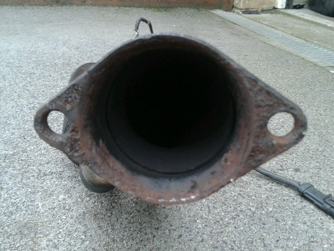

Does this catalytic converter flange look right?
Hi all
Does the flange in this picture look correct to someone with an experienced eye?
Its for a ph1 172
It looks to me like there's very little metal around the top half, but could just be the lighting.
Thoughts/opinions much appreciated!
Thanks
The flange uses a conical wire gasket, its not a "face to face" flange. The pic you posted looks completely normal.
Its normal. BUT you could get away with some wirebrush around the inner to clean that rust off so a new gasket will make a better seal
