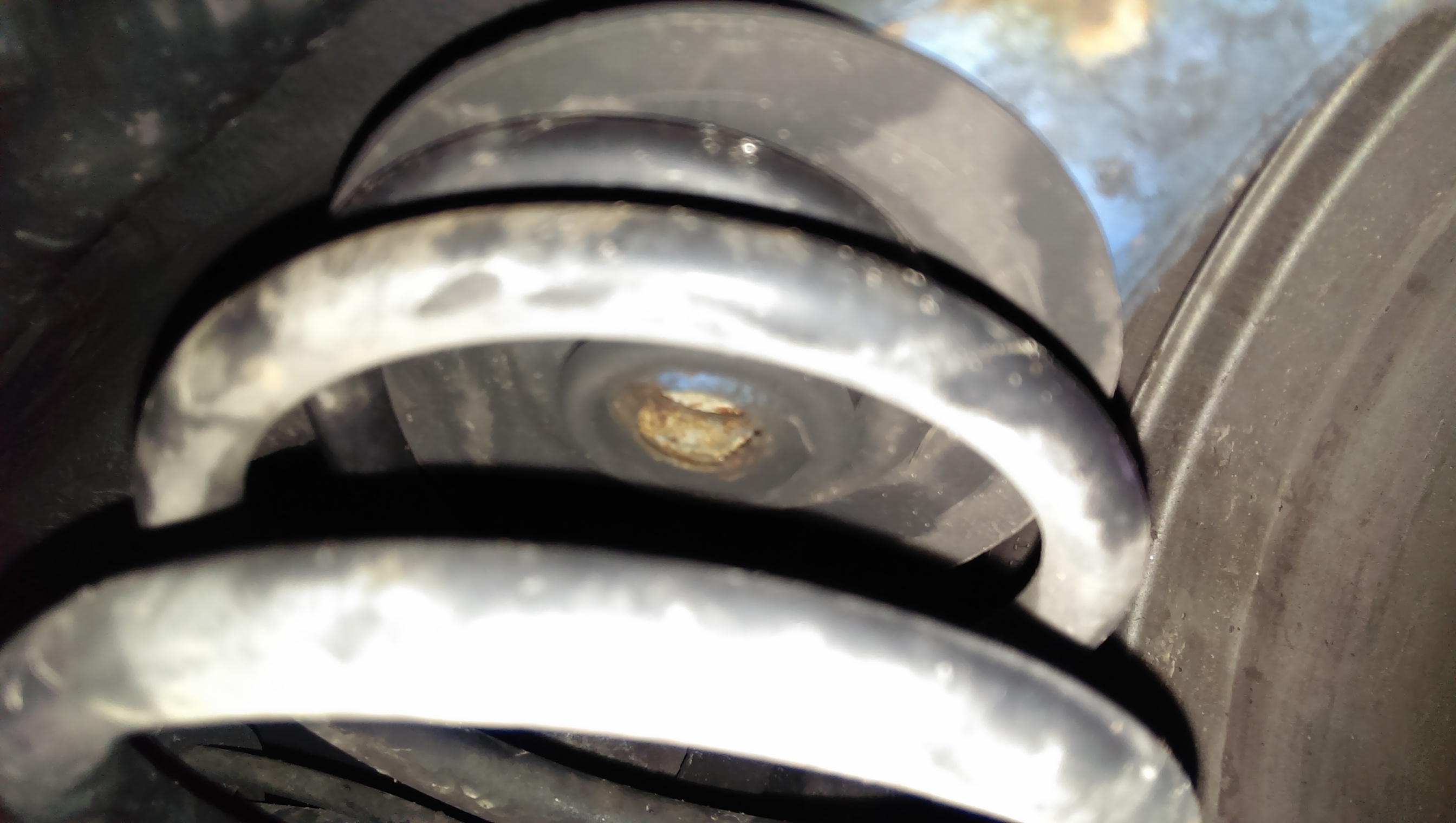

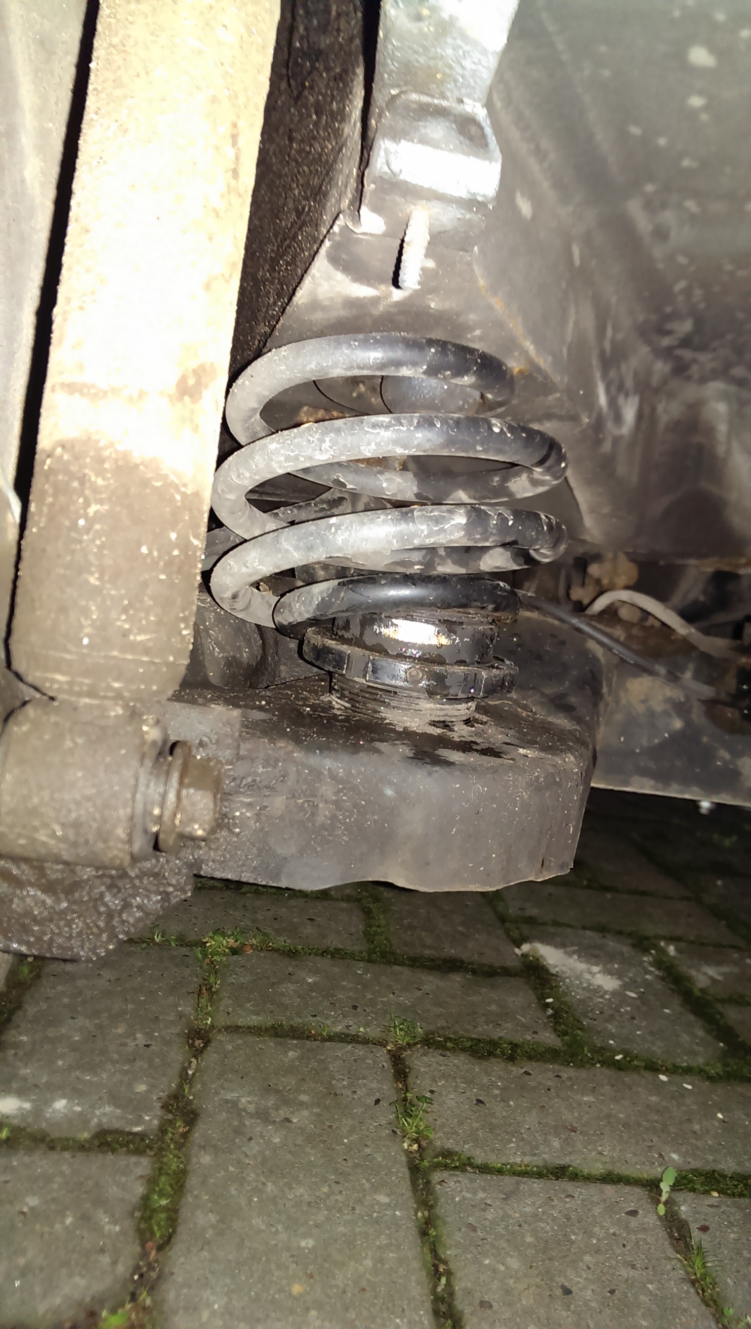

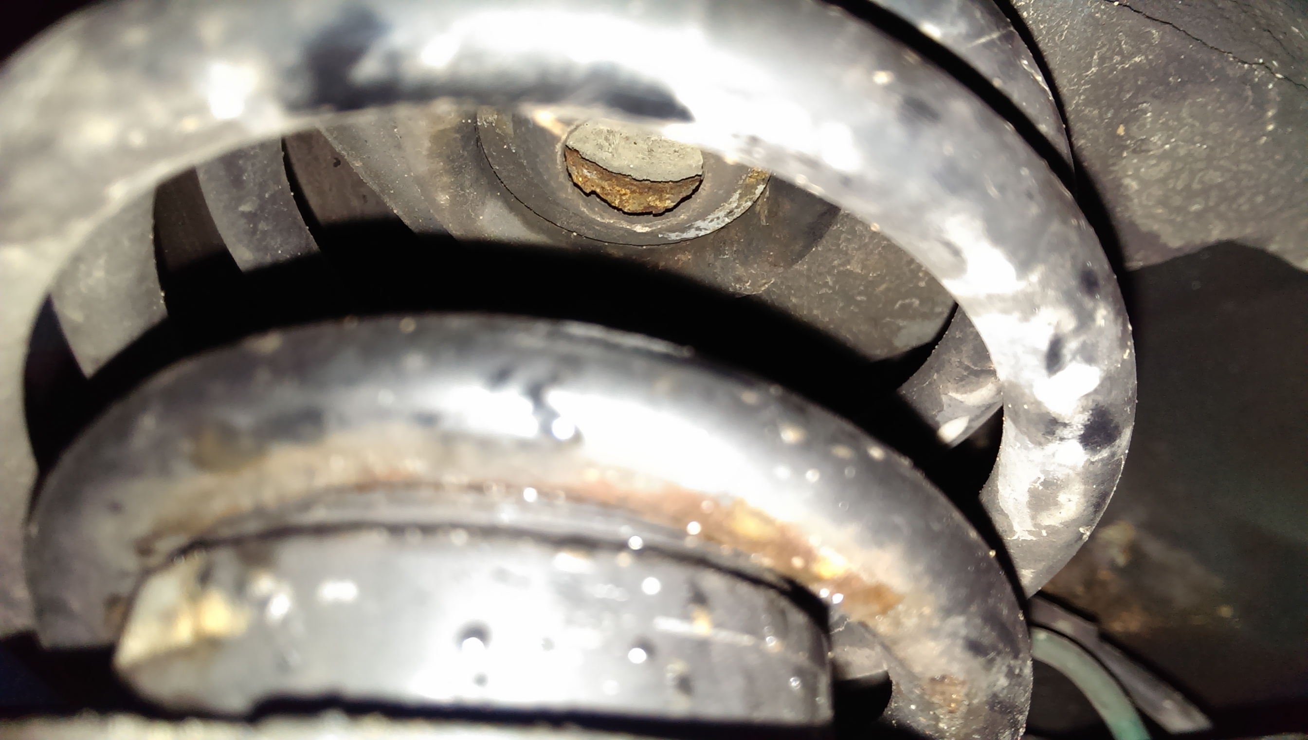

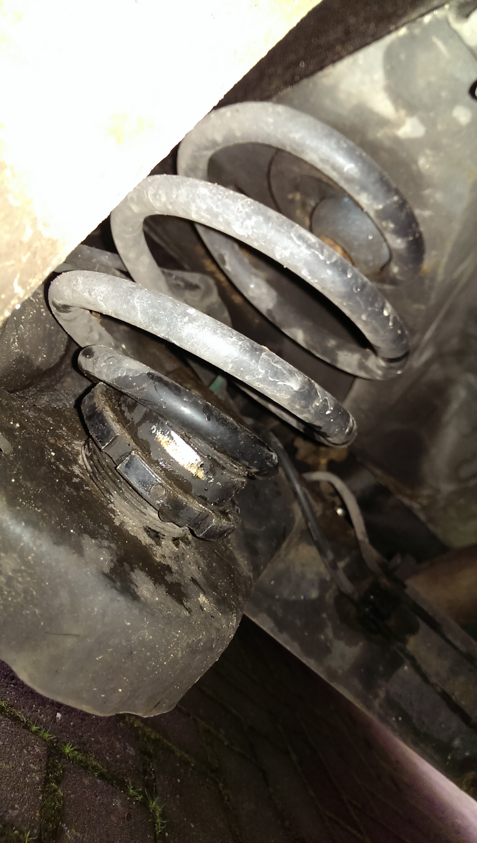

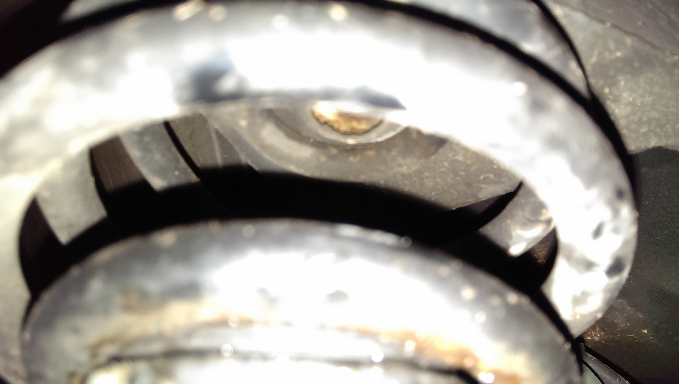

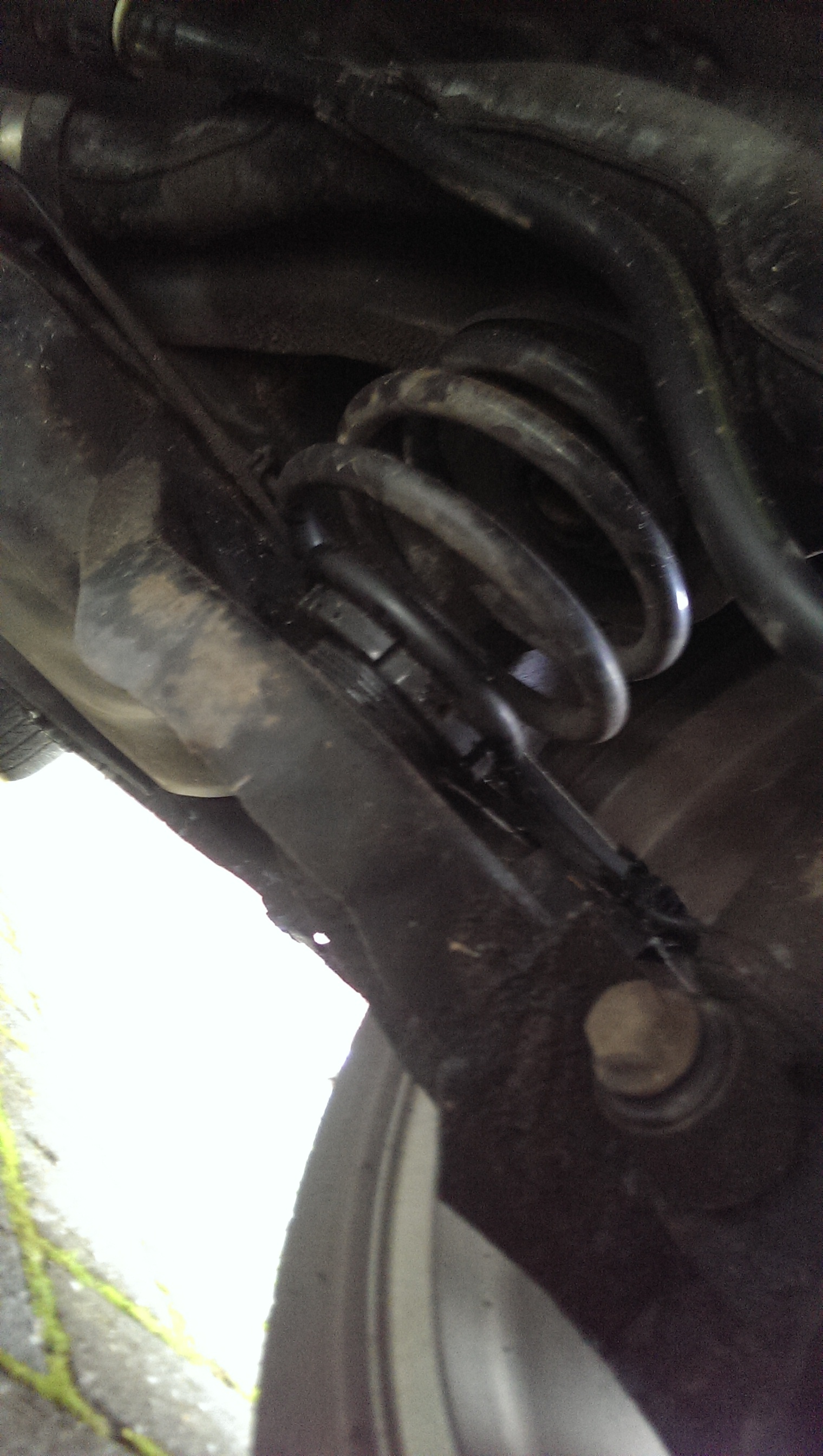

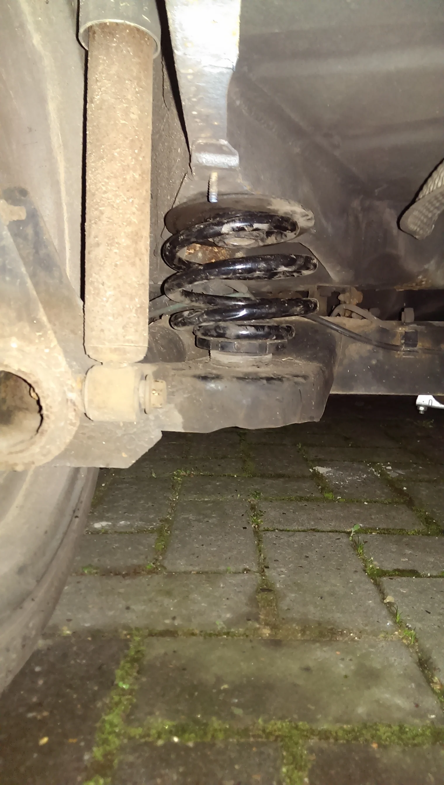

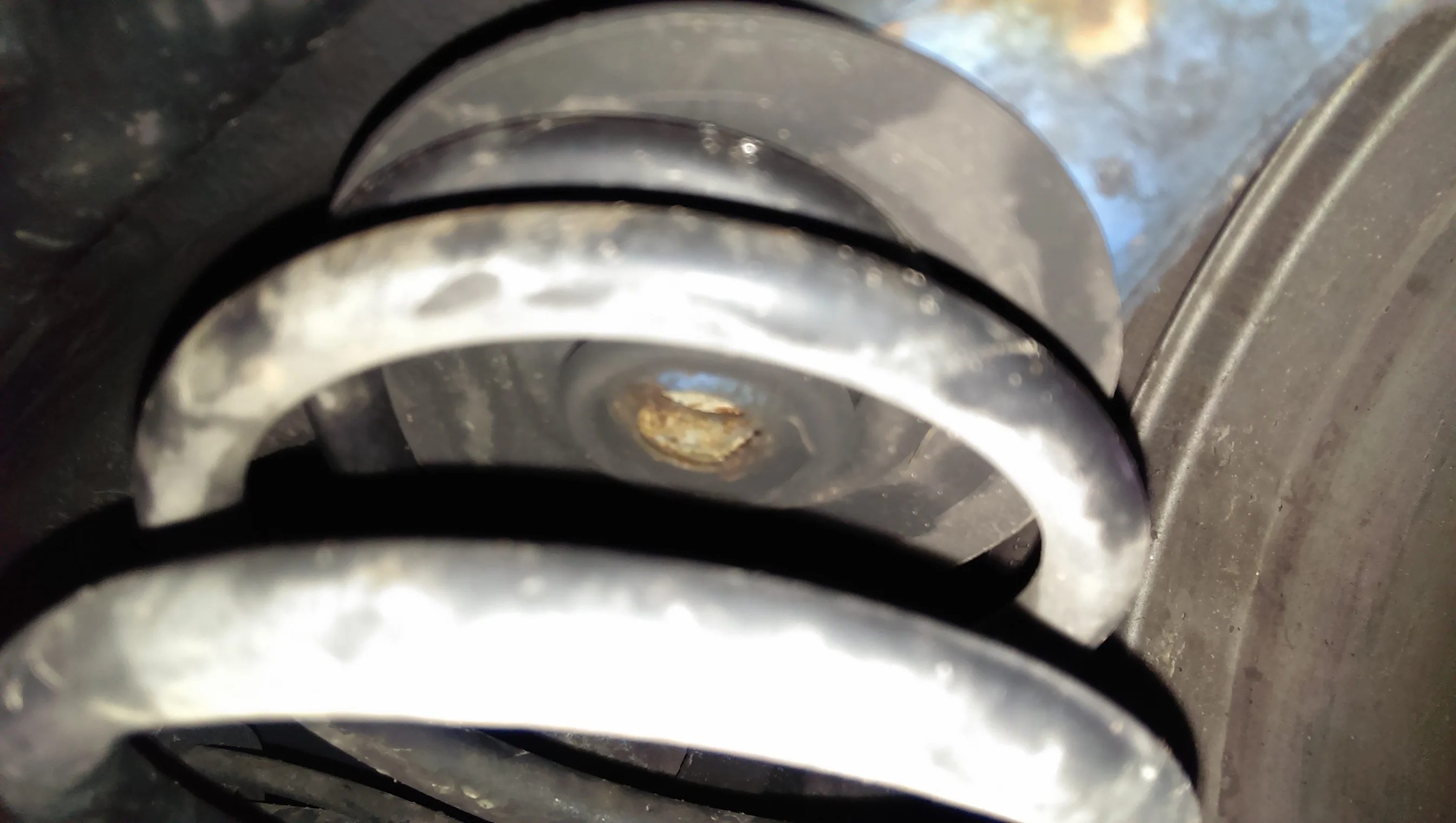

Then this spring caught my eye, this is the passenger side rear spring, it doesn't look like it is sitting right:

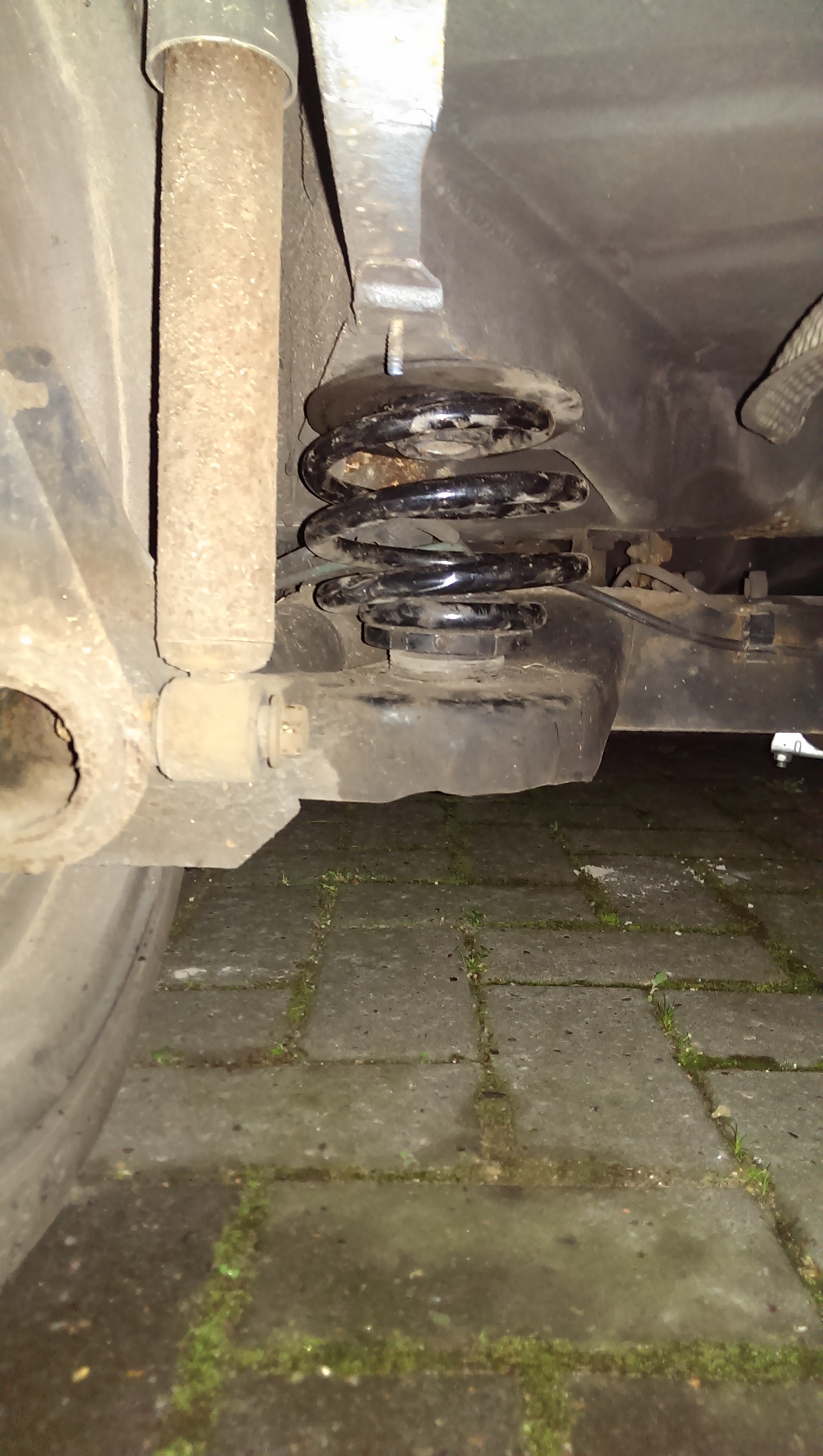

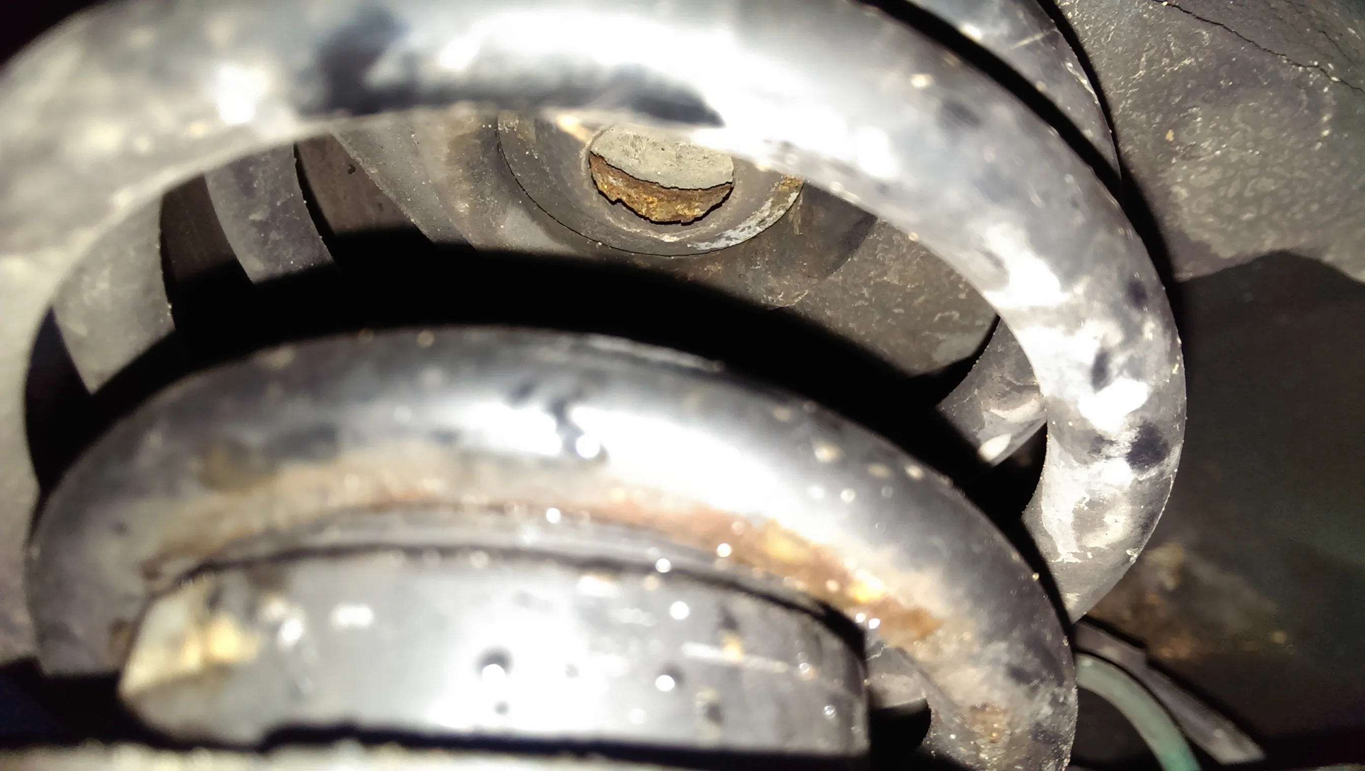

Compared to the drivers side spring which sits flush:
Am I right in thinking that the passenger spring is not sitting right?
Not sure if it was like this before going to the garage, I suspect so as they only adjusted them and the noise hasn't changed.
Any suggestions on how to re-align it if so? Don't want to take a hammer to it and end up damaging it if there is a better way!
Thanks,
Lewis.
Very simple fix, get the new seat and remove the spring to fit.
Plenty of guides on rear suspension removal, should only need the lower damper bolt to be removed though once jacked up.
Ooo ok great thanks, will see if I can find a seat and get it sorted then!

It is simple. Jack up car on rear beam till you can get 2 axle stands under the jacking points on the sills, but keep the jack under the beam, undo lower shock bolts (18mm) and once they are free, lower the jack slowly and the beam will come down, releasing the springs. Put new rubber hat in and reverse what you just did :smile:

Well there is no rubber mount to stop it slipping and I'd imagine the car was up in the air when it was adjusted, so yes. Once on the ground, you'll have the weight compressing it down.
That might explain why they didn't notice anything wrong then, as they did have it up on a four post. Thanks for your advice :)
No worries. Yeah, get one of those rubbers in and you'll be fine again :)

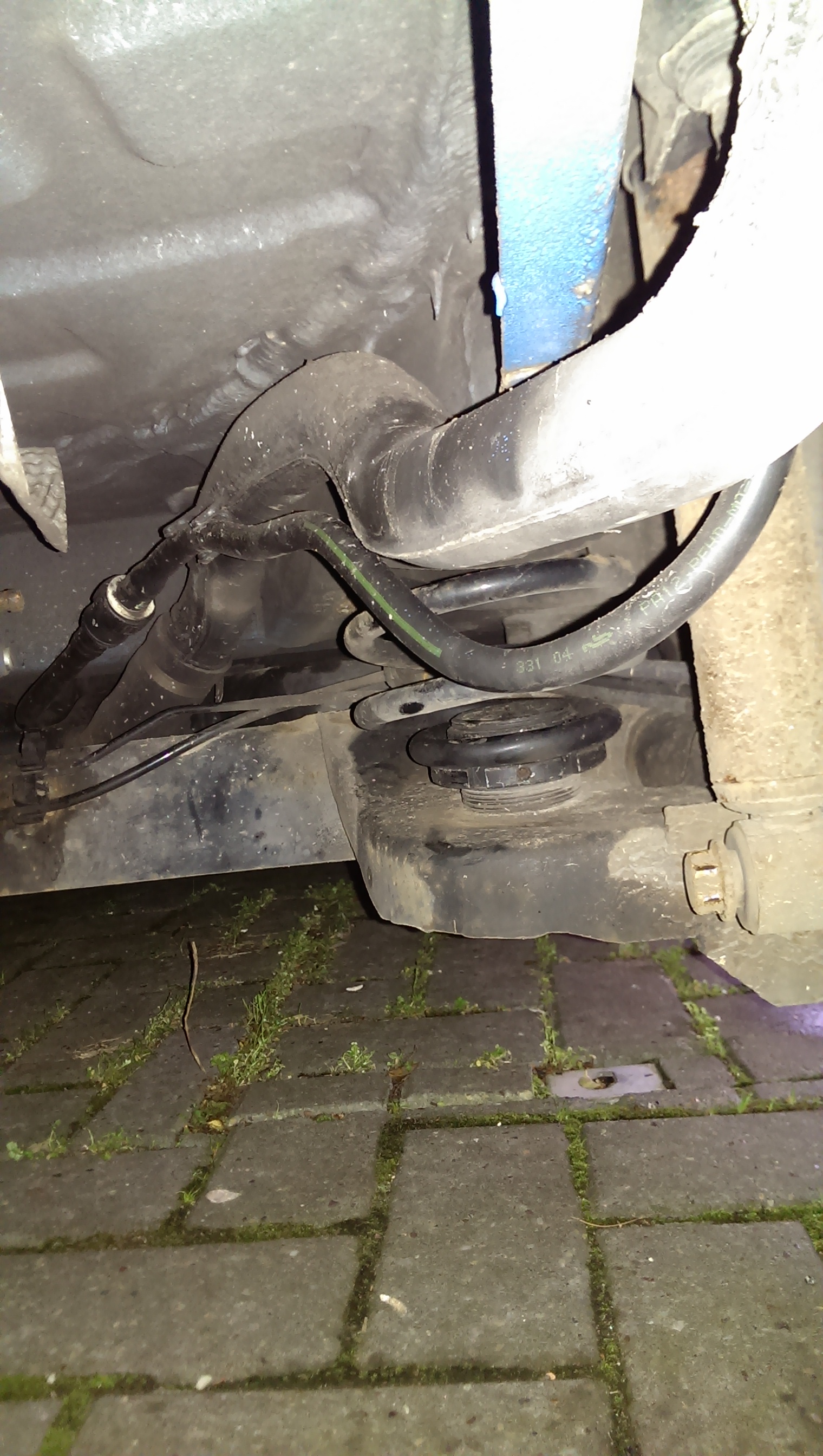

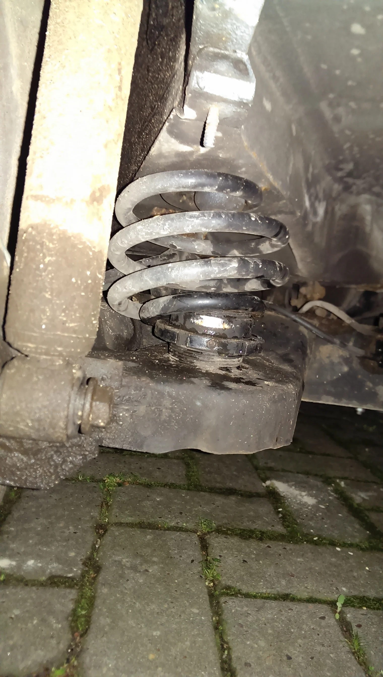

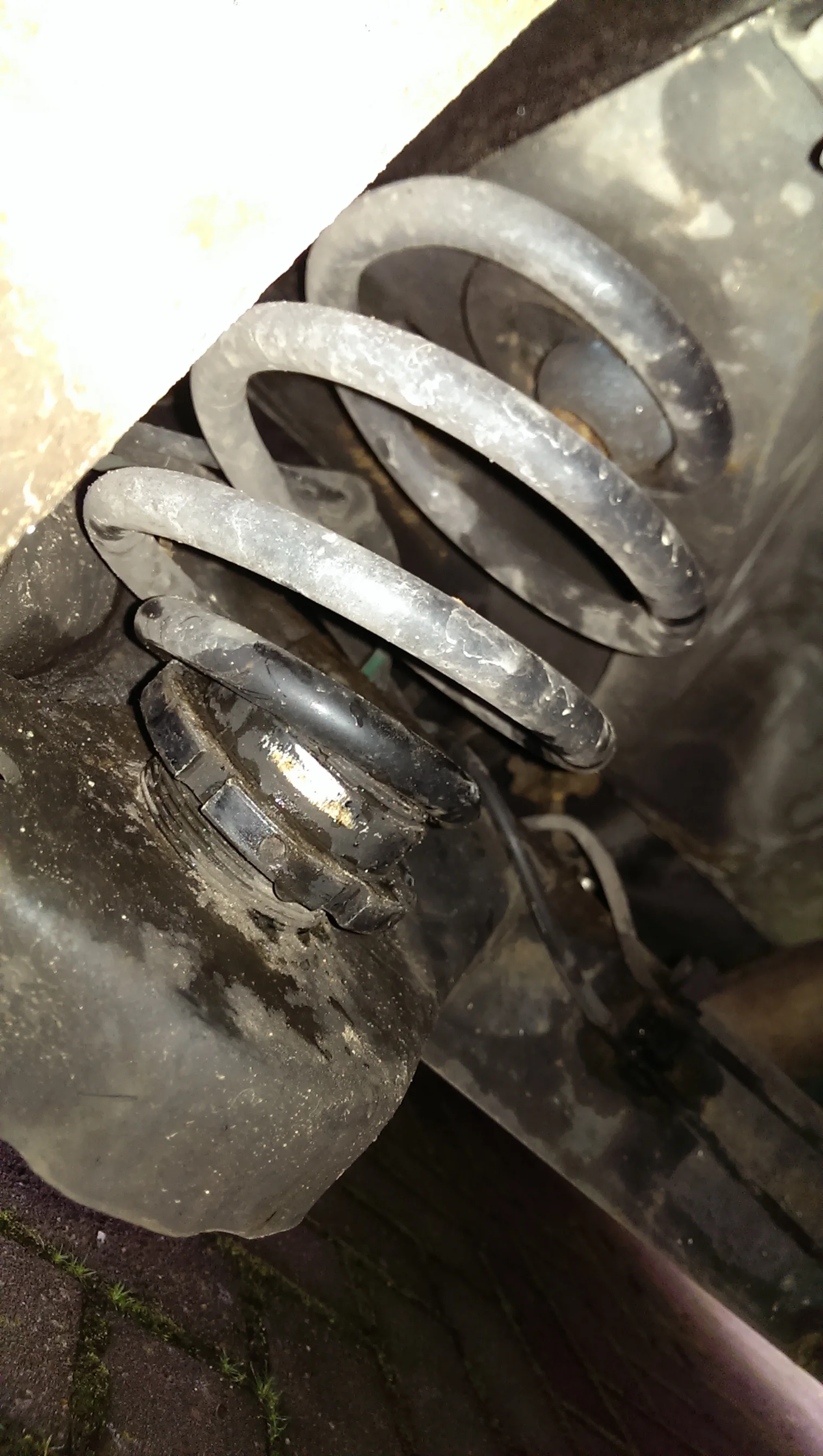

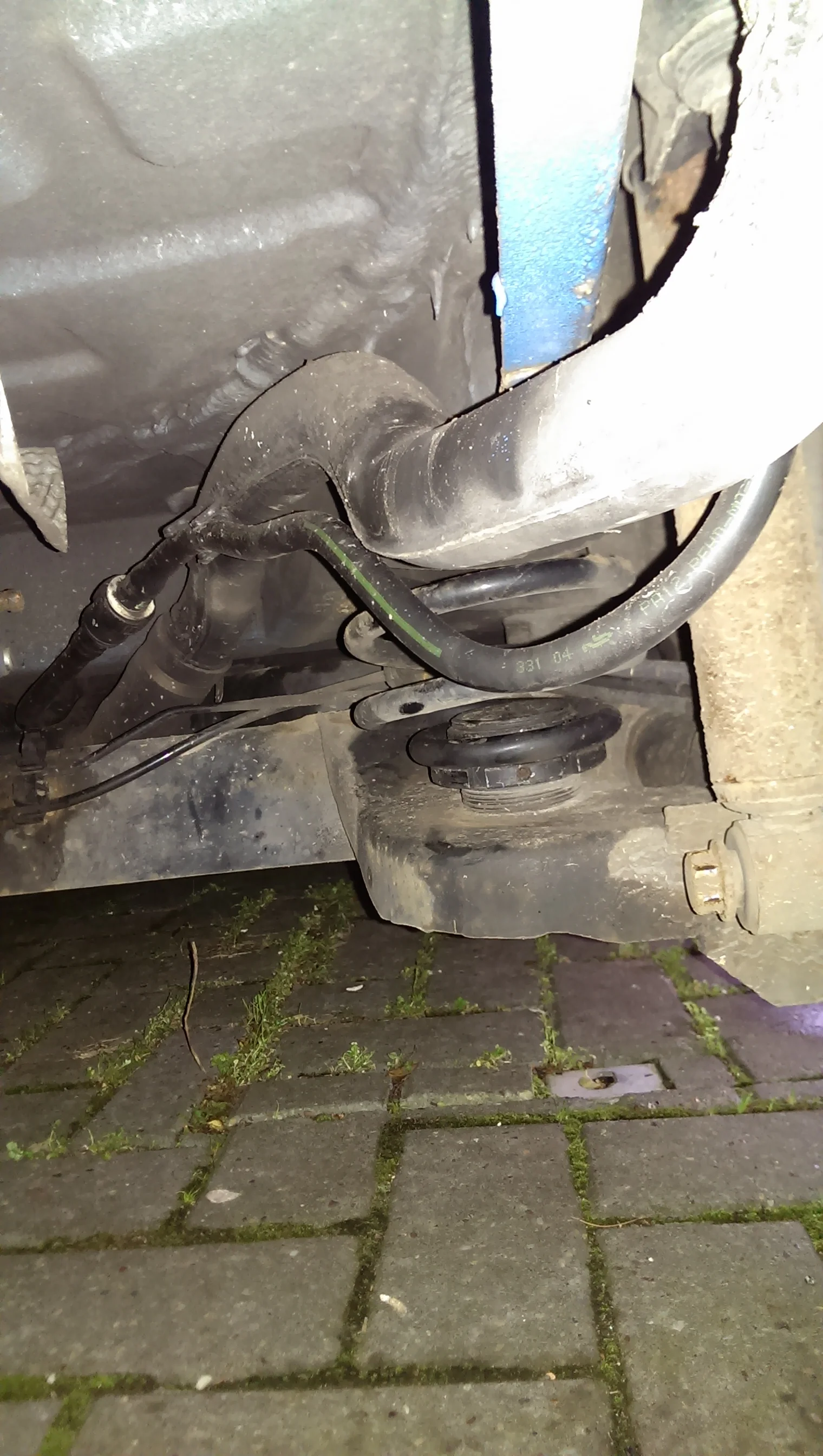

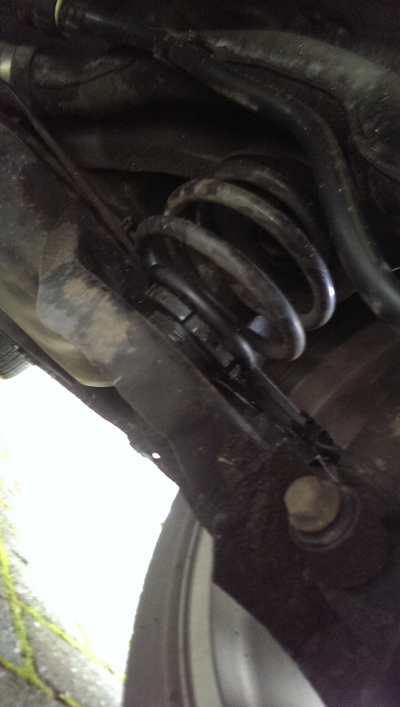

Got this sorted today.
Springs look like they are sitting right now!
Passenger side:
Driver side:
There is still a slight knocking sound, think it is actually coming from the front though.. going to get it up on axle stands tomorrow and poke around at the front to see if I can spot anything there.
But happy that the back is sorted :)
Thanks for all your help/advice guys :smiley:
Glad it's better now mate, sits as it should.
