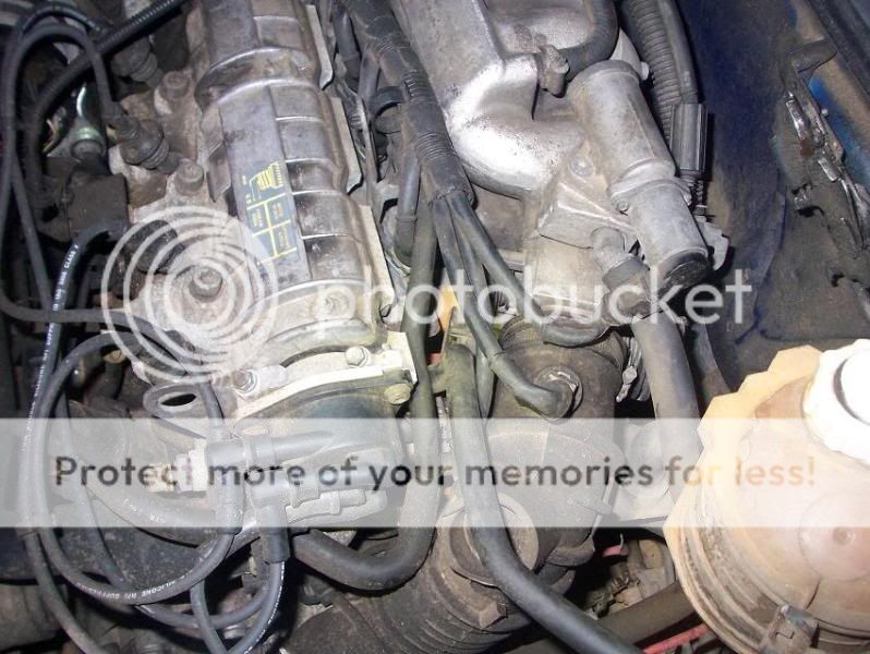

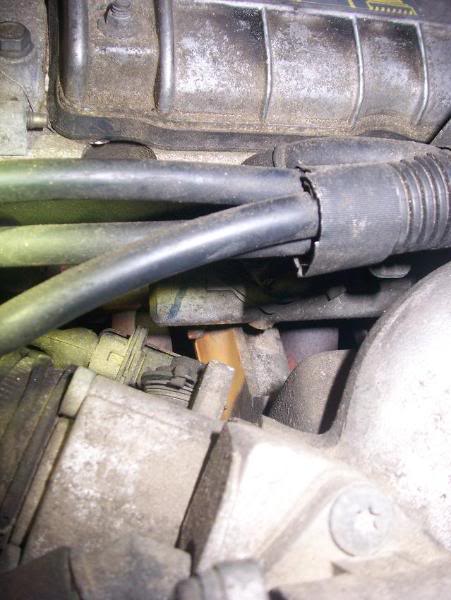

There is proof that water is sprayin out, its ORANGE coloured too?? all over the back of engine, ill got get a pic now if i can

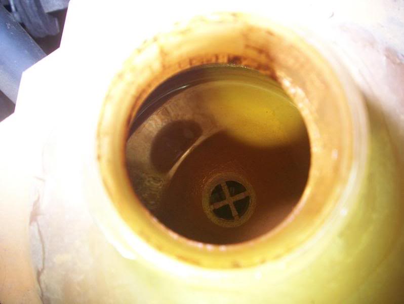

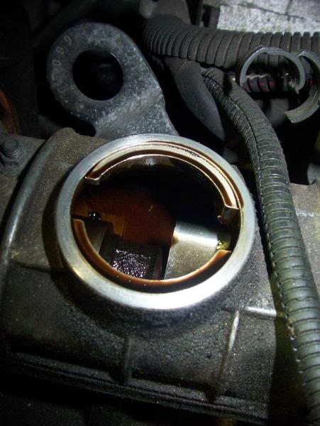

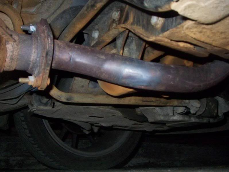

Yes, im loosing water and having to top up, no white smoke out back, the water tank smells oily, ill go get a pic. oh and there is oil leakin too... but ill get pics now n post them :D
PICS...
water drained after 10-15 mins of driving sensibly -
back of engine -
side view of orange water-
under oil cap -
downpipe -
its just got a water leak,, lack of water will cause it to overheat and spit whats left out of whereever it can
just get the leak diagnosed fix it run it up then see how it is

Whats wat i bloody said to the blokes but no they wudnt agree one bit! I dont want to sell my clio i lurv it too much. Will get it looked at mid week :D cheers
U seem to be right, defenatly a water leak so now i need to get a few pipes off and have a look then get that fixed, then pressure test it. I mentioned that it had been pressure tested but it wasnt it was an antifreeze test :S
