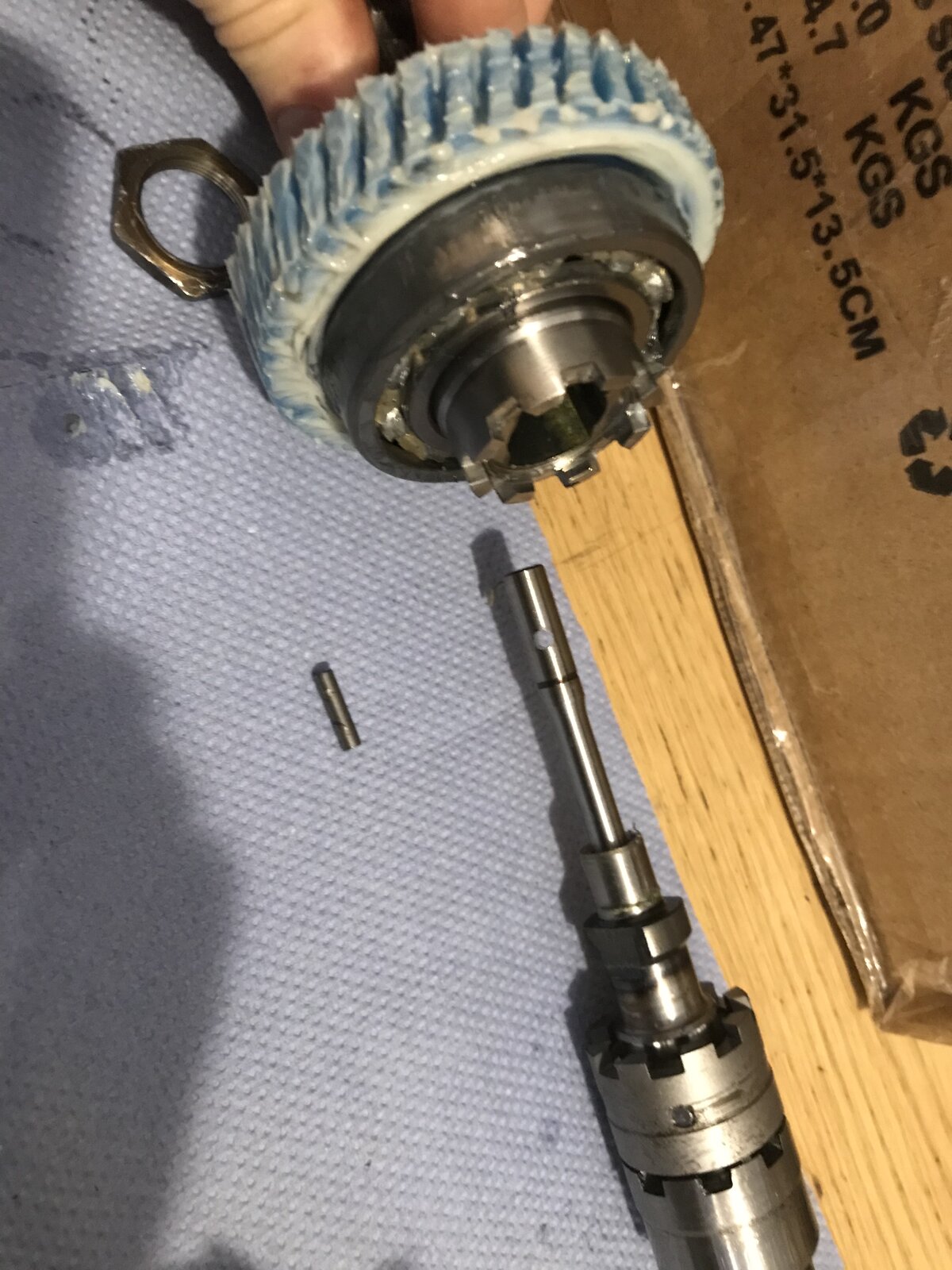

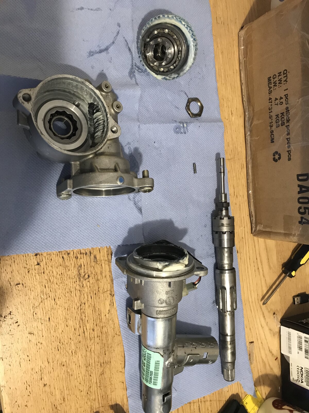

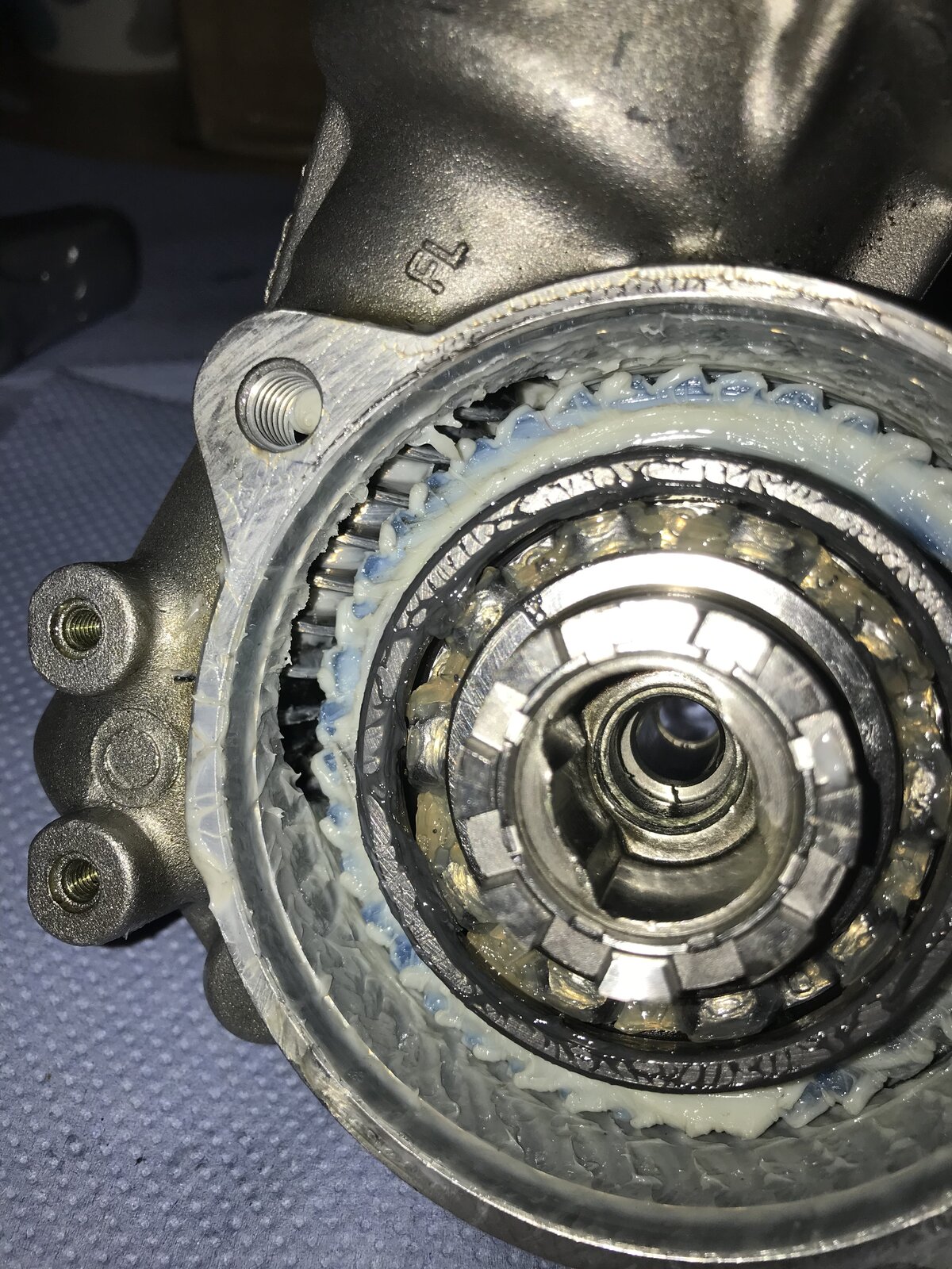

Another socket ordered (41mm) This is for the nut that holds the worm gear in as Im having difficulty putting the column back into the housing, perhaps just a wack but not keen. Will take the worm gear out first then see from there, Im not sure what could be causing the problem, I think the main gear on the column has shifted somehow which is causing a binding on the worm gear, I have no clue what the official names for them are!
Should I get a 197 column so I can have a look inside...:unsure:
Yes please!!! I didn’t have a nerve to disassemble mine [emoji12] wanna see what’s inside!
looks like the bearing and gear are pressed on, no idea. I think Im going to take apart the one on the car to see if theres any other things that look wrong because that one is real noisy.
I watched a video on a modern lexus column with electronic postion adjustments and its a similar concept to this so 197 should be no different.

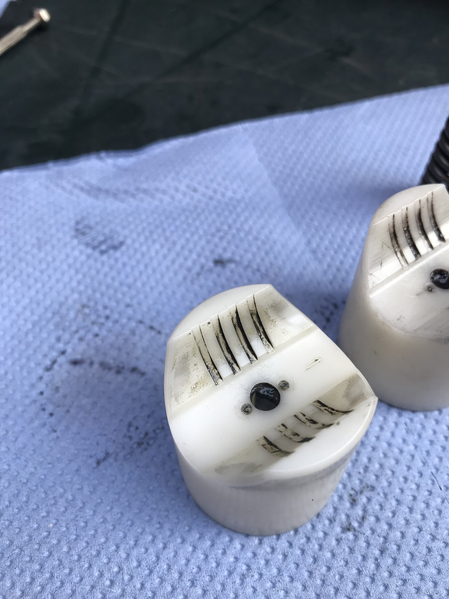

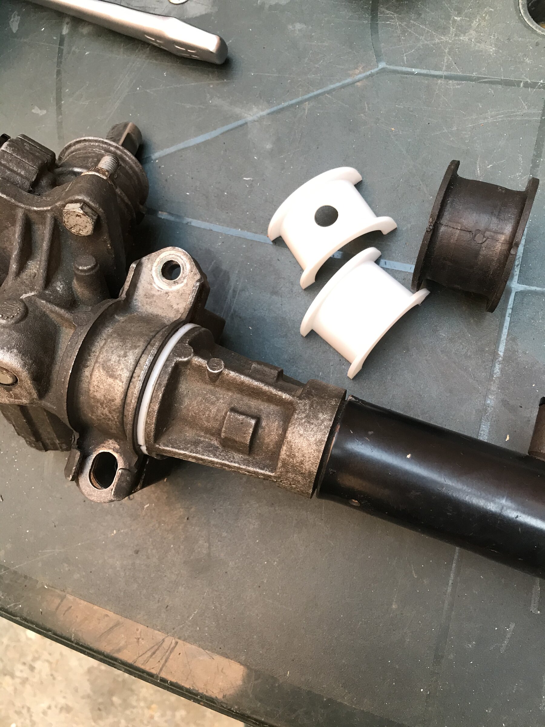

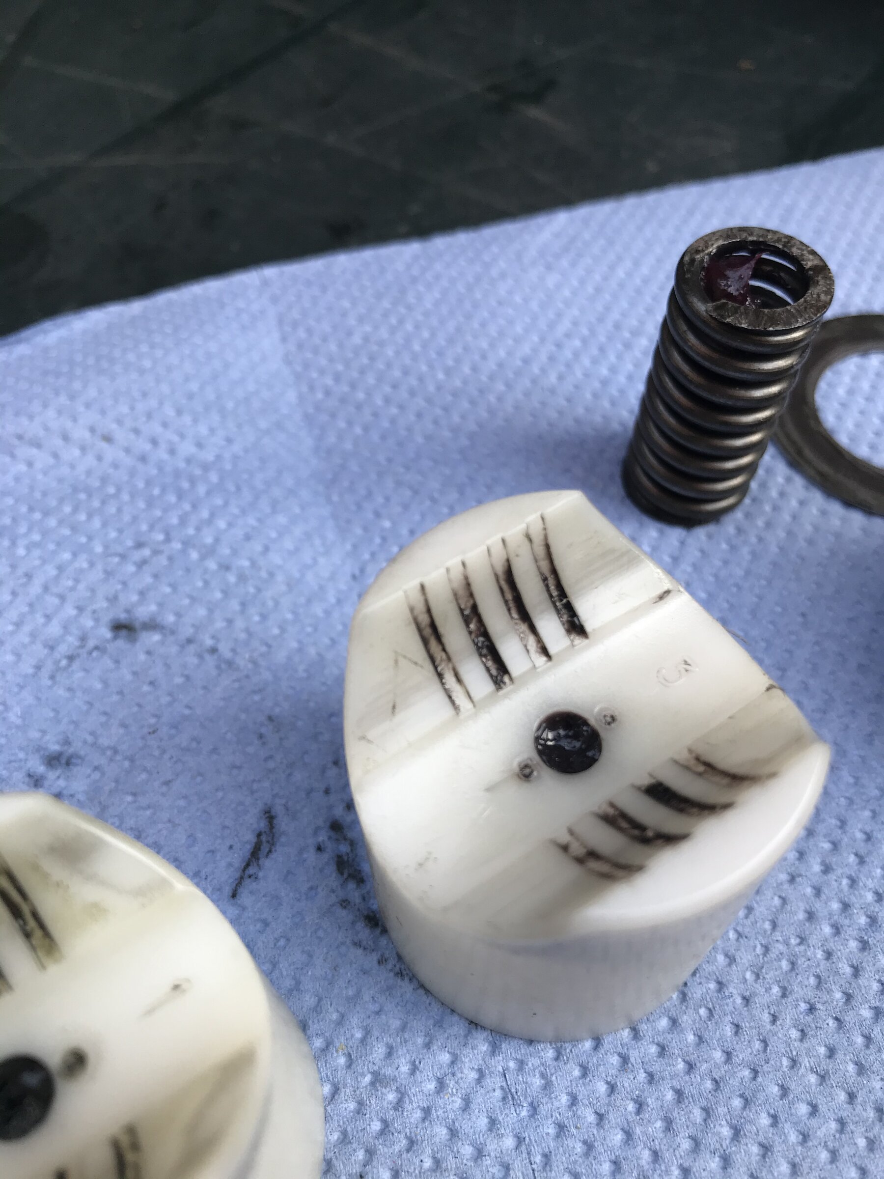

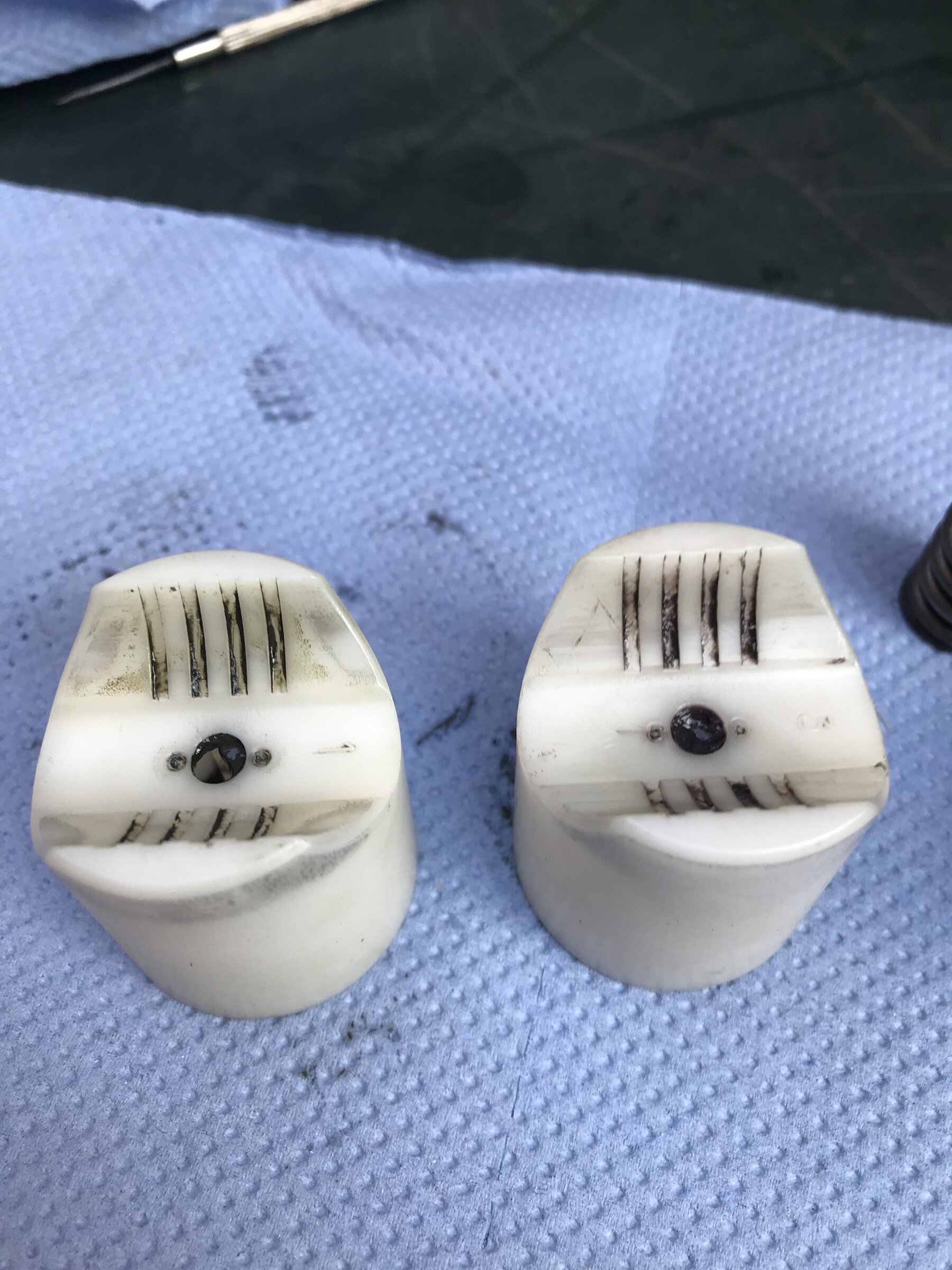

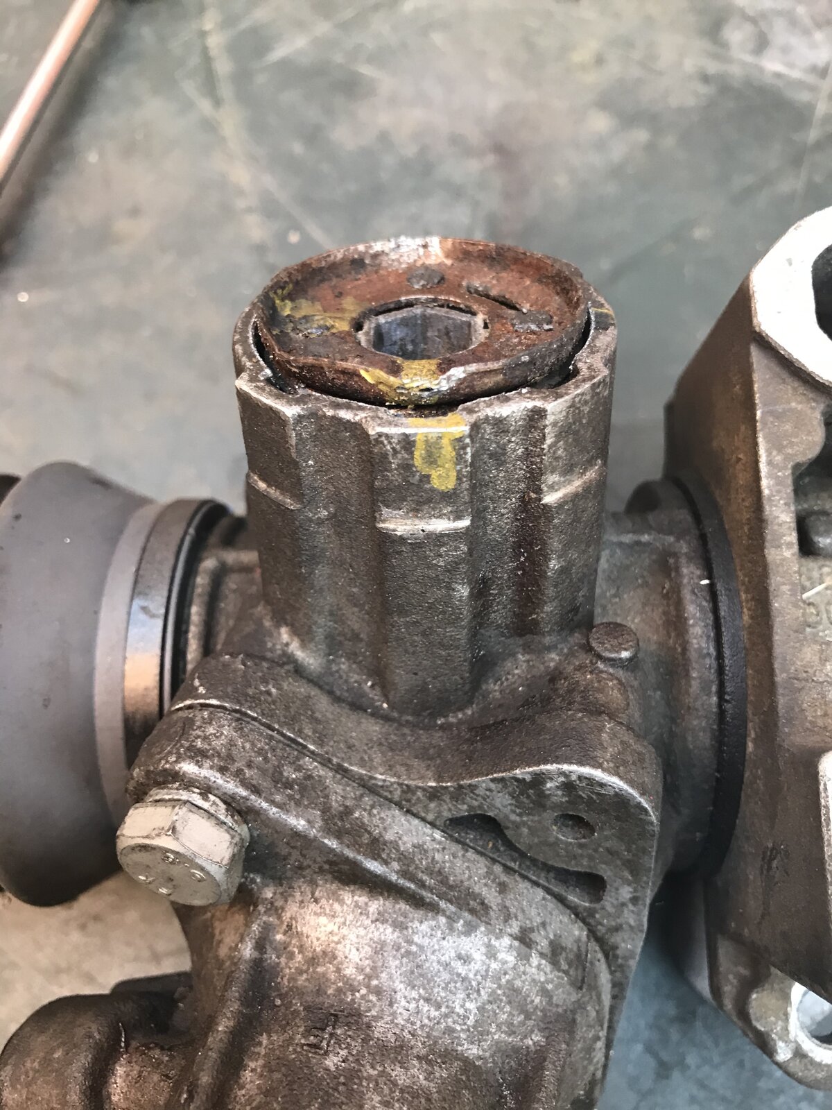

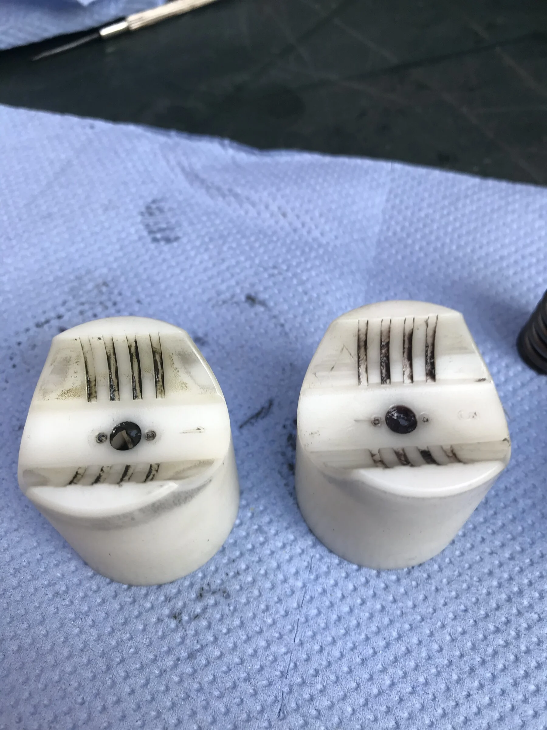

Just put the car back down and the steering is more consistent so there is a result so far, I didnt leave the pre load like in the picture, I done it up a bit more but I was checking the resistance of the rack a lot in different pre loads. Rack is moving slightly and I think that could be the clunks so have ordered the solid bushes, hopefully this rules out that the rack internals are fine also and the pre load is done up enough. Its not the actual column, I took it apart and its solid, what I did find was that the other green sticker column where I said was harder to turn is actually of 'better' health than the blue one, as the blue one does have some wear in the gears so on centre is slightly less resistance than when turned. I dont see how the green one should be like that or any epas column for that matter as that unnecessary extra resistance is taking away power from the motor. Its not an efficient system, the actual internals of the column flex under moderate load as well.
Getting there though, first time doing this work so dont know what to expect but Im eager to know how it works, Ive made a couple mistakes but ultimately the mistakes of the racks that were not my fault has forced me to learn new skills.
Fit the solid rack bushes and also tightened up the pre load as to rule out that I hadn’t loosened it too much. Still play and clunks. That’s play in the rack, the bushes have made the rack not move at all
What am I’m doing wrong? The rack goes on in one position only, I drive very considerate to the car, when there are ruts or pot holes I’m very light on the steering, I never force the wheel. When I put all together it’s free moving, uj turns okay. 😕
Put the rack back together with the piston or whatever its called on the left, adjusted the pre load until there was no twisting of the rack. Put everything back on the car and couldnt wait until tomorrow to try it out so just got it off the stands and so far......... Its the smoothest its ever turned, the clunking has gone and it turns fairly linear so doesnt lose loads of assistance when turning certain ways, fairly linear as there is still a bit but its much better. Will try it out up and down and the street tomorrow. You could say it wasnt the piston but the pre load, but as seen earlier in this thread, how easy it was to turn. Why would these manual racks be way harder to turn than normal? Is it because of the grease and not pas fluid?
